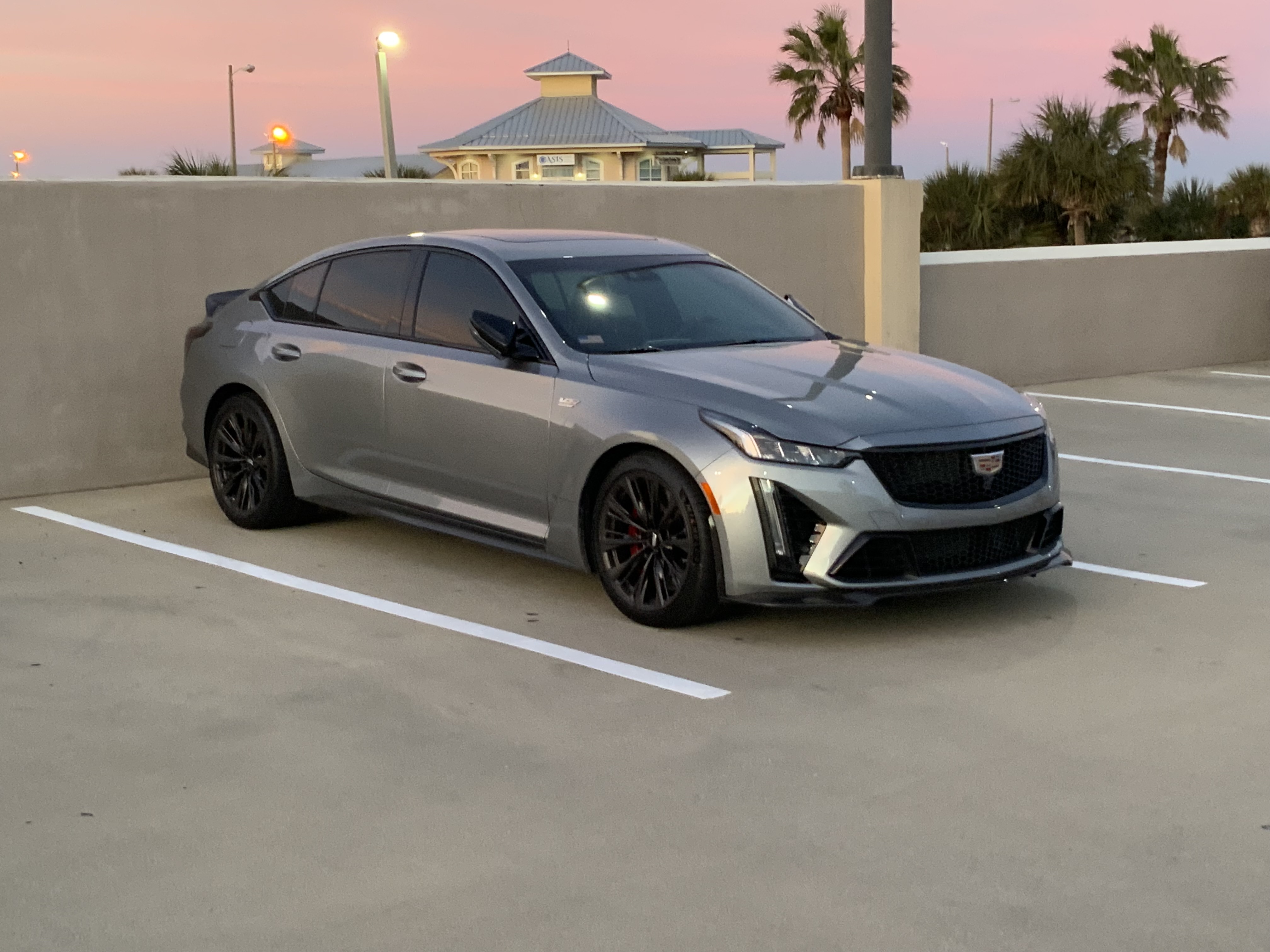

Well some of you know we have 22 5 BW A10 which has been flawless, 2+ years ago placed order with Sewell Dallas last week picked up car 6 sp full carbon ( 22 had to drop carbon) held hostage by Mother Nature 9 degrees 2/3 inches snow in Texas is blizzard 🌨️ conditions for them! Whole place shut down. Got out headed South East to Baton Rouge trying to outrun cold, white knuckles drive roads ice covered roads wrecks everywhere nightmare, somehow got there. Still cold next day ran to New Orleans spent 1/2 day again cold had lunch decided not our liking hit the road. Ran hard to Pensacola beach weather starting to come around, laid up 2 days.Car at 700 miles seems ok, wife says not quicker than 22. Onward to Ocala starting to put down the hammer only seeing 9 pds boost (11 pds on 22 A10) Today down to Marco Island almost 1600 will change oil Monday, must say these people down here run hard 90/100! Laying up couple days. I’m going to reserve judgement of manual over A10 till we get home. Trip continues next week. Just thought I’d share, Sorry for long post!

Well some of you know we have 22 5 BW A10 which has been flawless, 2+ years ago placed order with Sewell Dallas last week picked up car 6 sp full carbon ( 22 had to drop carbon) held hostage by Mother Nature 9 degrees 2/3 inches snow in Texas is blizzard 🌨️ conditions for them! Whole place shut down. Got out headed South East to Baton Rouge trying to outrun cold, white knuckles drive roads ice covered roads wrecks everywhere nightmare, somehow got there. Still cold next day ran to New Orleans spent 1/2 day again cold had lunch decided not our liking hit the road. Ran hard to Pensacola beach weather starting to come around, laid up 2 days.Car at 700 miles seems ok, wife says not quicker than 22. Onward to Ocala starting to put down the hammer only seeing 9 pds boost (11 pds on 22 A10) Today down to Marco Island almost 1600 will change oil Monday, must say these people down here run hard 90/100! Laying up couple days. I’m going to reserve judgement of manual over A10 till we get home. Trip continues next week. Just thought I’d share, Sorry for long post!View attachment 23754

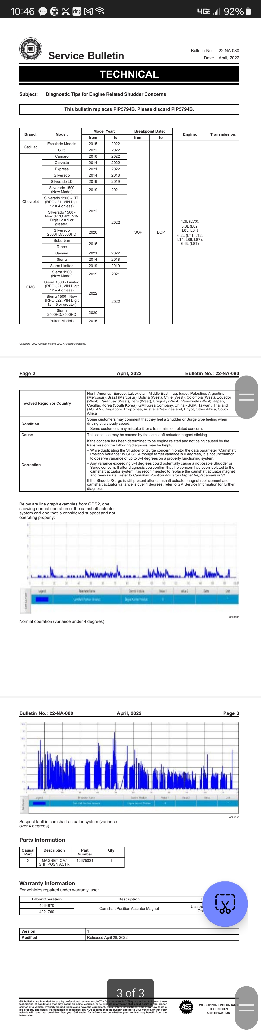

Onward Marco Island across gator alley Miami up to Delray Beach, seems to develop miss 6 gear low rpm 2000+/- on acceleration could be bad gas? Also have hum/buzz/drone on deceleration 5/6 gear only between 80/50 mp! thought it might be the exhaust changing modes does not make a difference. Anybody else have this? Lay up for couple days.

Delray Beach to Charleston Place, Charleston SC. Still have what I call miss 6 gear 80 mph 2000 RPM on acceleration should be smooth clears up after 4000 RPM. No good in my humble opinion. Definitely not bad gas, ran too much through it. O well they’ll figure it out. Couple days here then mad dash home try to beat weather! one more thing the manual is definitely not good on fuel mileage averaging 17 versus A10 will get 18/20( same idiot driver) and much quieter cruising

Thanks for the update... btw, any chance there is the camshaft actuator position magnet sticking like in some 22's? If you read towards the bottom it can feel like a transmission issue... and I remember in the forums people mentioning that it was occurring at lower rpms.
I attached the old 2022 service bulletin.
