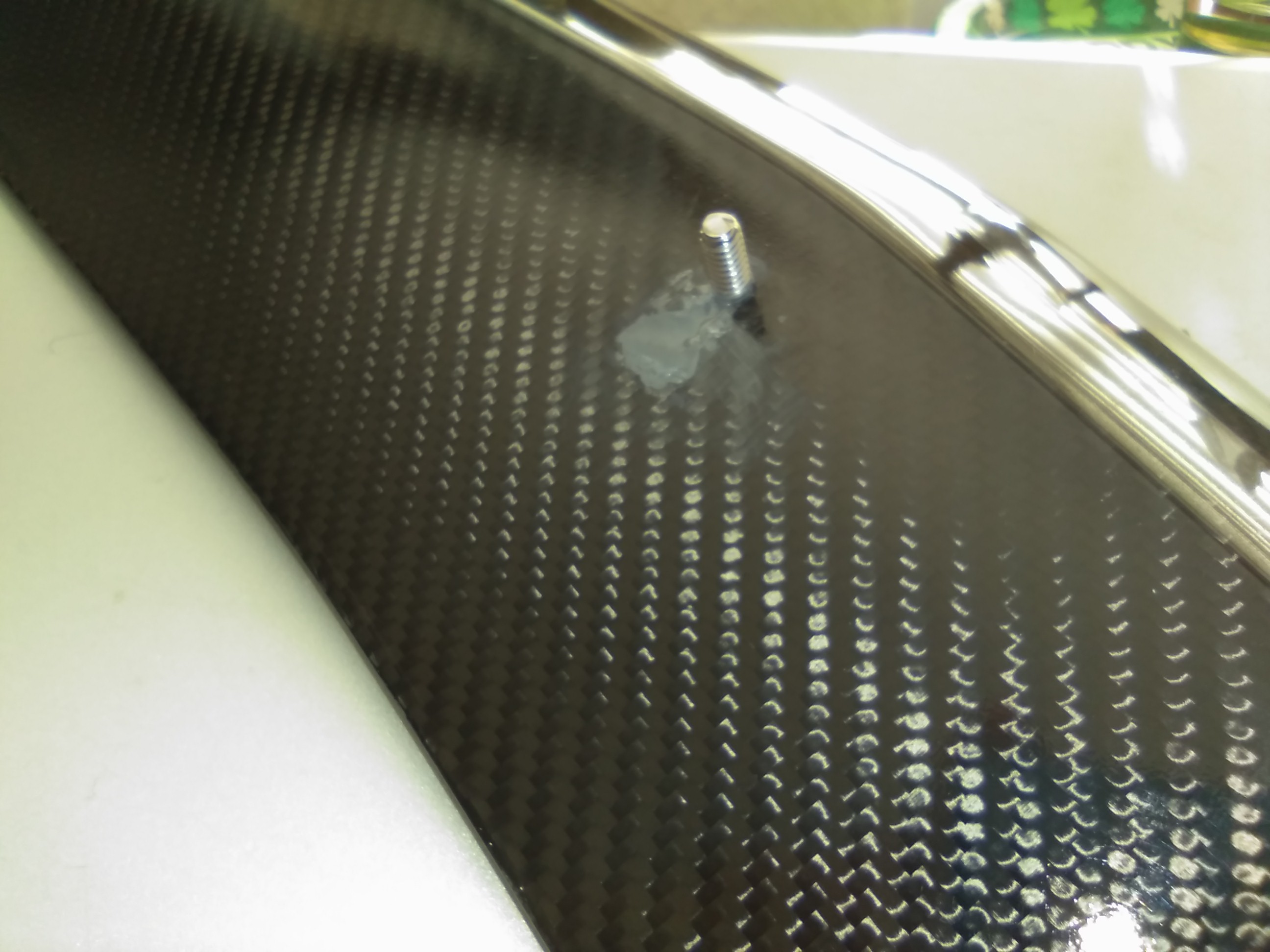

The spoiler I installed also was only to be held on with the tape. That was a no go for me so I mounted 4 stainless bolts on the underside, epoxied them in and bolted it down using factory holes. Been solid with no issues, and eventually I'll get a better spoiler.

The spoiler I installed also was only to be held on with the tape. That was a no go for me so I mounted 4 stainless bolts on the underside, epoxied them in and bolted it down using factory holes. Been solid with no issues, and eventually I'll get a better spoiler.View attachment 23179
Nice! That's a good call. Bolts running down from wing to trunk is probably easier than rivnuts in the bottom of the wing and bolts running up from trunk to wing.
The holes in my wing are very small... Did you have to drill out the placements for the bolts you added? If so, I'm thinking a step bit to nearly match the size of the bolt head.
From there, any tips on how to get the bolt head situated flush and secure with epoxy? Did you did just kinda slather it all in there?
I put painters tape under the spoiler, placed it on the trunk lid and marked where the factory trunk holes were. Then I drilled holes big enough for the bolts heads slightly off to the side of the marked location and cut/slotted a hole over to them only the diameter/width of the bolt threads(like a keyhole). I could then insert the bolt head into the spoiler, slide it over and that is when I added the epoxy to fill the larger offset hole. I also made sure some epoxy was inside around the bolt head. I used stainless bolts, stainless washers, and stainless nylon lock nuts to finally bolt it down. I also used better 3M double-sided mounting tape than what came with my spoiler.
