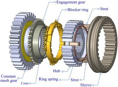

The 1-2 shift technique is hard to perfect, partially because the 1-2 shift is the first "real" shift you do with the car in motion. When you're accelerating hard, the 1-2 shift is the hardest to perform properly, because you're being thrown backwards and forwards by the G-forces while concentrating on driving.
The GM hydraulic system specs provide very little margin between the amount of fluid volume that a 3/4" diameter master cylinder can provide at full travel, and the amount of fluid that the slave cylinder requires to fully disengage the clutch. That's why all my V's get 13/16" masters, which move more volume at the cost of higher pedal effort. Not only can I be sloppier in my clutch pedal, I can go longer periods of time between bleeding.
Secondly, better transmission fluid can improve the effectiveness of the synchros, allowing you to shift faster. But if you fail to get the pedal down, even with better fluid, you're still going to feel the crunch, because the crunch is caused by slamming the sleeve into the blocker ring / engagement teeth (see figure below) while one side is still being driven.
In the linked video, I skipped to the point where the sleeve engages with the blocker, which exerts force on the synchro. If the amount of force is excessive, you perceive the shift as "notchy." If you forcefully ram the gears together despite this resistance, it's called "crunchy" because you just forced the tips of the teeth together.
