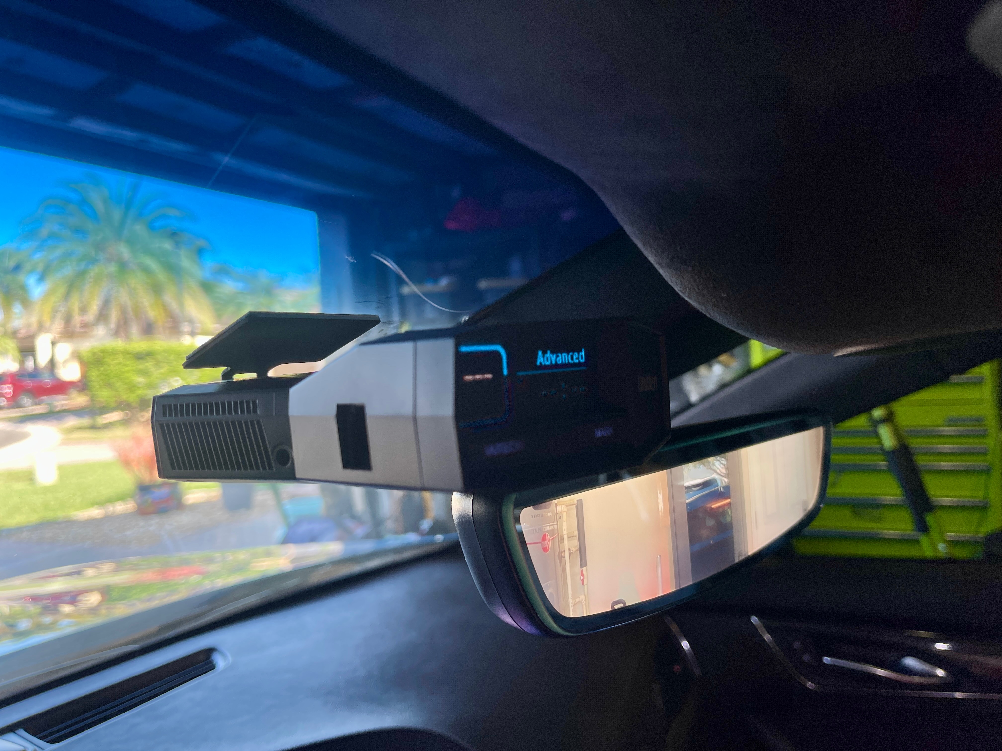

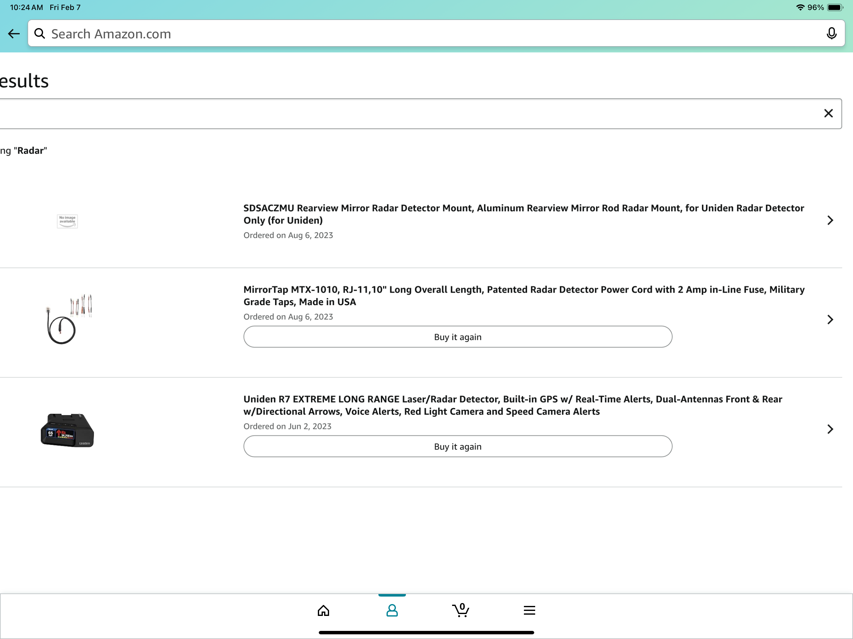

Here’s exactly what I bought. It’s a VERY clean install, and I’m still extremely happy with it. Loctite the screws that hold the mount on.
