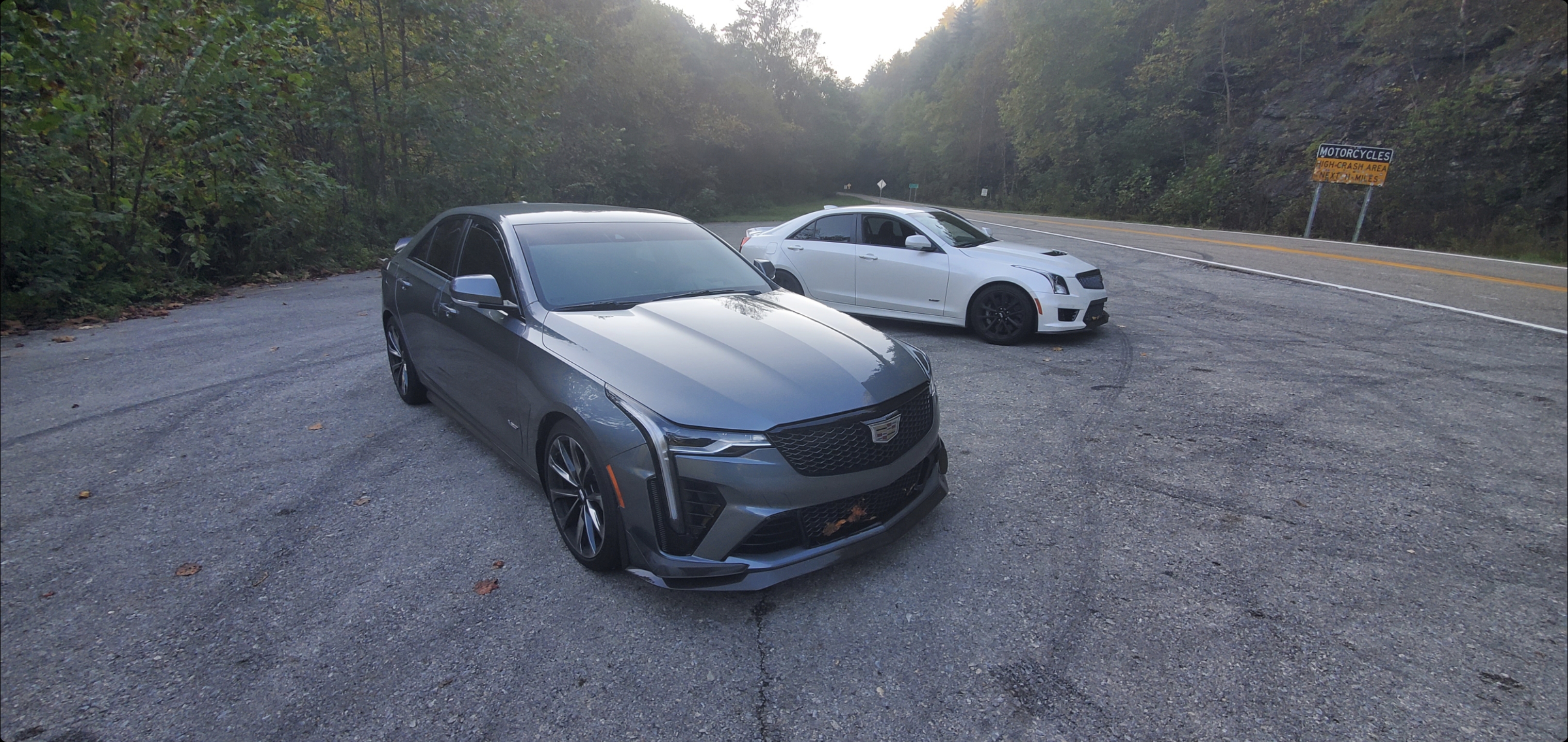

Went to the Tail of the Dragon with a group of friends. Been going since 2009. Put over 1,100 miles on my CT4. I have to say, the A10 is one of the biggest differences between my ATS-V with the A8 and this car. Made a huge difference. Shifts are incredibly quick. Also, the Noises the exhaust makes at upshifts and when letting off throttle.....the pops and bangs. Fanfreakingtastic.
Only real complaint, I think I preferred the recaros in the ATS more than the top level seats in the CT4.
