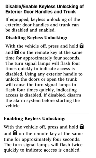

According to the manual, you can disable and re-enable keyless entry by holding the lock and unlock buttons on the key fob for four seconds. If this actually disables the RF transmission capabilities to unlock the doors and trunk, this should defeat those capabilities in relay attack, at least insofar as a thief being able to unlock the doors and trunk. What I don't know is whether the capabilities of the thieves may be advanced enough such that they can re-enable keyless unlock with their equipment as if they are actually holding lock + unlock on the fob for four seconds.

Interestingly, manufacturers treat re-enabling differently. Here's a small sample size, Cadillac and Toyota, the only two vehicles I've personally owned with the passive "keyless unlocking." I did some experimentation.
Cadillac leave this disabled until you press and hold lock and unlock for four seconds (same procedure flips the setting back). You'll have to press unlock on the fob every time you want to get in the car. By the way, automatic locking (as you walk away) is a separate setting and is still enabled if you separately set it that way.
Toyota automatically re-enable keyless unlocking the first time you press unlock on the key fob. Basically, once you open the car with the fob, it's back to keyless unlocking. You have to disable the keyless unlocking every time. I'll typically only do that if I know I'm going to park the car for a period of time. But with Cadillac, I don't have to, that setting is remembered.
