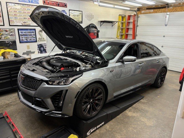

The race ramps really make changing the oil easy.
Awesome, which size Race Ramps did you buy?
I believe the part number for the two piece ramps is Item: RR-XT-2, and the extensions part number is Item: RR-EX-14 (Race Ramp Web site).
They are obviously not cheap ramps but they make getting under your car to change the oil much easier.

Dumb question. Being at that angle, does it allow for complete oil drainage?
A couple of videos I've watched suggest pouring an extra quart of oil through the engine once you've drained it to flush out as much old oil as possible, so that might help while using the ramps. It's probably overkill to some extent, but I'll probably do it because I plan on having this car for a long time.
Hey, there are no dumb questions😀.
Because the drain plug is on the side of the oil pan, and not on the back of the pan, I would assume there is a little oil left in the pan.

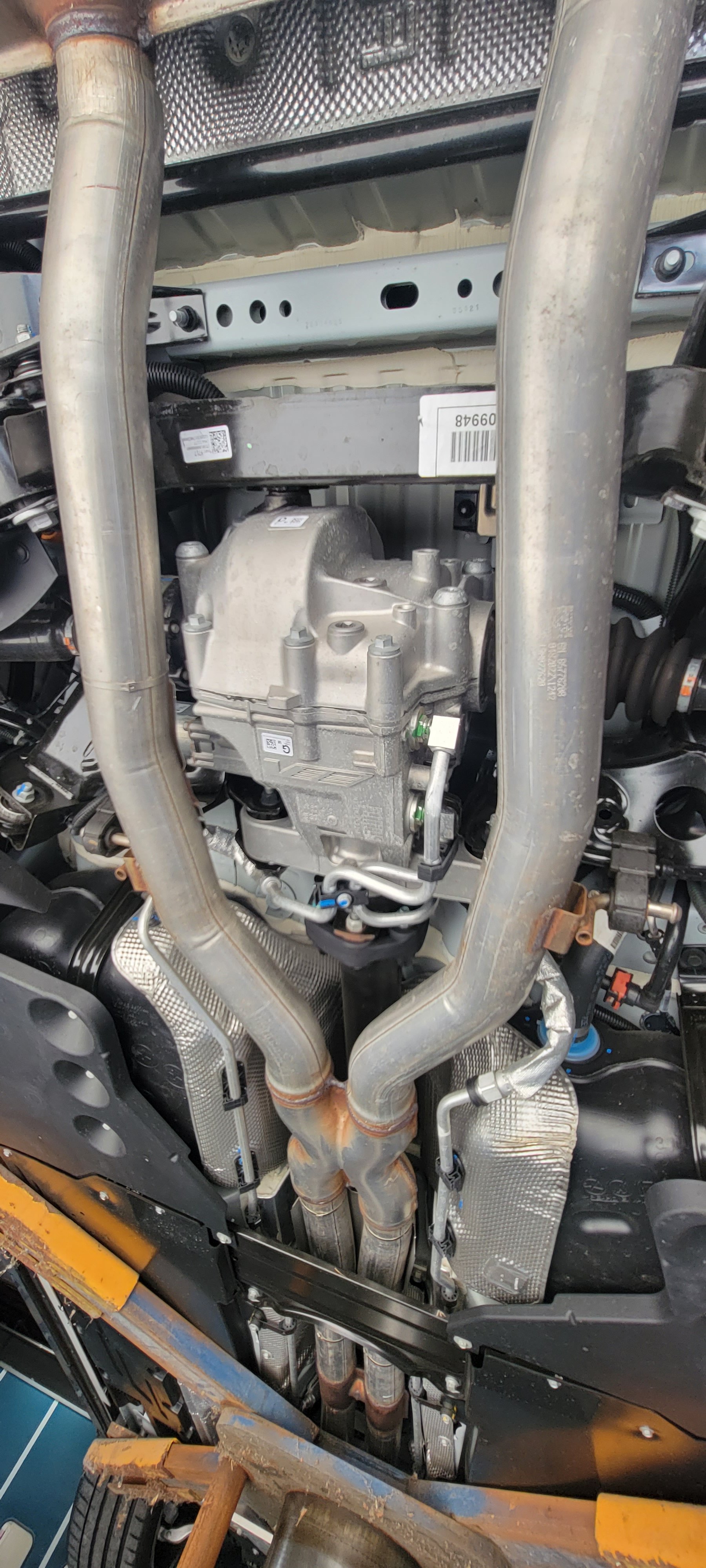

I am happy that they did not put a huge plastic belly pan with 20 screws, to remove. Easy access to everything.

When the plug is on an angle or side, I slightly jack the opposite side to help it drain. OCD stuff, LOL.
Do you absolutely need the RR-EX14 extenders. Race Ramp calculator doesn't indicate that they are necessary on a 5BW. What is your opinion? Thanks
No you do not. Just make sure you get the long ramps.
I bought the race ramps years ago when I had a different vehicle and I needed the extenders. So I use them for the 5BW since I have them.
I have not tried the ramps with out the extenders. If the Race Ramp calculator indicates you don't need them, then you probably don't.
Thanks
I too use ramps to change the oil, and since the plug is near the rear, I don't sweat the 1.8 ounces that may be remaining in the pan. However, I have been known to jack up the other side of the car to help let that last little bit drain out...

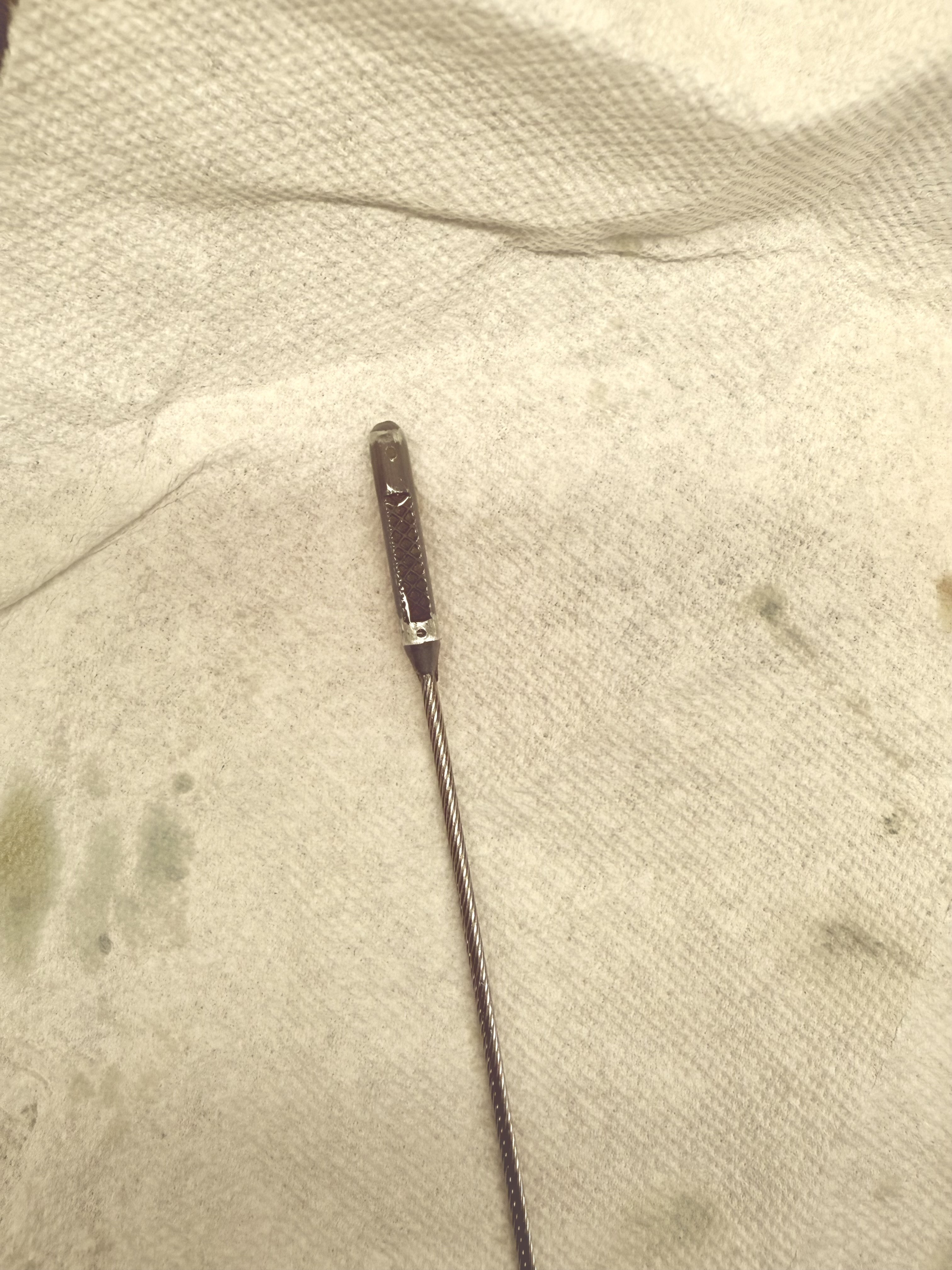

OK, so I'm probably being a dip-stick about this but I have a question about our dip-stick. This is for checking a dealer performed oil change for potential overfill.
With apologies for the lighting on the picture... the oil is right up to the top of the crosshatch. Seems good... full. There's no MAX line though, it just tapers off immediately.
I can wipe off what seems like a little bit of oil above the crosshatch and on the dip stick itself, but that could be just from the process of measuring it. I do wipe it clean before taking a measurement and I don't point it straight up in the air. So, how do I tell if I'm over full :)
As an aside I can smell a bit of oil in the cabin when starting up the car but I might just be getting overly neurotic about it. 52PSI oil pressure at idle on the cold start.
I'd just check it while hot and manage the level so it's at the top of the measuring area first. After that, unless your detecting oil leaks, just wait for the add oil indicator and repeat.
There is no way I would wait until the idiot light comes on before checking and adding oil. I think GM recommends checking it at least monthly with the stick, and there are some who check it at every gas fill-up. I’m in the ‘at least monthly’ camp, and that’s only after more frequent checks until I get comfortable with an engine’s normal consumption habits. Waiting for the light to come on is asking for trouble IMO.
Nobody w a BW needs to view an idiot light. You can and should have both oil pressure and oil temperature on your dash. I believe both are in the Sport or Track instrument mode.
Sorry guys, I probably wasn't too clear in my question.
It's my understanding that an overfill is also not great for the engine and am asking a dumb question about how to read that on our dipstick since there seems to be no way of reading above 'full'.
Agree with earlier poster it's wise to check the level manually on at least a monthly basis and top it off before the DIC gives the low oil warning,
