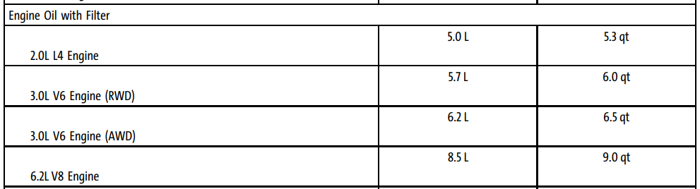

Sounds good, thanks for the advice. So it’s 10 quarts correct?

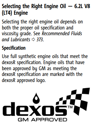

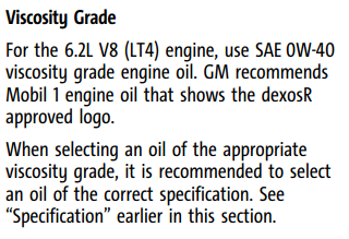

From the 2024 CT5 Manual (9 quarts with filter, dexos R):

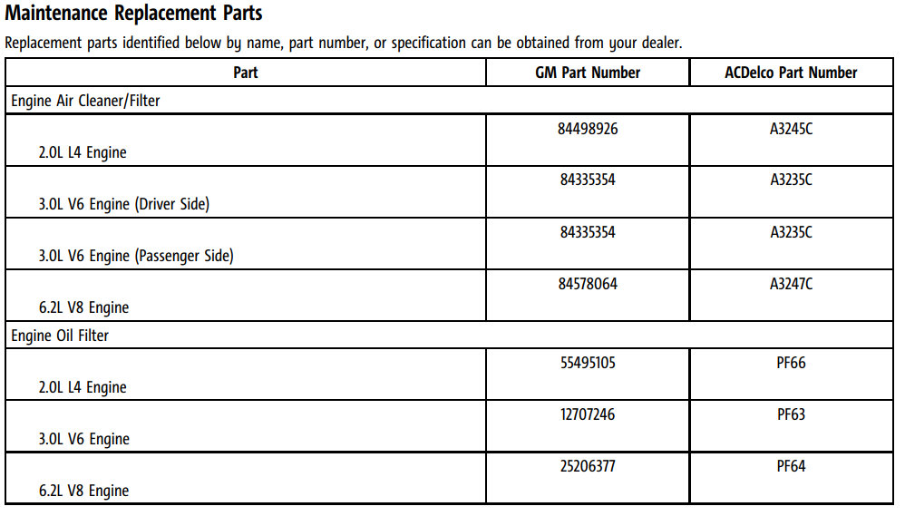

Filter:

I bought the Dexos R 0-40 mobil one Supercar on Amazon. 6 quart cases. PF64 is the filter. I use AC Delco for warranty.

I have a lot of reasons for doing my own oil changes, and one of them is preventing an overfilled condition. Back when I was getting dealer service on various cars, 100% success rate of them overfilling. I would suggest not using 10qts, rather put in 9 and let it sit overnight on level ground and check in the morning.

Get an angled funnel for filling. Mine always took 10 to get the dipstick to read in the middle, but I did drain that sucker for half the day.

And it's easier to add one quart than to remove one quart, so put in 9, run the car, check the level, and add as needed, if needed.

Now that’s some real OCD. I get the engine hot, drain, wait about 1 hour and finish the job. By that time it’s an intermittent drip, good enough. Then it takes 9 quarts.
