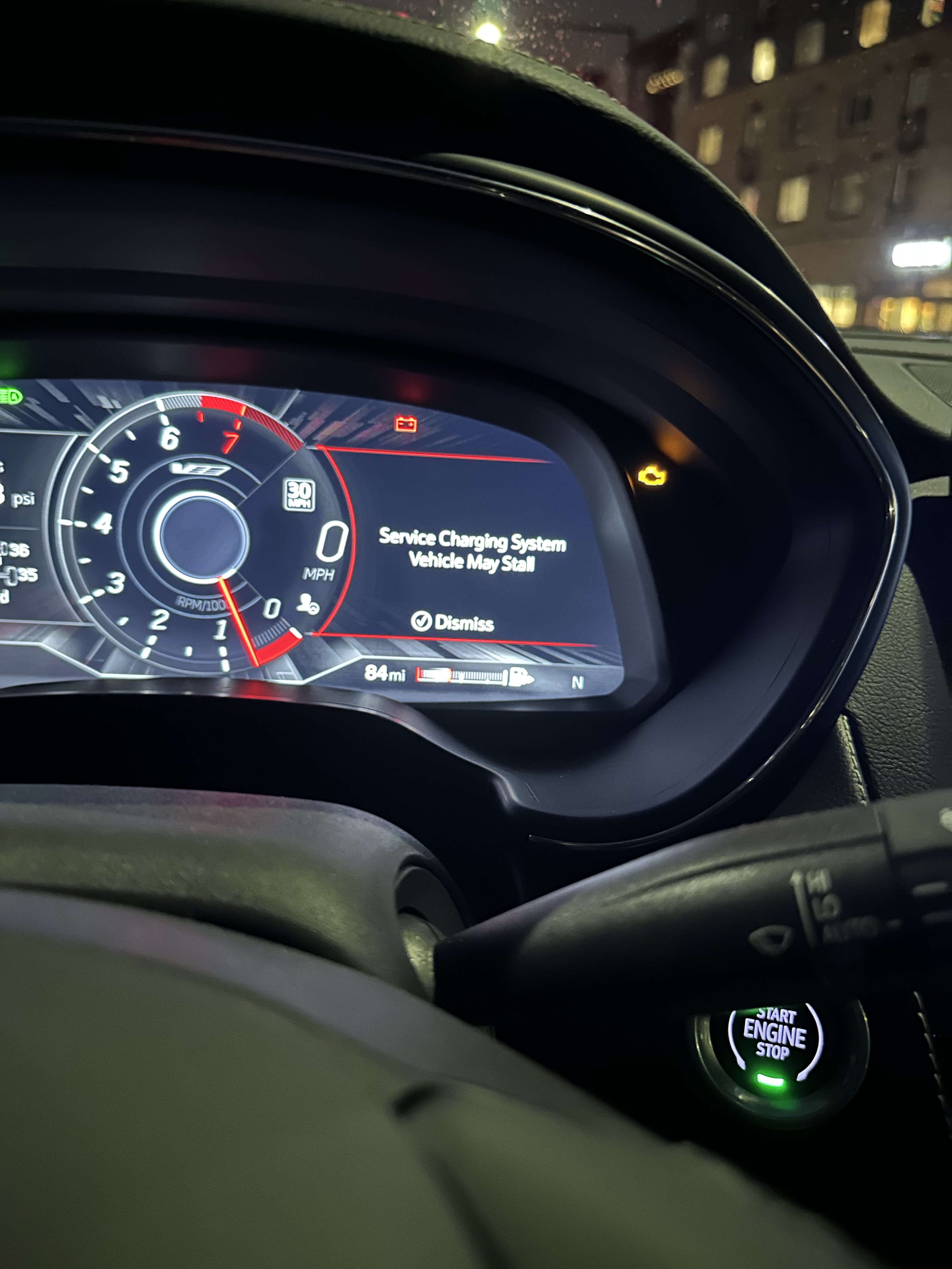

Of course the next month after having my engine replaced I now have a service charging system malfunction stating the vehicle may stall. It is colder than usual out here but still. I need some help here. Tried disconnecting the battery and reconnecting it, dropped to 10v upon restart and then went back to 11.3. Under load it seems to go up to 11.4

Anyone got any recommendations or should I just get it towed back to the dealership tonight.
If you are not seeing upwards of 13-14v after starting, you need to take it in for service. The battery is going to discharge.
Take it in.
They probably forgot a connector or a ground connection.
Yeah, its running on battery power. If you have a multimeter, you can check actual voltage at the battery when the car is running and other power points in the engine bay. If you can get access to the alternator post, that would be the best way to verify if the alternator is working or not.
The battery quite simply won’t go past 11.3-4 volts. Had it on a jump box trying to push more power to it. I think it may just be toast. Gonna have a new battery put in it tomorrow. If that doesn’t fix it then I guess I’m carless for the holidays.
Well if the alternator isnt charging, you're not gonna see it go pass 12v. Get the battery tested first since thats probably the easiest thing to do first. Getting a multimeter probe to the alternator can be a lil tricky since the towards the bottom on the driver side of the engine.
I’m wondering it may just be my battery since it’ll charge when it drops to the 10v range
Update for y’all. Probably just a loose connector or something. Weird thing and even Cadillac was saying it shouldn’t, but it is running and driving just fine other than a CEL. It sits at 11.3 volts and I drove it 10 miles to the dealership. The battery light even went away. Who knows what’s up with it but the car won’t charge the battery past 11.3-4v. But other than that it runs and drives perfectly.

I think I need to take it to another dealership. I told them it was an alternator and they just replaced the battery and called it good. It died on me on the way home. Towed it back in and sure enough replacing the alternator fixed the problem. Weird. All good again. Every time I drive this car it’s smiles and then heart attacks whenever I hear a weird noise. Really don’t want to lemon it because I haven't found a car that calls to me as much as this one does. Hopefully it's just a bad dealership.
Atleast you got it resolved now. Just keep an eye on it. If you see it go below 12v again while driving, it might be doing it again.
Who knows. I'll just keep breaking things and they'll keep fixing it. That's what the warranty is for lol. I just hate that every time it breaks I get a buick encore loaner. Maybe it's their way of deterring me from breaking more things.
