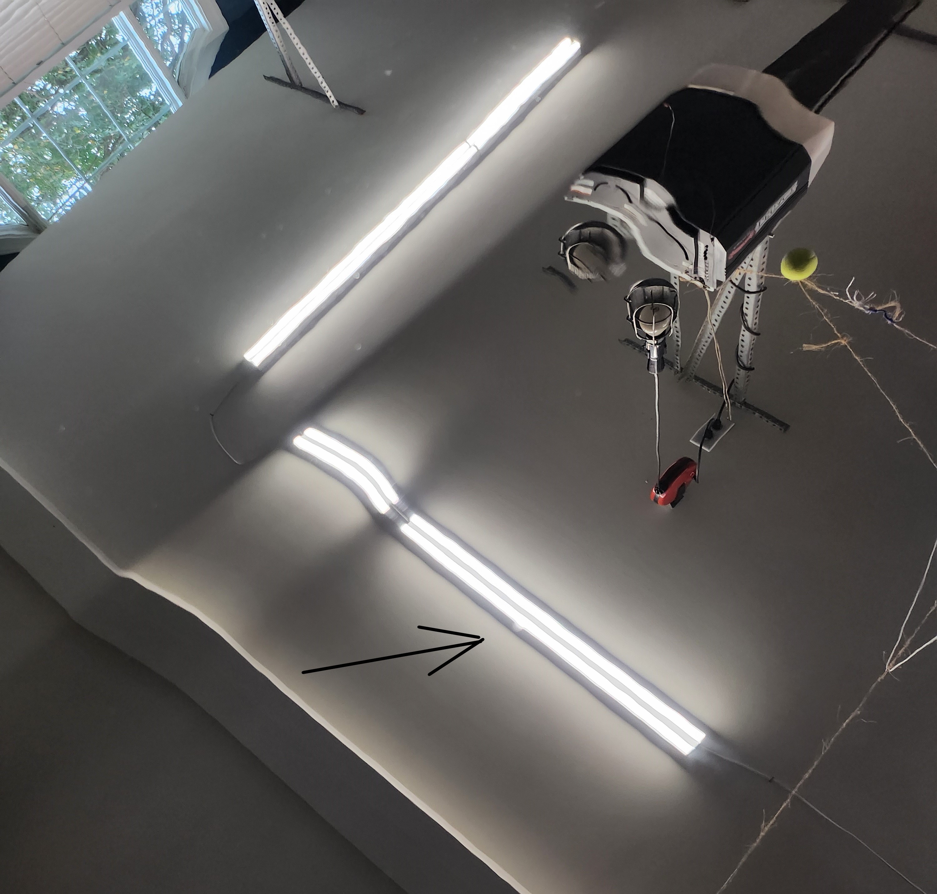

After delivery I had to take the wife for a quick drive around the neighborhood, in the rain, so later that day I dried off the hood so that it wouldn't spot. That's when I noticed that the paint wasn't all that it should be. This is a black car, so it reflects very well, and I noticed some "stuff" on it. I figured it had been parked under a tree. Tree sap, etc. is a constant problem for me at work, not to mention bird droppings and other nonsense. I have requested a reserved protected covered parking spot, but HR has not yet responded. Of course, they'd have to build me a garage, and since I'm just a peon, I'm not holding my breath.

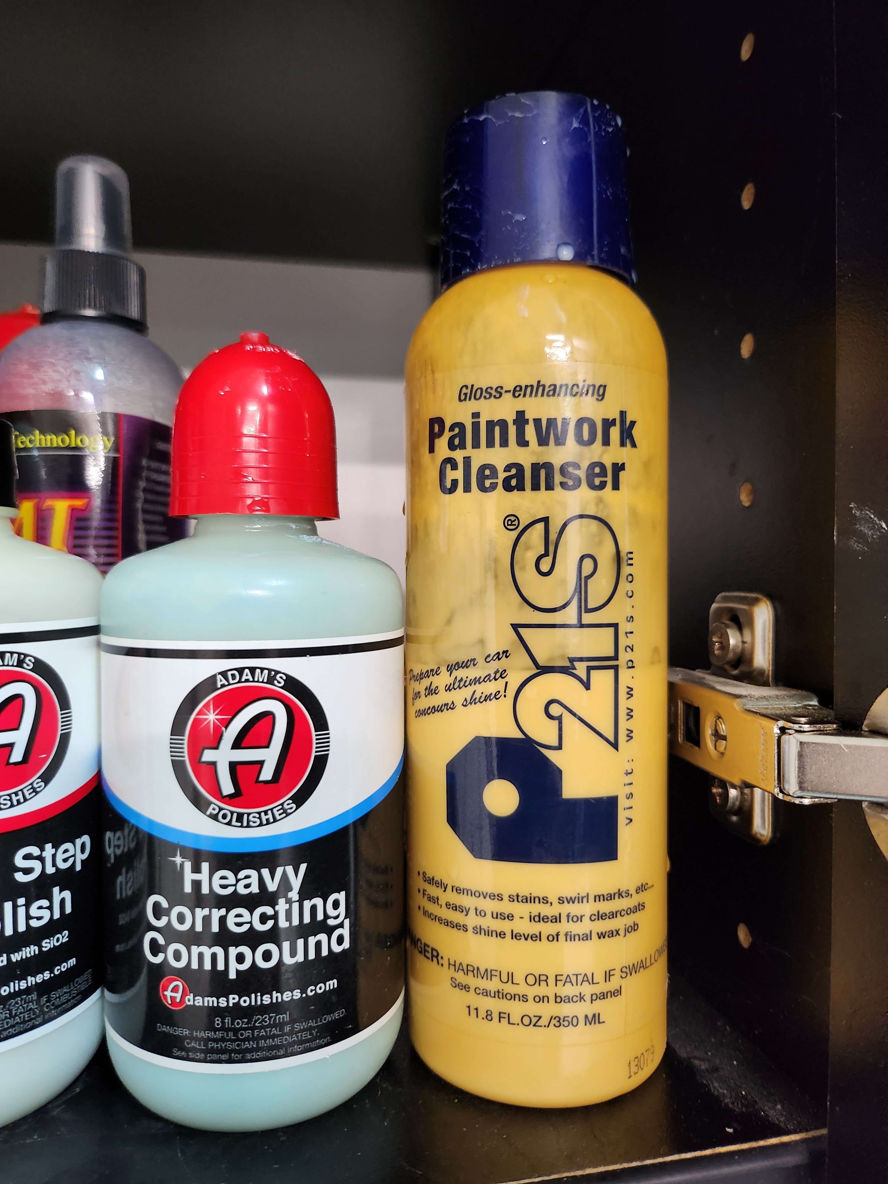

I started by using clay on the hood, and that didn't help. I always start with the least abrasive tool and work my way up. After the clay, I used some "paint cleanser" which I find works very well and is easy to use. Nope. Then we went to a "compound" polish, which is the strongest stuff I have (I have bottles and bottles of polish, and most of them don't do much of anything except make it shiny). Nada.
It's difficult to take pictures of shiny paint, but you can see some of the defects below which show as light grey spots. I think the camera was focusing on the reflection of the ceiling rather than the hood.

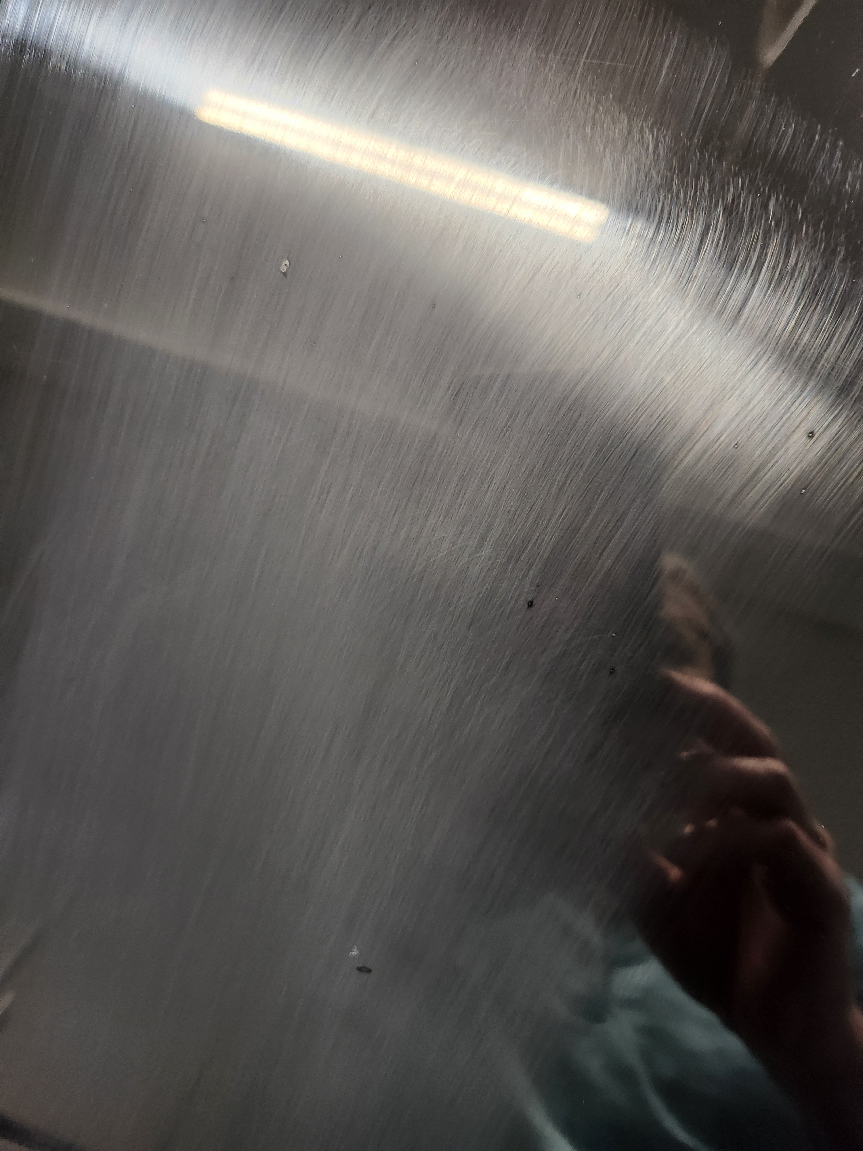

So after trying everything that I could think of, I broke out the sandpaper. A top-quality paint shop will wet sand between coats, or at least on the final coat of clear, and I've seen it done long before I ever tried it. I have ruined the paint on a couple of cars as I learned how to do this, so now I don't mess with the lower grades of paper and just use 3000 grit exclusively. And lots of water. Hence "wet sanding". It is scary how it looks after you've literally sanded away some of your paint:
You can see the defects are still present, showing as darker bits in the picture because they are higher than the surrounding paint, as one might get if there was trash in the finish. They are actually shinier than the surrounding paint, but the camera sees it as darkness. I continued with a little bit more sanding until all but one of the marks were gone, because the point here is to get everything level, which gives you reflectivity which we perceive as shine.

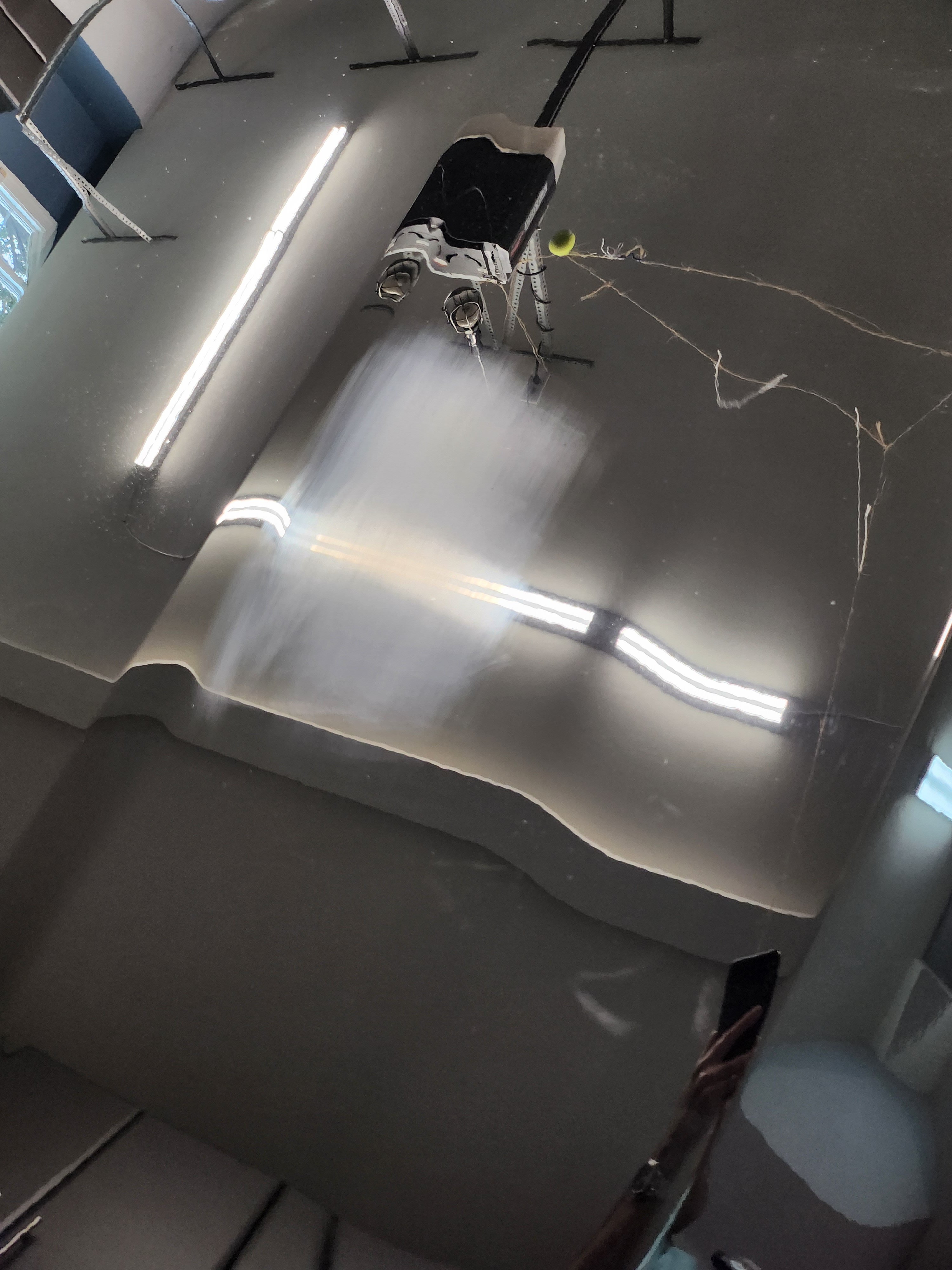

This is what the section of the hood looked like after a few minutes of very light, very wet sanding:
You also have be very careful on edges and anywhere that the surface is not flat, so that you don't remove too much paint. That's why I picked a flat section. Are you scared yet? Gads, the first time I ever did this, I was sweating bullets.
I used the Adam's polish shown above, the compounding polish, as it is very aggressive and works great to take out the scratches. I have several polishers; in this case I used my small Rupes 3" electric polisher with the Adam's to take out the sanding marks. This is the same hood after a few minutes. I drew the arrow to point out that one little area that is still barely visible; otherwise I got out almost everything I think.

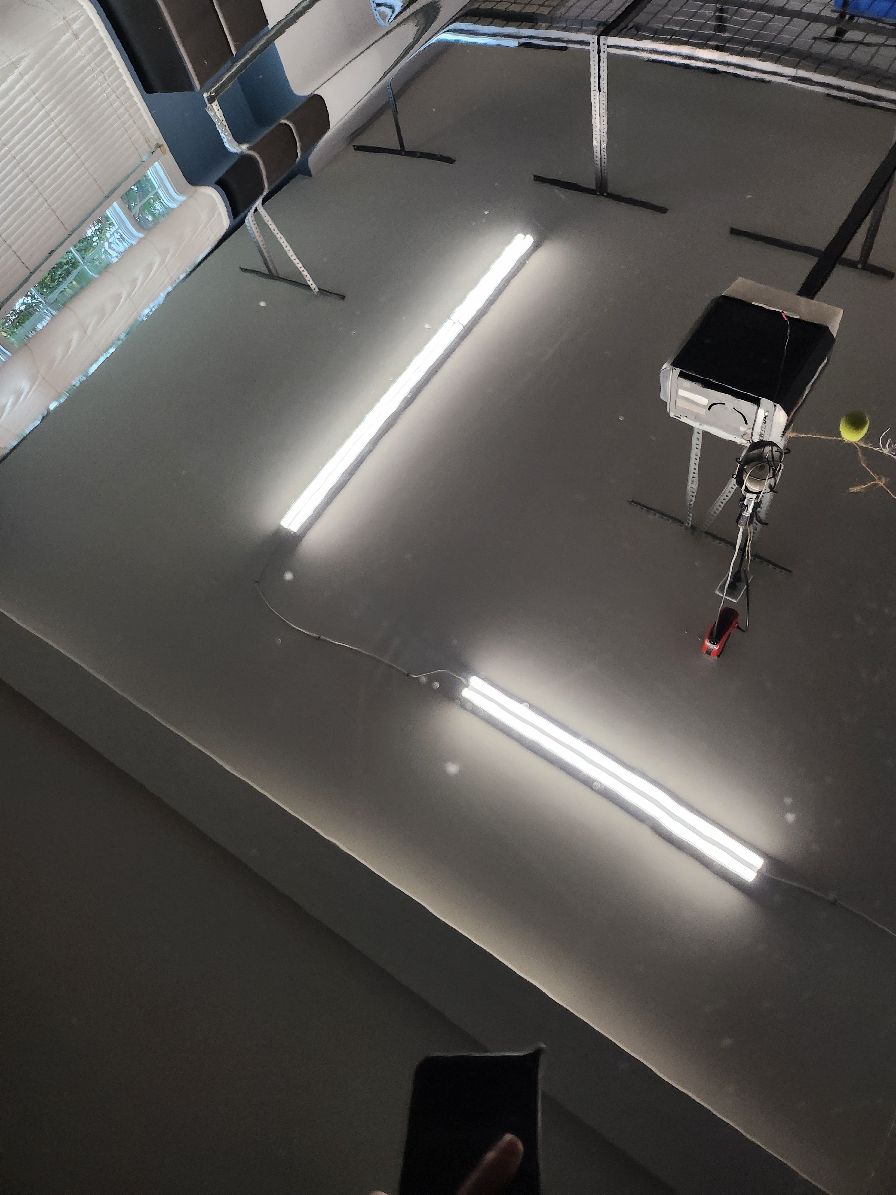

So... as an update, I noticed last week that the section where I had wet sanded and polished the hood still looks like crap. The defects are deeper in the paint than originally suspected.
However, I also noticed that my car was built in March, and I didn't buy it until August. It might have sat at the dealer's for 5 months unsold, but from what I've read here (and based on the paint condition) it seems that it was sitting around like so many other cars waiting for whatever it was that was in short supply earlier this year.
