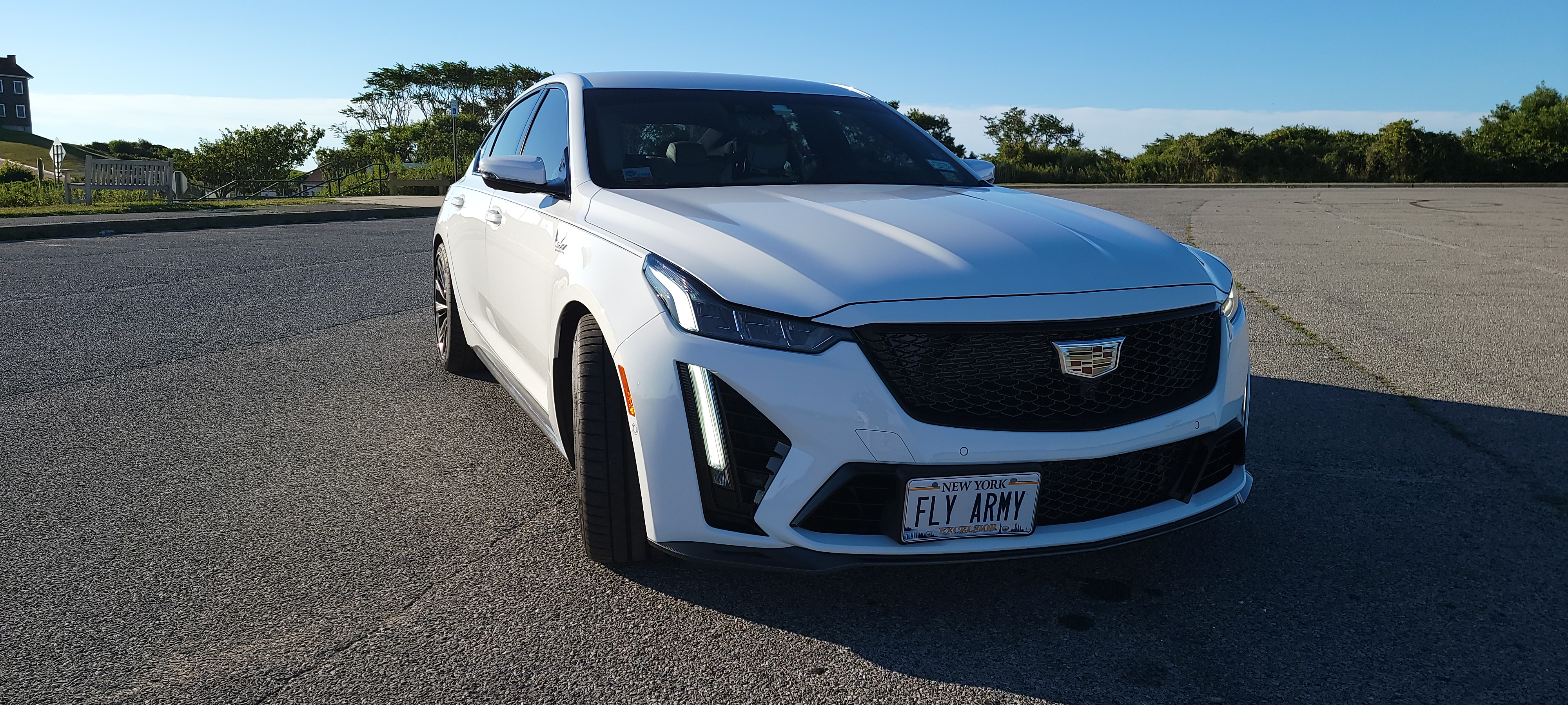

I attached mine with thick zip ties. Had to drill some extra holes into the bracket. It does block some of the grill area but not enough to be detrimental. In NY the law requires you to display a front plate that must be no lower than 12 inches and no higher than 48 inches from the ground.

It never even occurred to me that there could be a minimum height. I need to check my state laws.
I've seen a couple of people offset the plate on the lower grill like you have done. Has anyone tried centering it on the lower grill? Seems like that would have a more OEM look.

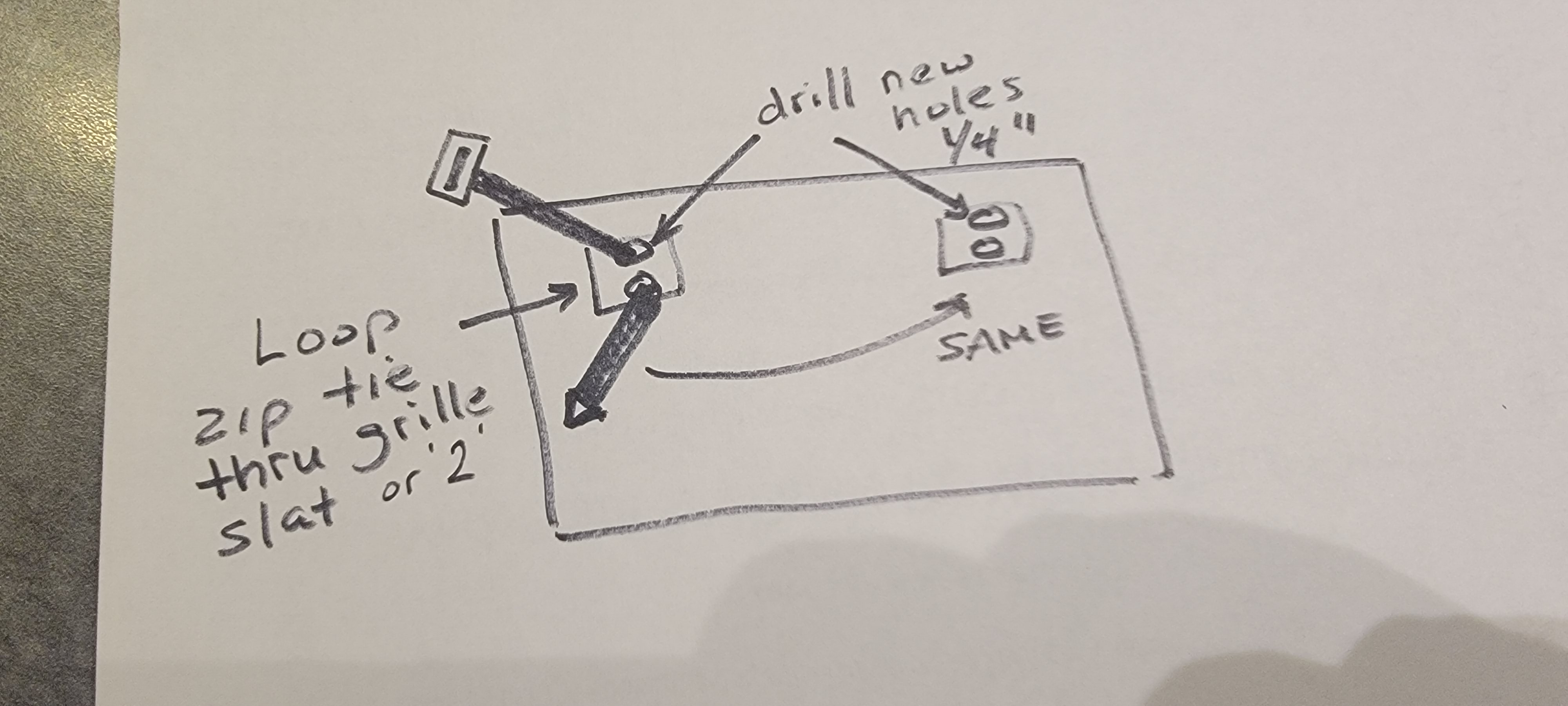

How did you do that?
On the plastic license plate holder there are the two recessed holes Left/Right for the screws to attach to the bumper. I drilled a 1/4 inch second hole above the factory holes. Then I pushed "black" 1/4 inch thick x 18" long zip ties thru the upper bracket hole, (with the locking part outside the top hole facing me). Line up where on the lower grill area where you want the bracket placed. Feed the zip tie thru the grille. I used a needle nose pliers to grab the pointed end of the zip tie and made sure it was looped over one/two grille slats. Now is why you need the 18" length. Then feed it thru the back of the lower hole of the bracket and pull the zip tie tight. The bulging lock part fit nicely inside the bracket indent. ** Use only a black zip tie to blend with the bracket and the grille or else you will see the zip tie if its white. Don't ask me how I know it looks like crap. I hope my little diagram helps with my narrative.
