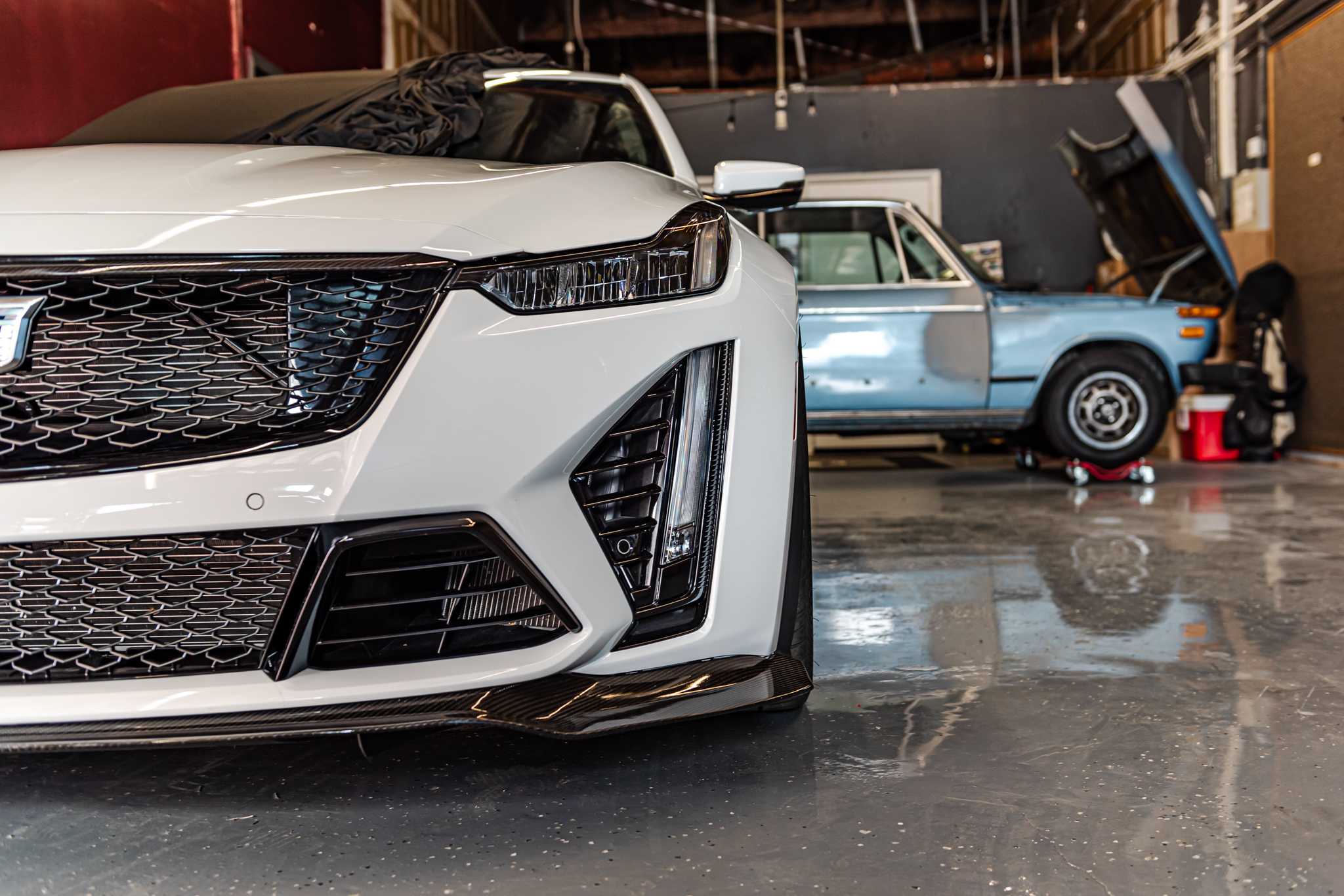

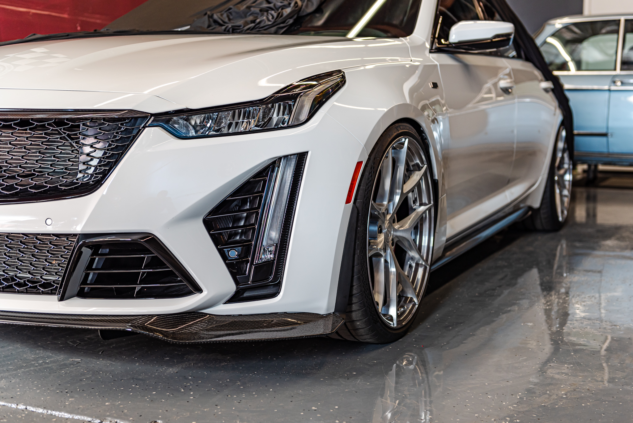

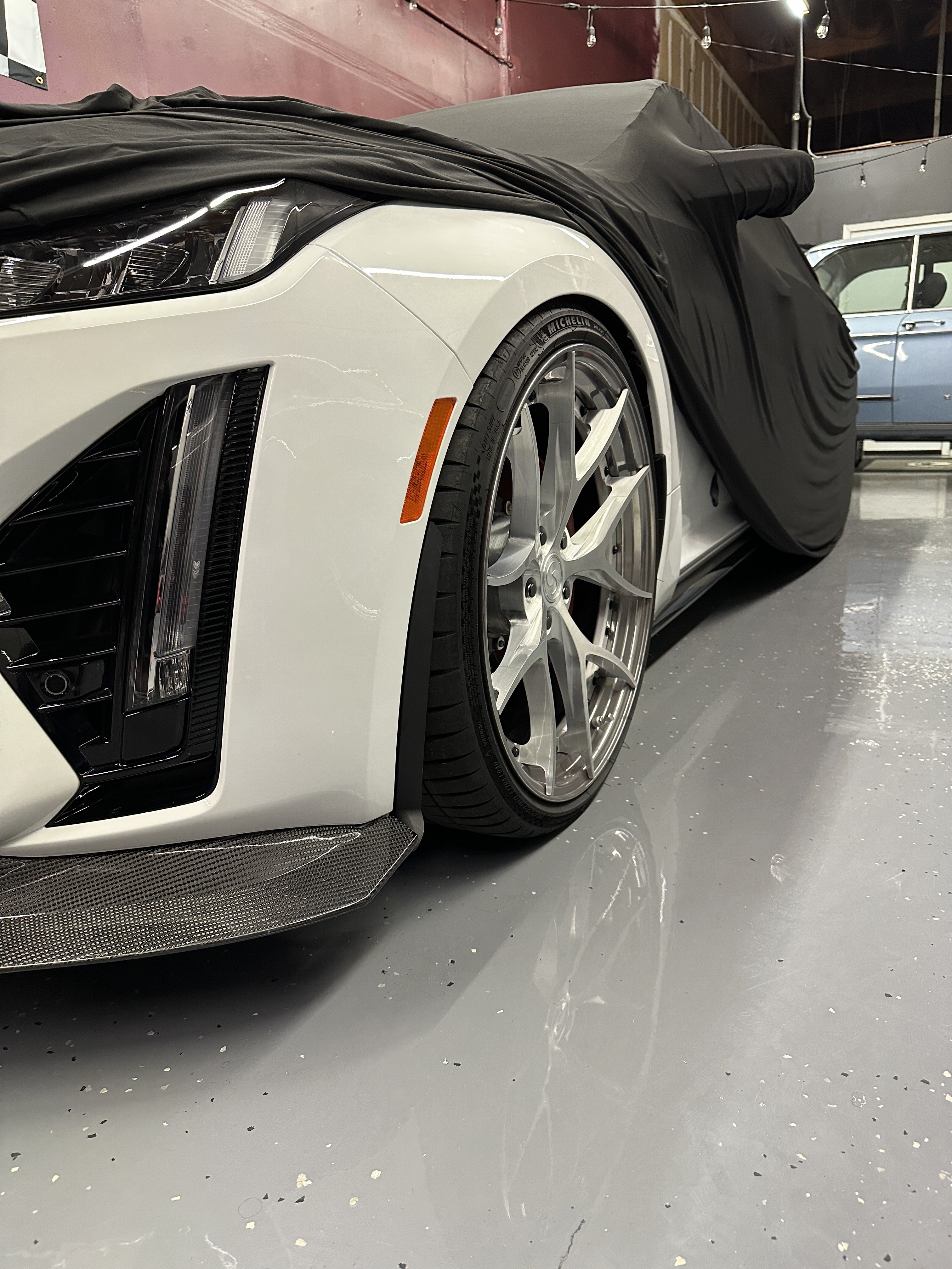

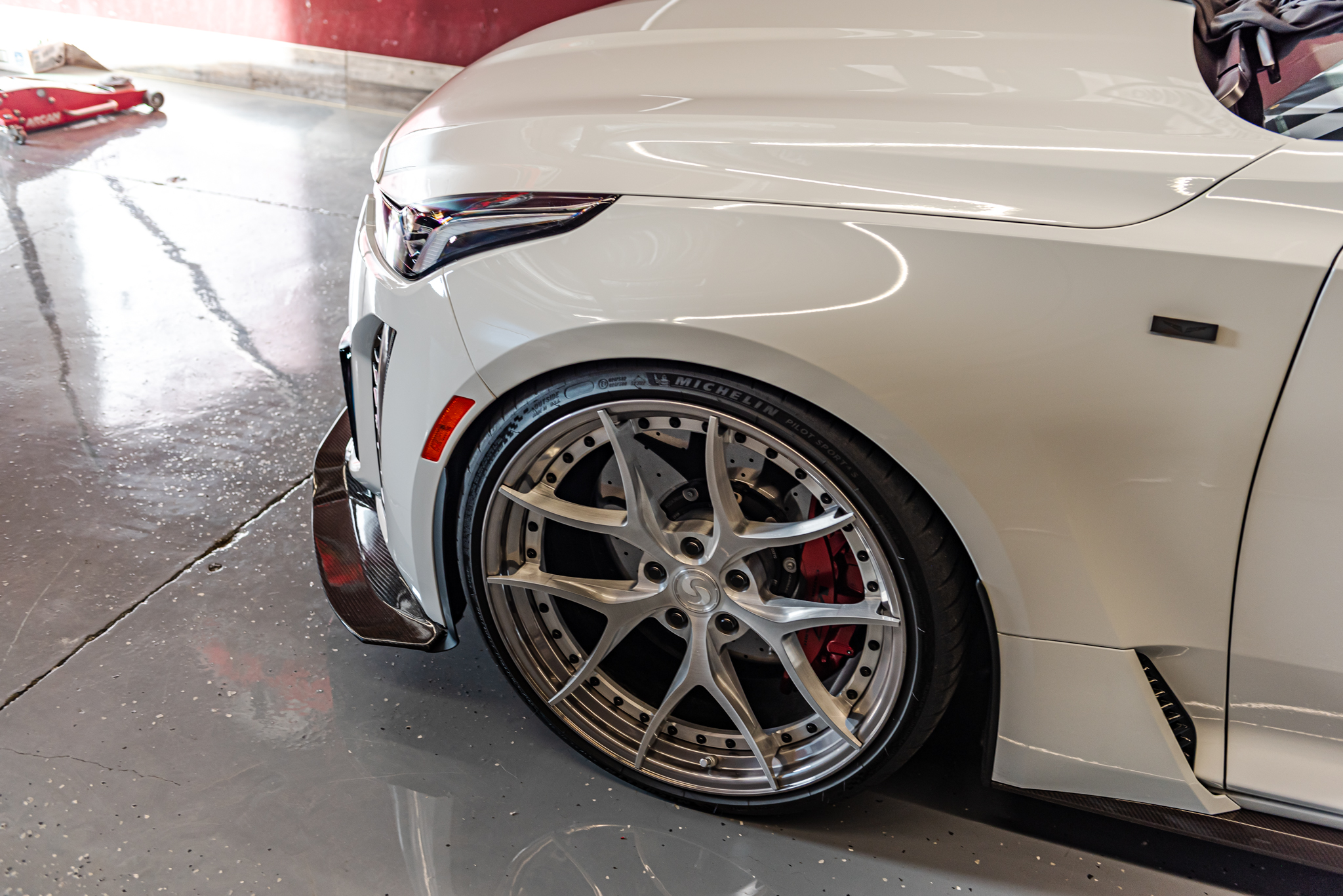

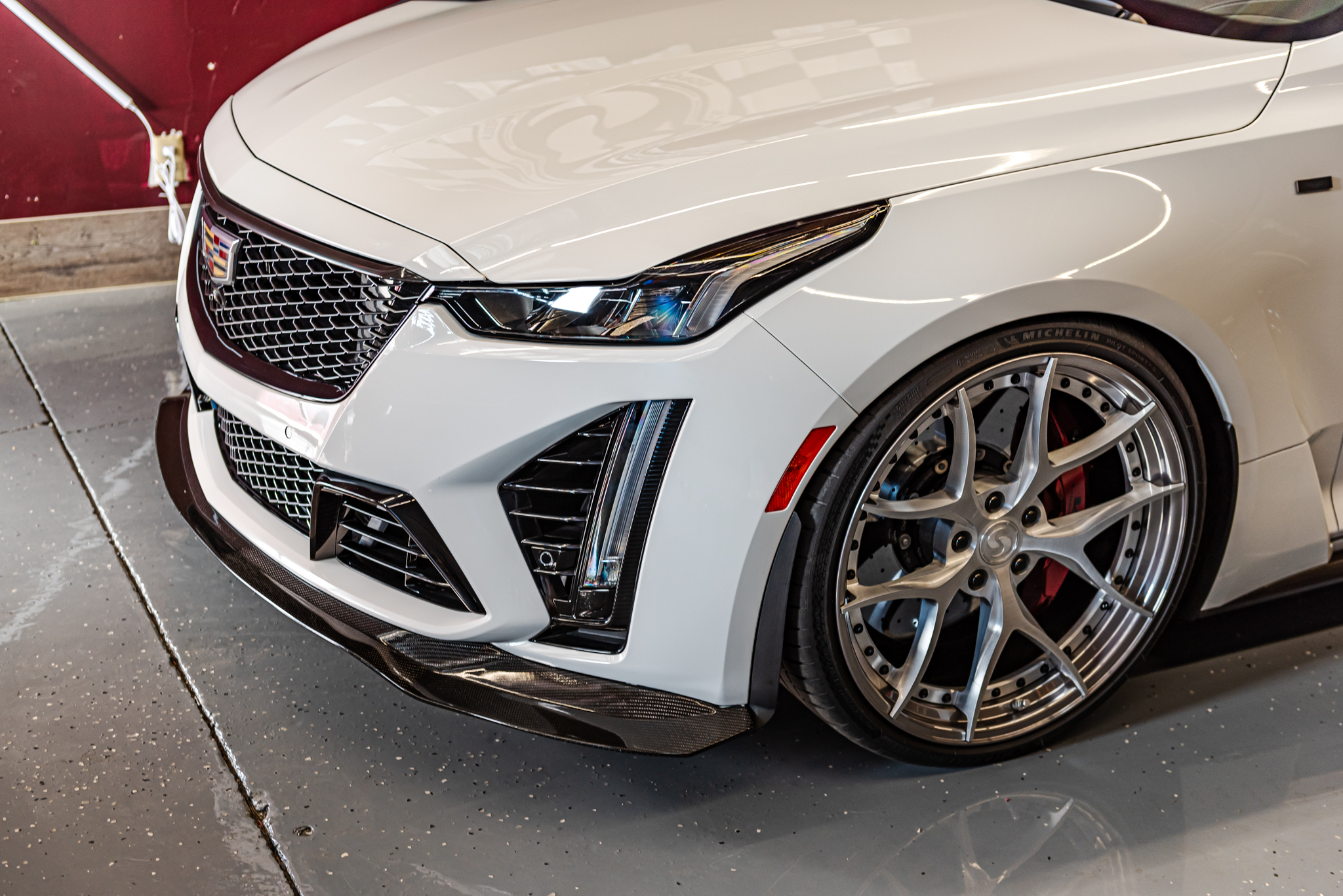

Received mine as well. Too impatient to wait for the wickers. Had to get it fitted to see the outcome. Terrance, incredible job on this piece. Absolute OEM fitment and quality. I’ve dabbled in a few top tier carbon company’s with my M cars, and this is up there with the best in terms of quality and fitment. Can’t wait to get my rear spoiler.

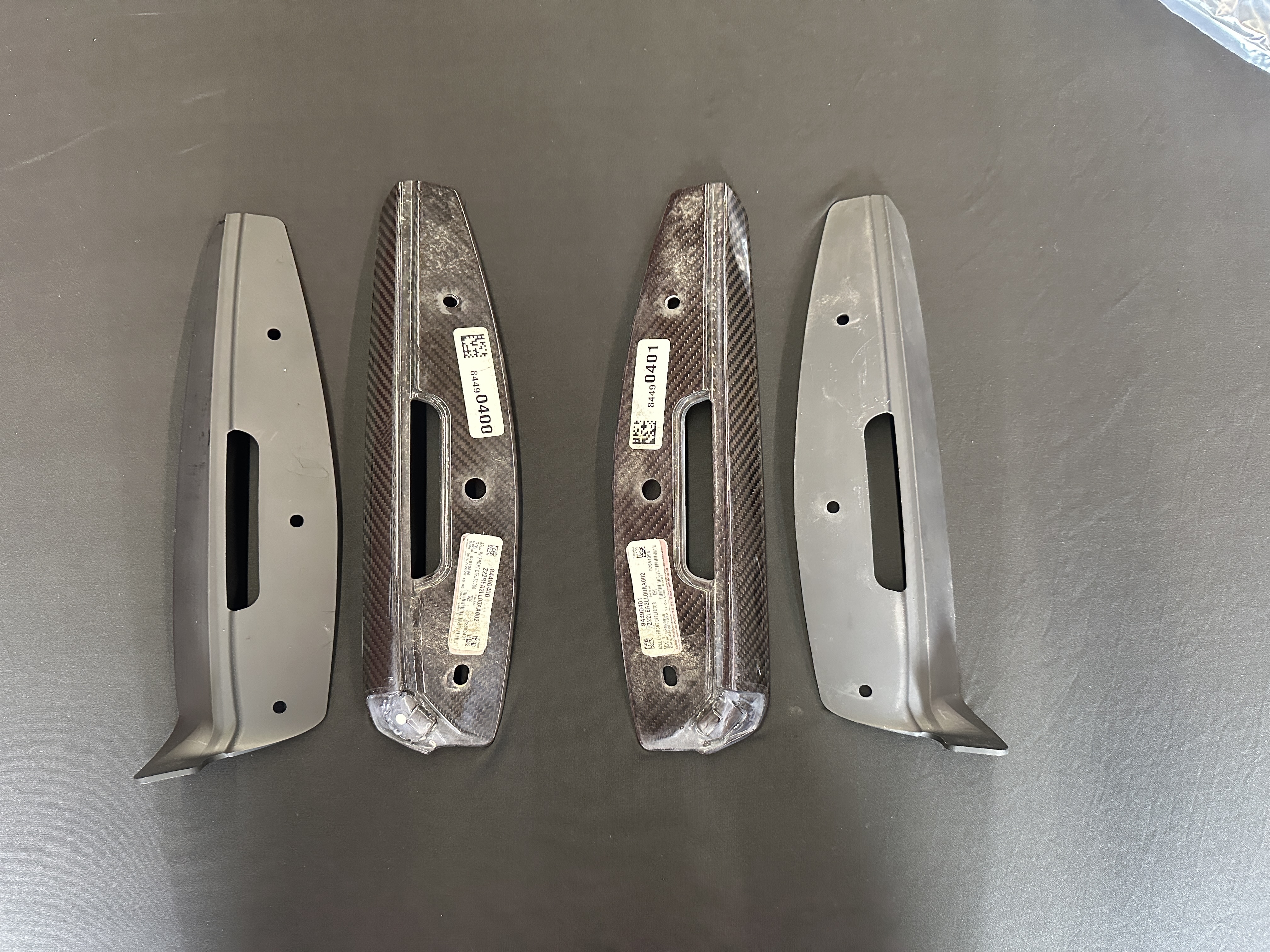

Final revision on the wicker is in and installed. Looks like I can get these quoted up in Carbon next to finalize the package.
Quick pic of the revisions compared to OEM. I will share installed pics shortly.
