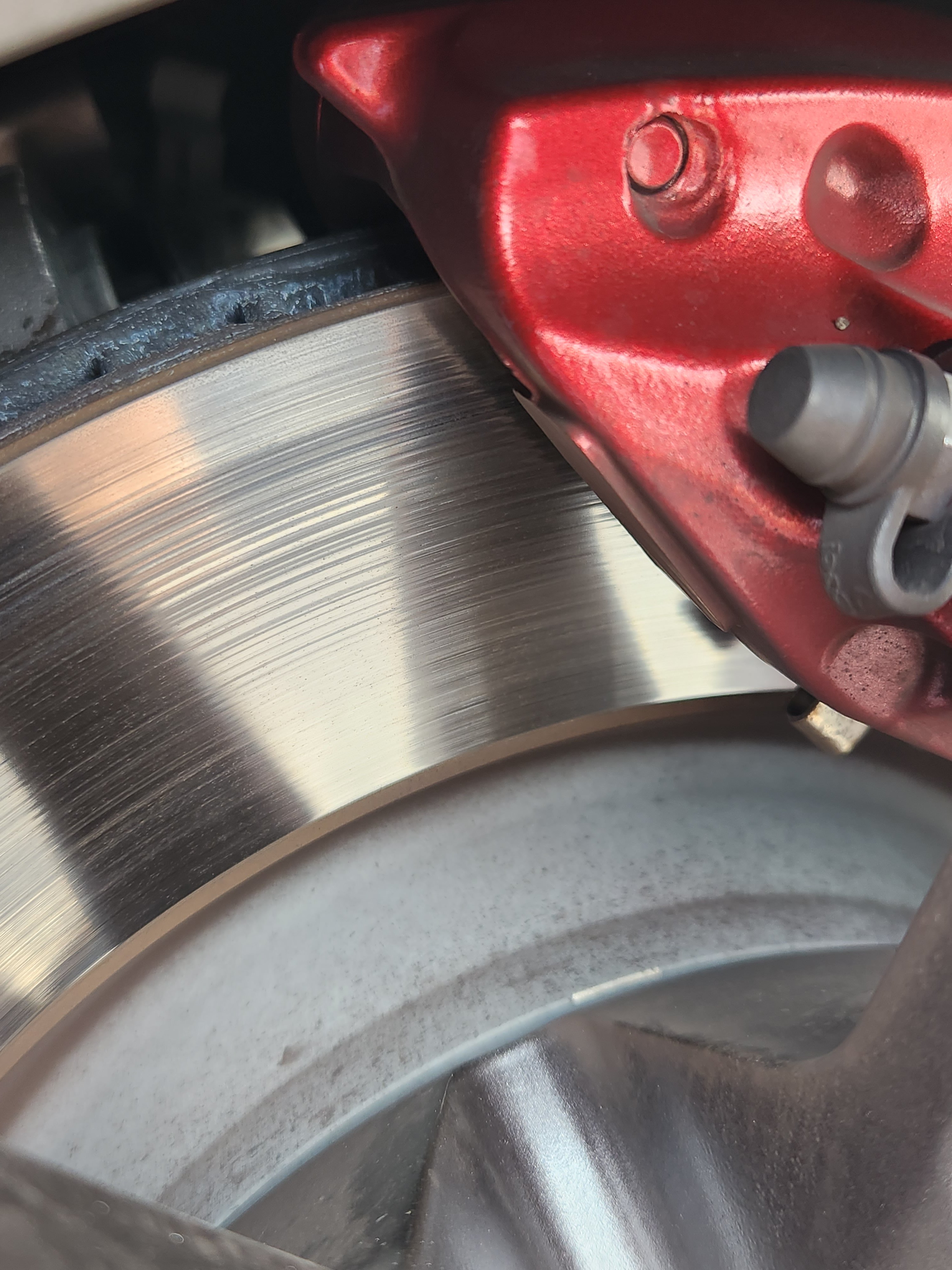

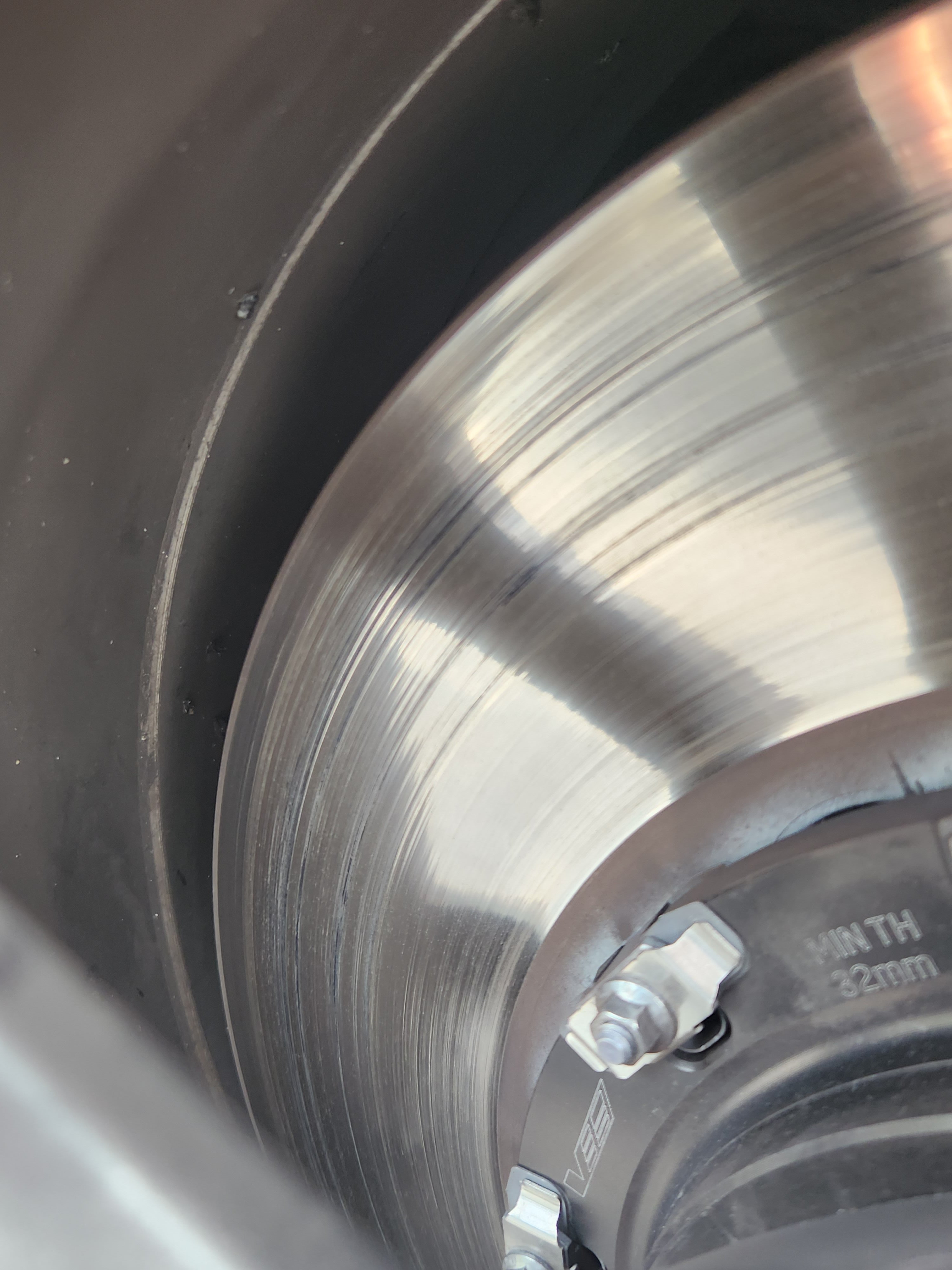

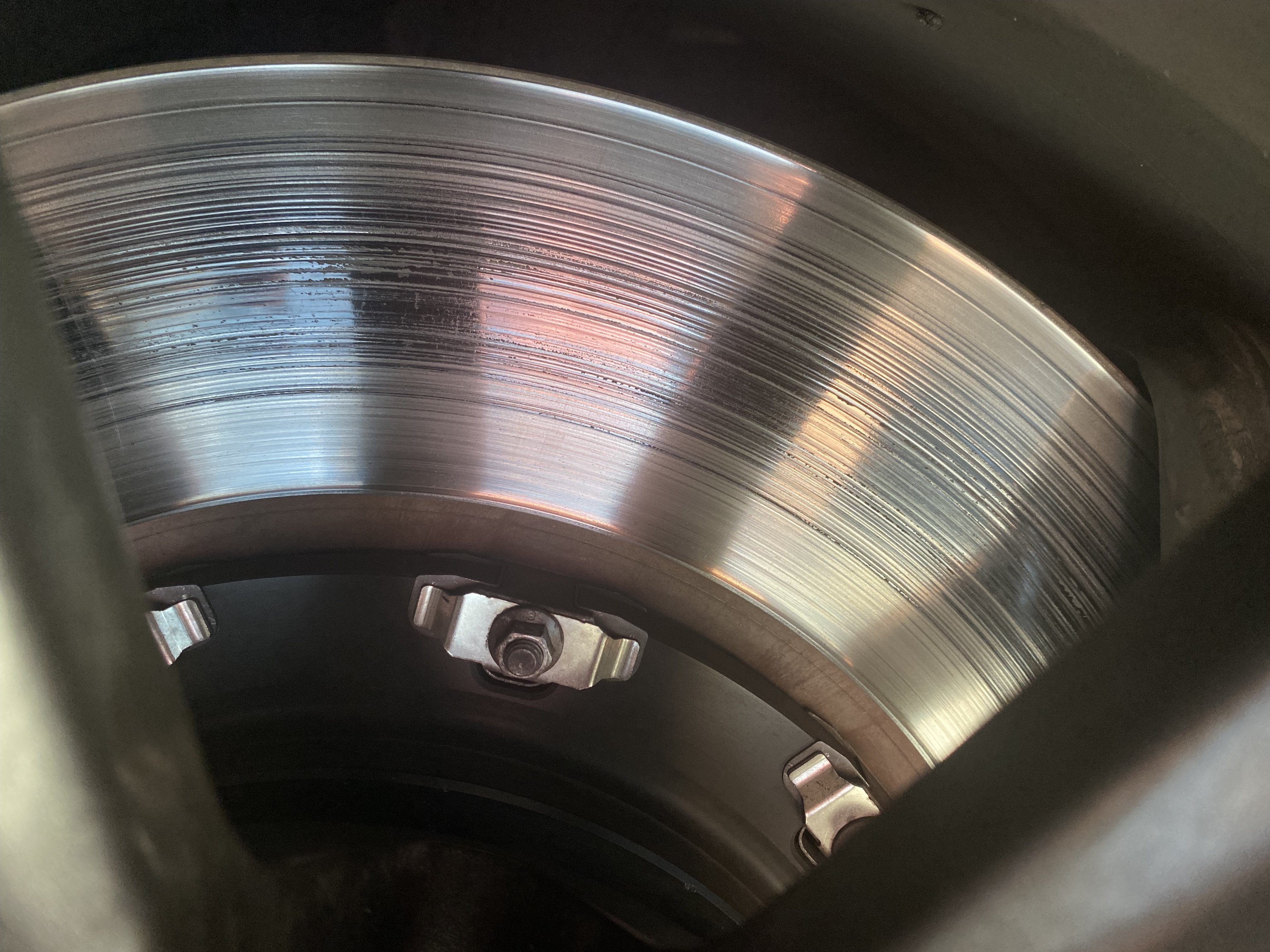

I'd be curious what your rotors look like, mine have some kind of grooves after one track day, all 4 are similar.

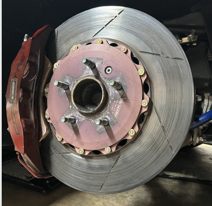

I'm attaching a picture from the Corvette forum pad review for SR-11. My rotors looked similar. The EBC pad is creating a new layer on your rotor. However, we should pay attention and realize that deep grooves on rotors after a track day is a different story and can happen due to debris or pad that disintegrates too fast and scratch the rotor (I'm attaching a second picture of my rotors after using stock pads on the track and getting deep grooves).

I brake very aggressively and would often trigger abs with the stock ps4s tires so that would explain my rotor grooving I guess.
