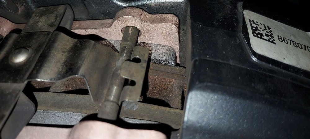

Here's what mine look like installed.

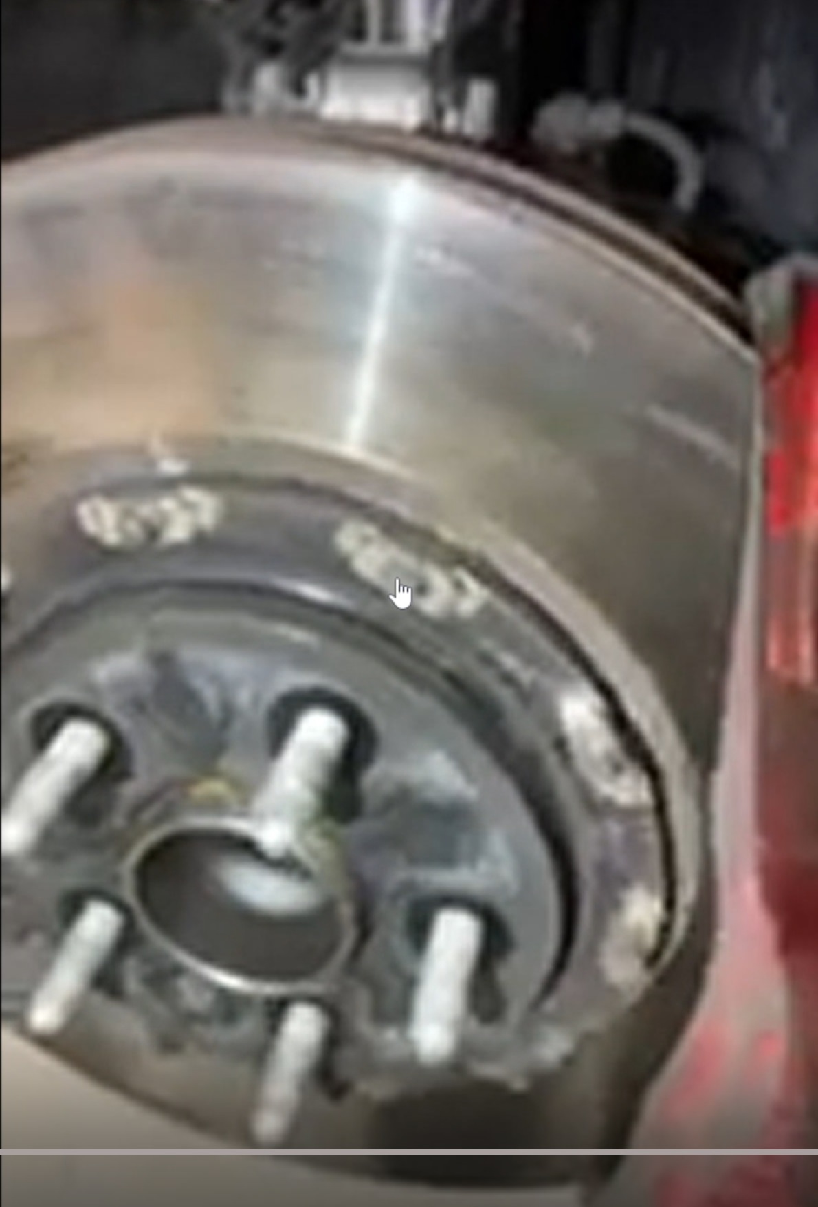

Just installed these:
Front: DP81853.15SR11
Rear: DP83023.15SR11
after burning through the stock pads in 20 (20 min) track sessions. Check out the attached video.

How was the fit of the rear pads ?
I just checked. You cannot see the pads, just the calipers. So I assume the reports are correct that these pads are smaller than the stocks. However, the Dealer tech did not mention that there was a problem. We will likely need to find another model that fits better. But I am good for now.
I ordered the ones I posted about in my last posts so we will eventually know if they are the right pads.

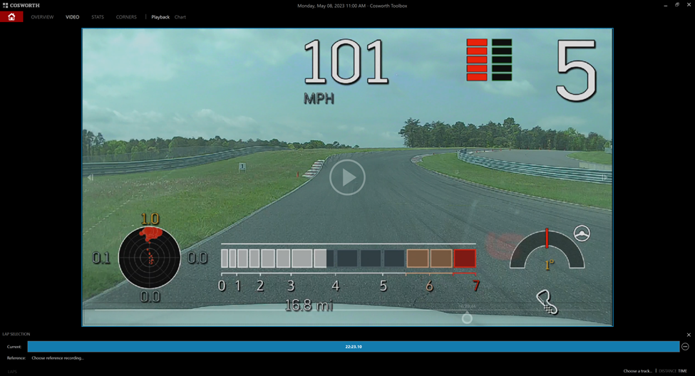

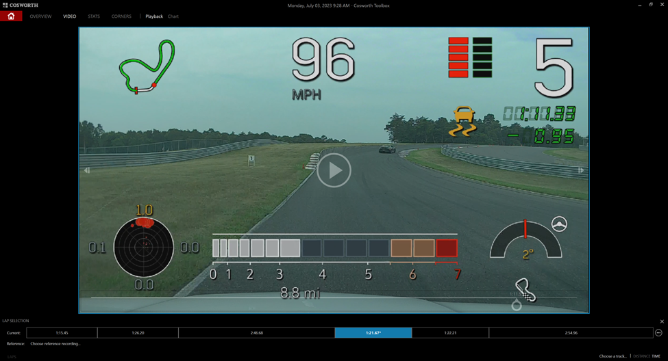

UPDATE: First track day using these pads, my report is that I see improvement with stopping power once you are up to temperature at the Track. I did an unscientific test by reviewing PDR recordings on the same track with the stock pads and then with the EBC pads. I max speed to the NJMP start-finish tower is 133MPH at which point I go on full brakes. The EBC pads seem to perform about the same from 135 down to 110MPH - Marker 3, but then improve between 110 and 95 @ Marker 2. That was my impression at the track that the stopping grip increased with the new EBC pads. With the stock pads, stopping was either linear or with a slight fade. For now, I will keep braking at the tower and enjoy the better safety margin.
Stock pads @ the 2 Marker
EBC Pads @ the 2 Marker

Interesting you’re pulling the same G’s with both pads.
I think this just shows that GM put some real good pads on the car from the factory like they do on 1LE, ZL1 etc.
The SR11 pad is after all an endurance pad made to work at high temps for long periods of time so what he's experiencing seems to make sense.
The max G under braking is not just the pad...it's more the max grip of your tiers before ABS is detecting wheel lock. Yes, stock pads are pretty good and give you a good street driving and safe track use for beginners on track / advance drives (at the cost of very short life).
The point of better/dedicated track pads is safe and consistent performance at the track with longer pad life.
I've been following this thread out of interest even though I've got a 5, but this is something I'm struggling to understand. Improved longevity and heat resistance I totally get.
But I have no problem hitting ABS with the stock pads at speed in the 5 so I'm genuinely curious if/how improving braking performance could come from a different pad.

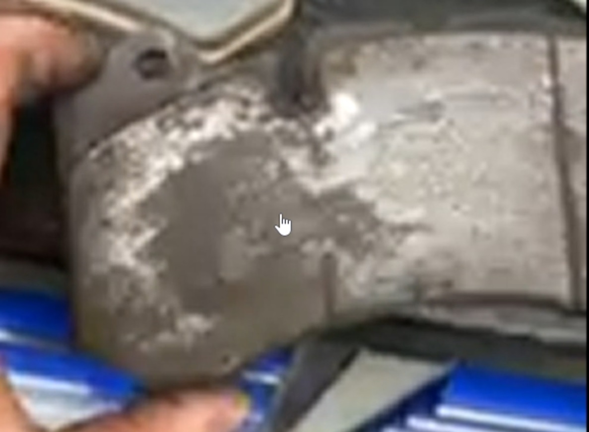

After having the EBC track pads installed in my CT4V-BW and using them for 1 track day - (5) 20-minute sessions, the brake vibration that I was experiencing after my prior last track sessions with the stock pads has gone away. As a recap, after 3 track days using the stock pads, the front braking had developed a pulsation/vibration at the steering wheel during light to moderate braking. The vibration increased after my 4th track day which was only a half day. The vibration remained after I installed two new front tires - both street driving and during my 5th track day session. In total, I had the stock brake pads in use for 5700 miles which included 5 track days.
Upon inquiry, I was informed by two Cadillac dealers, and the Chevy Dealer that did the EBC brake pad install, that I likely needed new rotors. My intent was to replace the rotors after a total of 10 track days.
