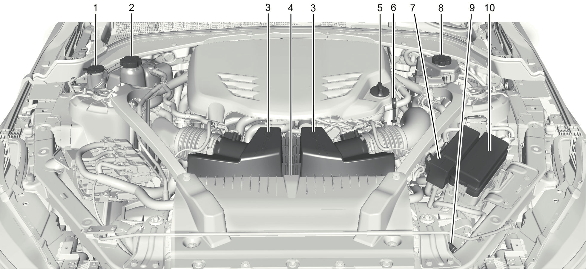

well the diagram in the manual shows the 2.0 liter and says "the 3.6 is similar," only it's not really. It also stresses how you can easily short out the car and GM will not give you any warranty repairs, so I'm trying to get good advice
Per the manual, 9 points at the negative terminal you are meant to use for jump starts and trickle charging.
On the 2025 CT4 manual, this is at pages 298-299.
I like the pic, but if I'm the donor vehicle I don't think all of those work, don't I need both of my ends on the battery leads.
I know where all the right posts are for attachment under the hood, but anymore I feel it is risky to try to jump another car with mine and won't do it. If the other person does not know what they are doing with jumper cables, bad things could happen to your car. I carry a jump box in the trunk. They are super handy.
OK maybe you shouldn't be offering to connect things to your car or you need to re-read the manual a few more times. But in case you really really really want to do it: red cable goes to #7 (after you remove the red plastic cover), and black goes to #9. Connections happen at the end of lines 7 and 9, not at the numbers themselves. All the other numbers on the diagram are for other things, not for jump starting cars as explained on the page after this picture. Also this picture is in black and white, your car is probably not black and white inside.

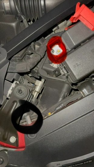

Wife's van is broken down, I'm trying to help with a car I've had for 6 months. I've jump started cars a billion times and never worried about it. If I short out the electronics we're both boned. A guy parked next to us and we jumped it in seconds, I had to walk him through it. I realize you think I'm an idiot here, but I have no interest in finding out I am by wrecking my new car. I tried flipping through the manual and checking youtube, but was not 100%, guaranteed no doubt confident.
So I took a pic with the indicated spots. Am I correct in saying, under the assumption I have a working battery and my wife's van has a dead battery that the steps are.
1) Place (+) red end on dead battery (honda)
2) place (+) end on live battery (blackwing, as circled in pic in RED)
3) Place (-) end on live battery (blackwing, as circled in pic in BLACK)
4) connect (-) end on dead battery (honda)
Start blackwing and let run for a few minutes, and then start honda. All good hopefully.
Removal prodecure, Exact reverse.
1) remove (-) end off dead battery (honda)
2) Remove (-) end off live battery (blackwing, as circled in pic in BLACK)
3) remove (+) end off live battery (blackwing as circled in pic in RED)
4) remove (+) end off dead battery (honda).
