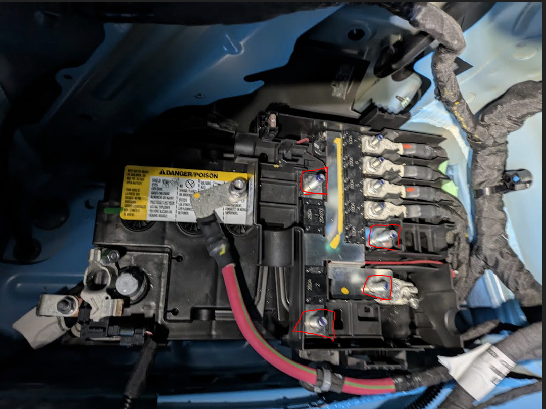

This is embarrassing, but removing the battery has been a nightmare. I pulled up the carpet in the trunk, those push pins were nasty. I am struggling mightily getting the plastic sheath off of the positive terminal. I have pulled the tabs on the plastic on both sides. Had to use an allen key since my hands are too big. And I removed what I thought were the nuts holding it down. I can wiggle it a bit now, but I'm terrified to force it and break it. I'll attach a pic, but has anyone done this themselves? My battery is dead dead and calling to get this towed would be ridiculous.

Why would you remove it just for being dead? You can use the lugs under the hood to jump/booster box or connect a charger. I installed a NOCO on board battery maintainer under the hood. Can't even tell its there when not in use.

You can remove the black plastic shroud on the positive jump terminal. It's just two plastic clips. With that off, you can put a tender on and then close the hood.
