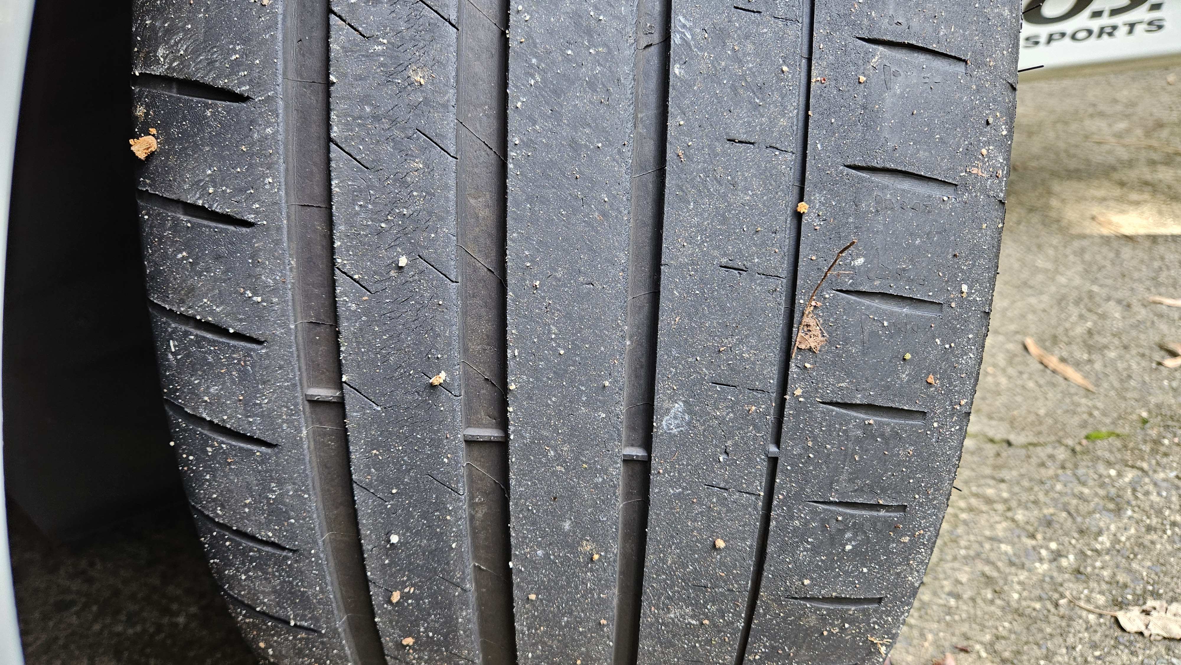

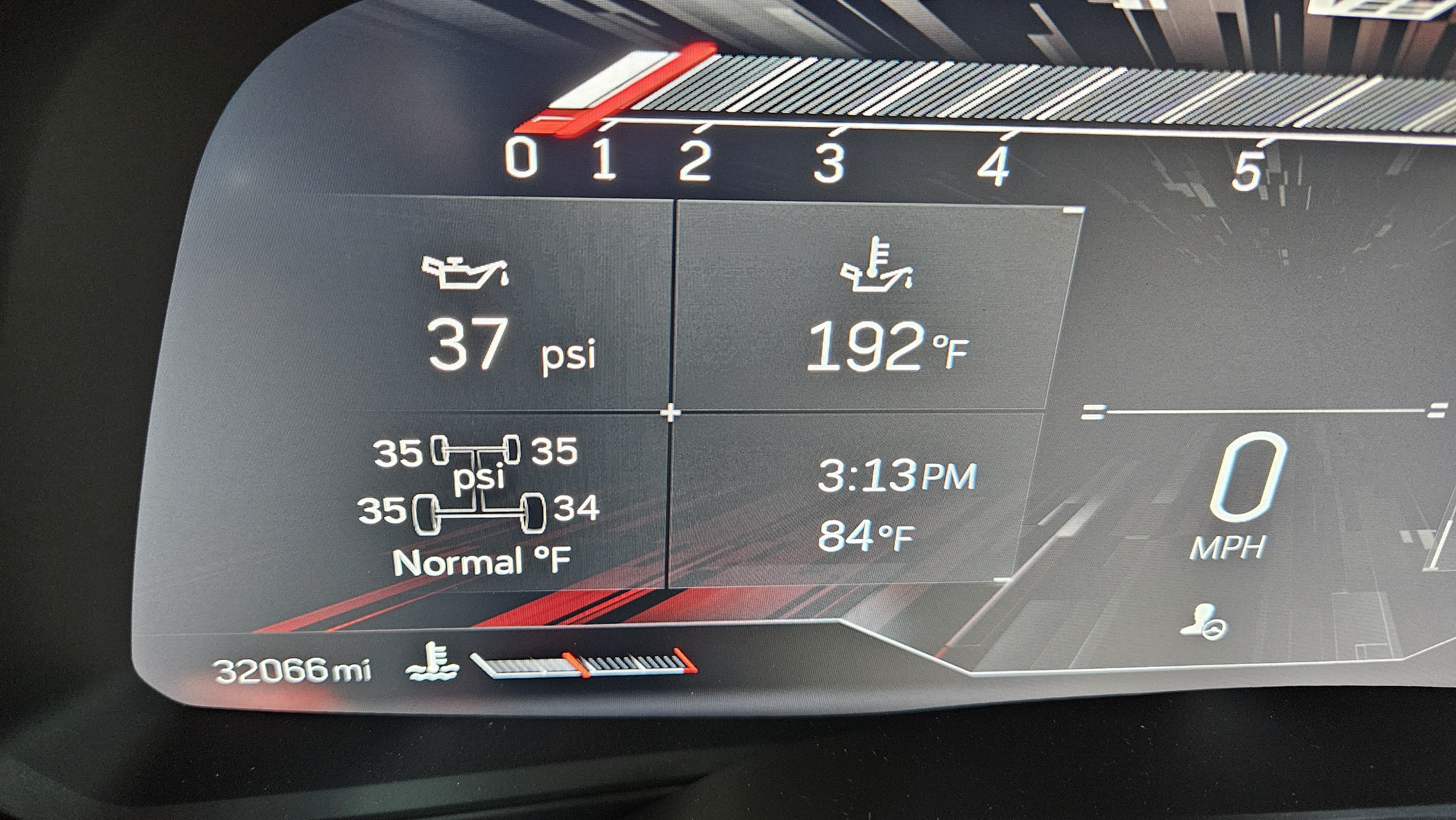

I've got 32,062 miles on my 5BW 6MT. 2 track days but otherwise mostly highway miles. The OEM Michelins are worn evenly front to back & side to side at all 4 corners. They are almost but not quite to the wear bars. I'm probably looking at a new pair of shoes in the next couple of months.
