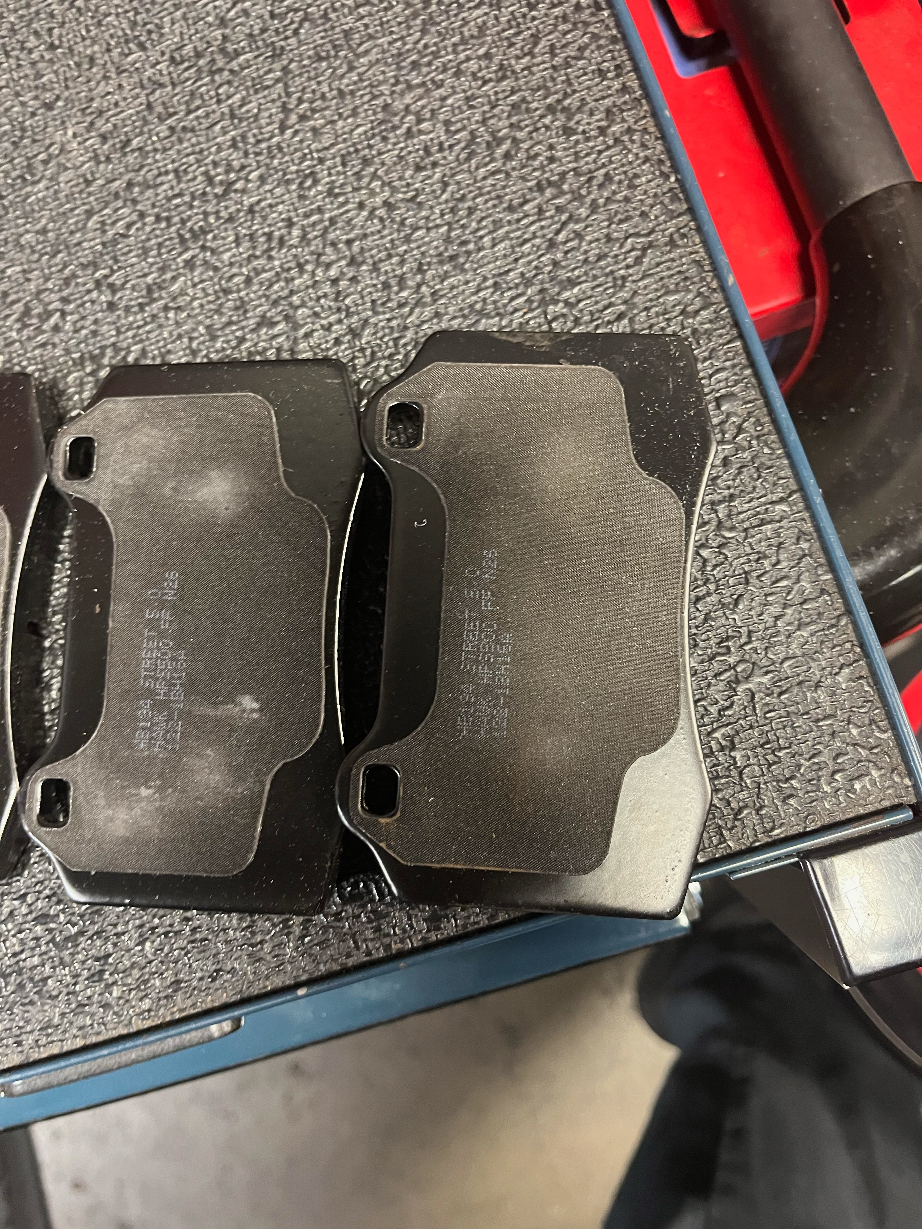

Also, back to the brake issue...., Here are a couple of photos showing the OEM, and KNS brake pad difference without the sensor hole.

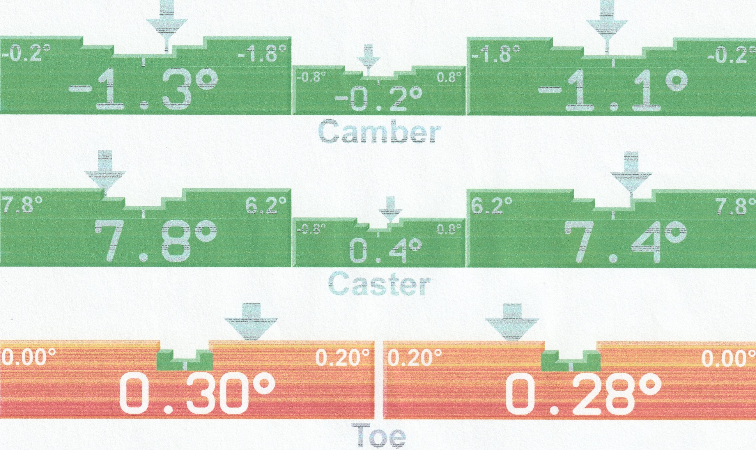

I don’t think that .28 deg vs .19 deg total toe is going materially affe t tire wear. The left to right difference is just how straight the steering wheel is.
True, but I think in combination with the camber at the high end of the correct range, we may see a cause. I've asked the Service Manager and my salesman to move this epidemic up the line with Cadillac and tire folks. Sent them a link to this thread. The tire folks should know if there are other cars seeing this. I noted the Porsche mechanic info in this thread to the effect the camber is too negative in the Taycan and some Teslas. Would be interesting to see if the higher-ups do some investigating..
View attachment 28220View attachment 28221
Just use the ones you bought and zip tie off the sensor. Many of our replacement pads don't yet have the sensor cutout.

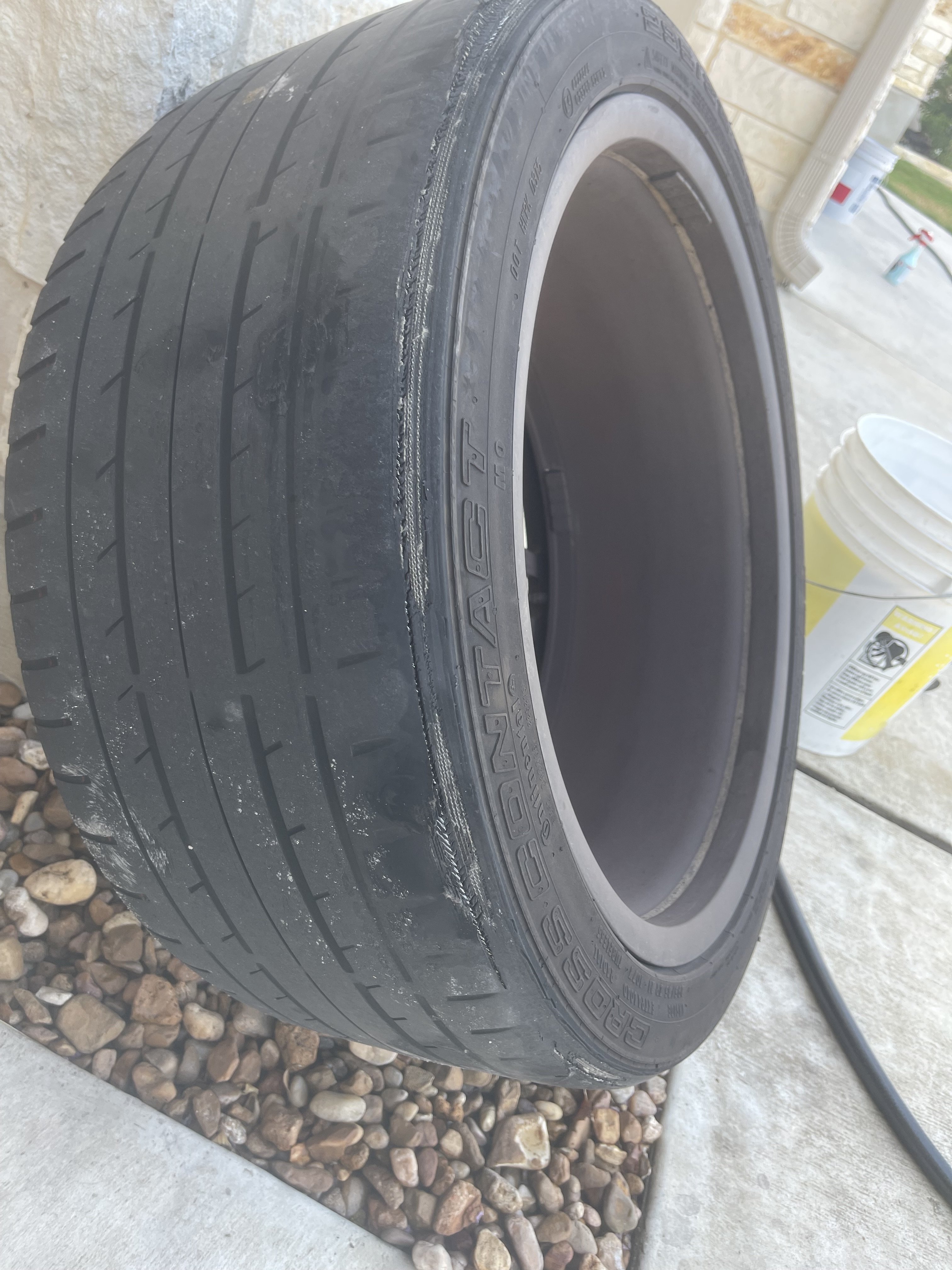

Glad you were able to live and post that pic. Unreal how it appears it just rolled off the wheel. Were you going around a bend at all or did it just walk off like that?
I was on vacation going straight when the rear started wobbling and I pulled over. Had Onstar get me a tow to a Cadillac Dealer. There I had a new Michelin put on.

Had an alignment check done on 5BW with 4700 miles and revealed significant anomalies in the settings. See the attachment which describes just the front. I'm not happy this wasn't caught and I do believe similar was and is responsible for my tire problems. I also learned that GM will pay for alignment anomalies in the first 7500 miles! so go get yours checked!!

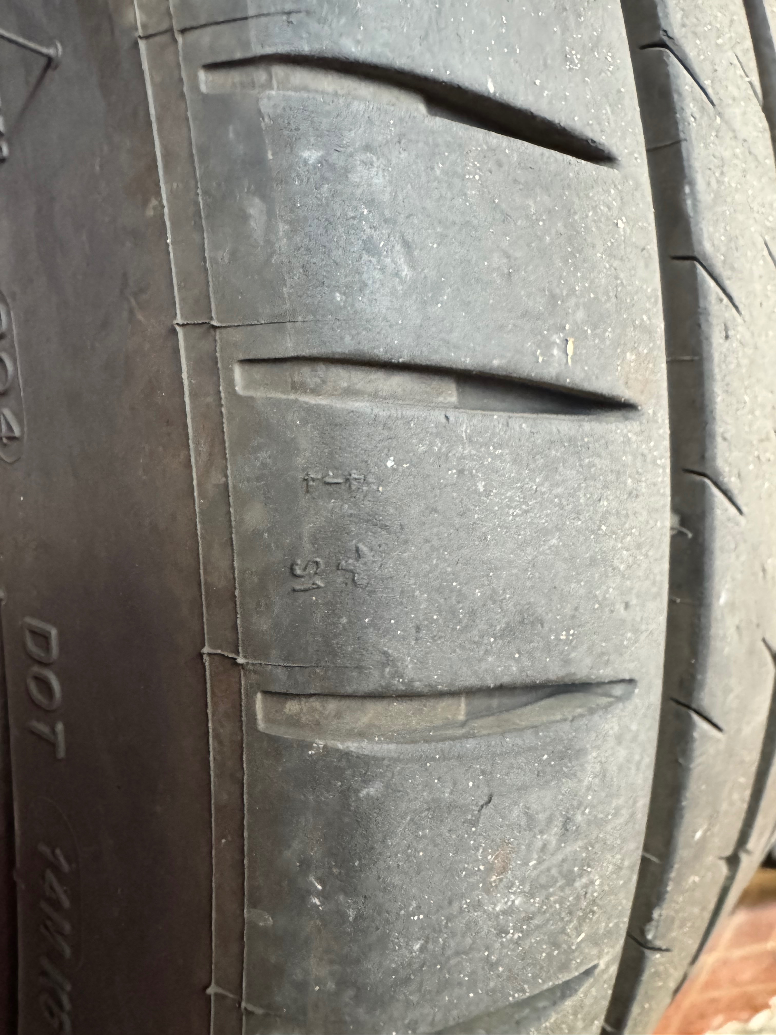

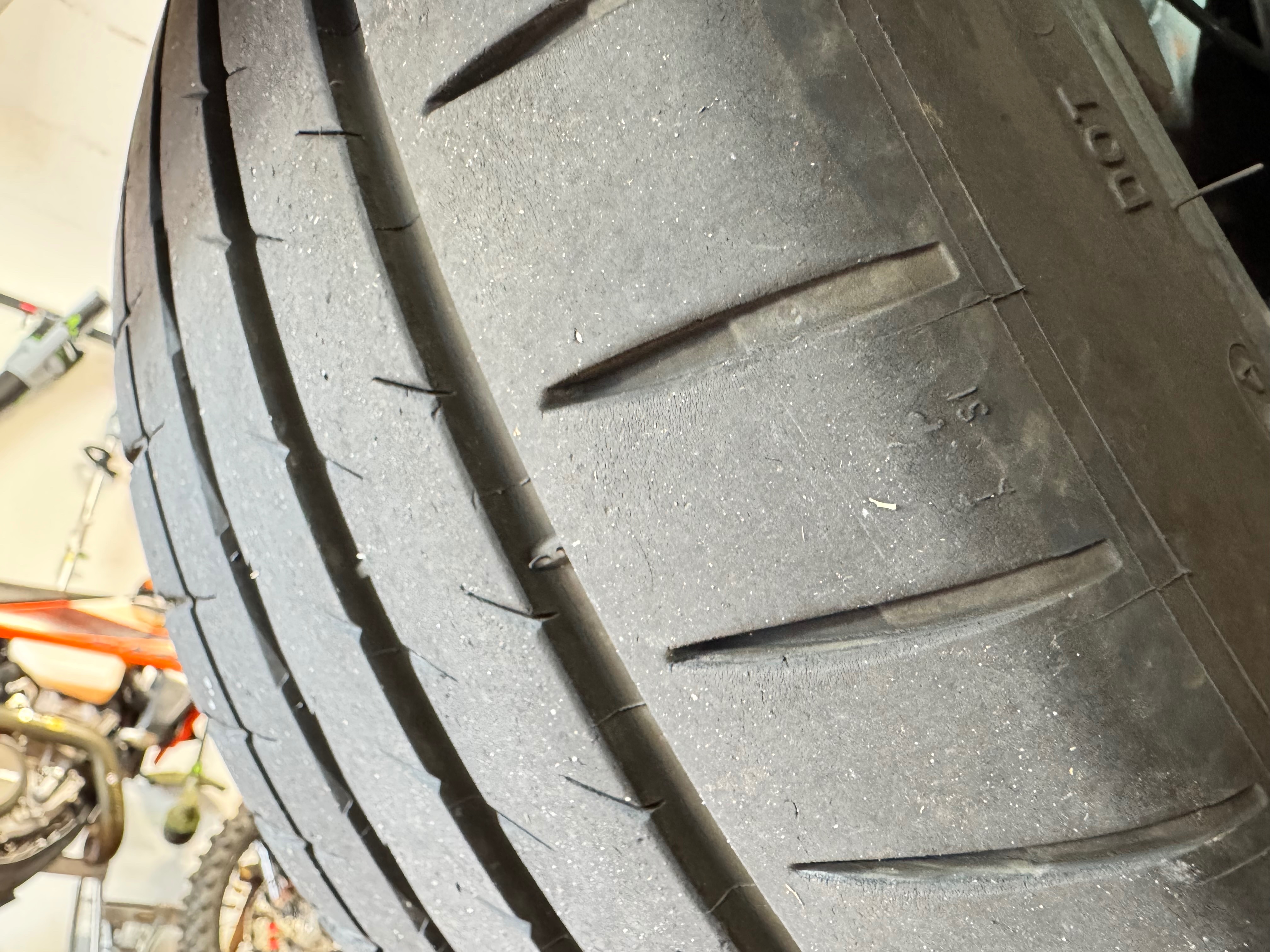

Just did my first oil change after new tires and alignment (7500mi) and it looks like the issue is still persisting. Based on previous posts it seems this is expected, but still sucks to see so much life left on the rest of the tire.
What pressures are you running? If your alignment is good and the center of the tread looks good, I just wonder if your a bit too low for air pressure?
What is the issue? Everything looks pretty good to me…
