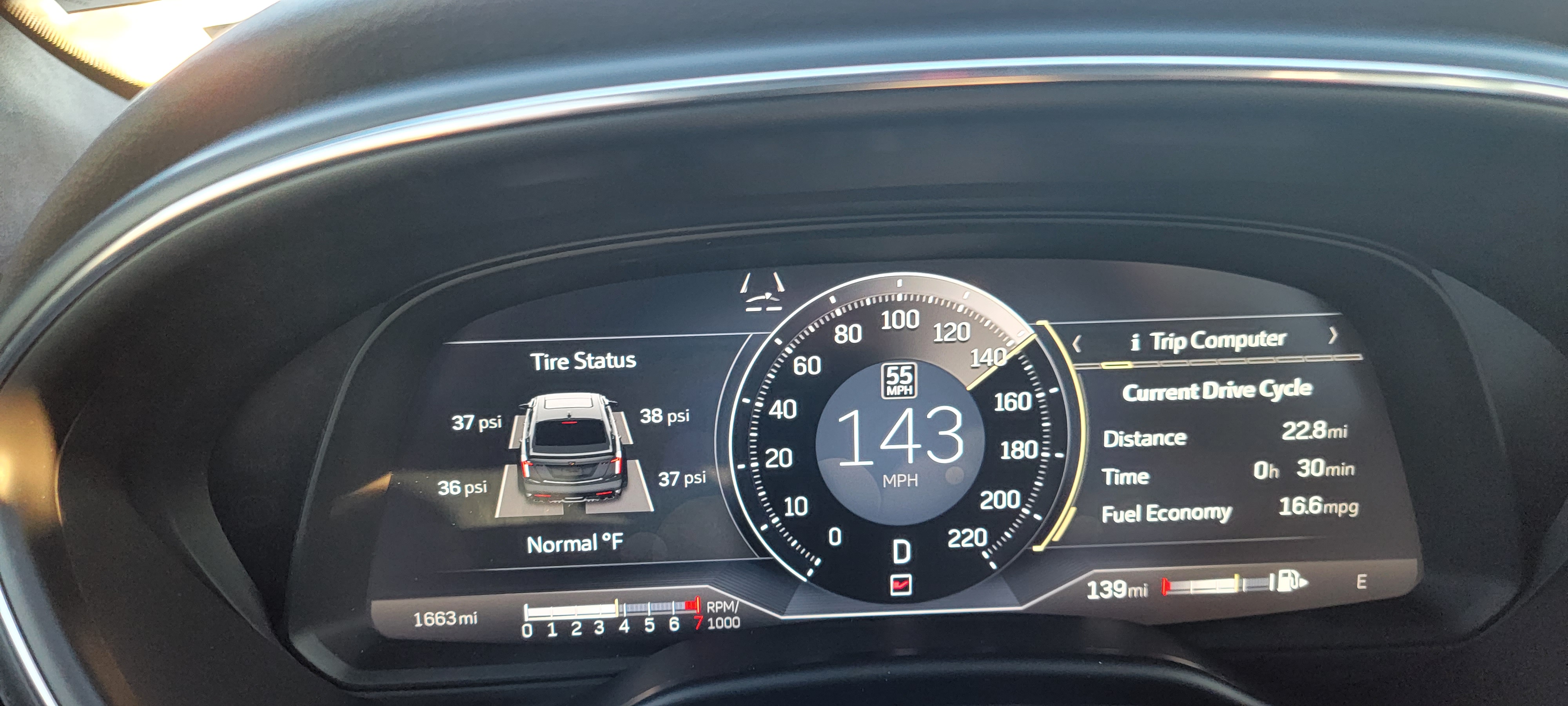

I guess you must really have some issues with drivers on the Auto Bahn ? I know when and where I can get away with it. Like along an empty beach road that is 20 miles straight and not a car in sight. So reserve your judgement for the idiots on the Jersey Turnpike that do 120+ with hundreds of cars around them. I've seen it.
All generalizations are false, but generally the folks piloting the autobahns are of a significantly higher caliber of driver than those of us here in the states. That includes the folks going slower. They get the whole lane discipline thing much better as well as reading road conditions (weather, traffic, et al).
One of the points he made that you conveniently ignored was,
while taking a photo.
Yeah. Don't do that. I agree with him. Stay in NYS please.
What are you talking about sir?^^^^ I'm confused. ;)
So because there are other dip shits that means it's ok to be a dip shit? Fuck off with your 143 mph selfie. That is some dumb ass shit right there, no matter what road you are on.
