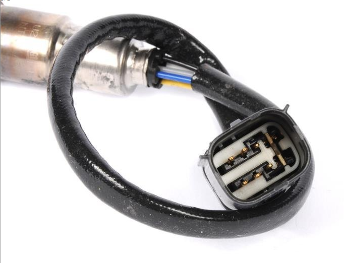

Since both sensors are in tough to reach and blind spots, how do the connectors go together?
There seems to be a lock tab that clicks open but then where would you push on to get the connectors loose?
If there is a diagram or pictures of both the male and female side that would be great. I have found pics of the O2 Sensor that shows the sensor side but not the hardess side. Here is the pic from Rockauto when i look up the replacement:

But I followed the O2 Sensor wire up towards the head as best I could as my hand barely fit in there where I can grab and move things. And it seems the connector itself is actually located on the Rear of the head, in between the firewall and not the one on the side that they show in the pic.

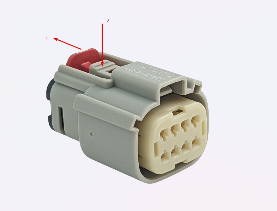

Maybe this will help. This picture is the same connector. First (1) slide the red lock back, then second (2) depress the tab to remove. Hope that helps!!
