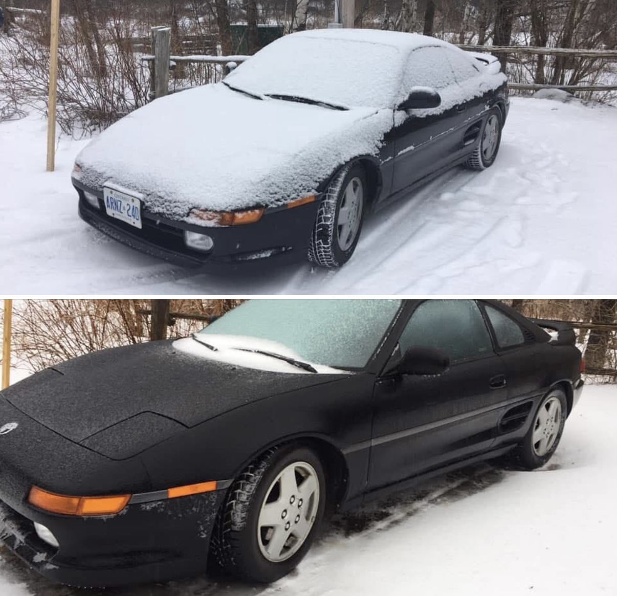

If you don’t mind, I’m going to briefly applaud my own forever car, a 32 year-old MR2, with these shots taken a few winters ago while visiting our in-laws in Quebec:
Where, by the way, winter rubber is actually a matter of law, December to March.
Full disclosure: I never leave it so brutally exposed to the elements when it’s at home in relatively balmy Toronto.
Here, it’s usually parked in the garage, as I don’t take it out during or immediately after major winter storms, just in dry weather or on milder winter days.

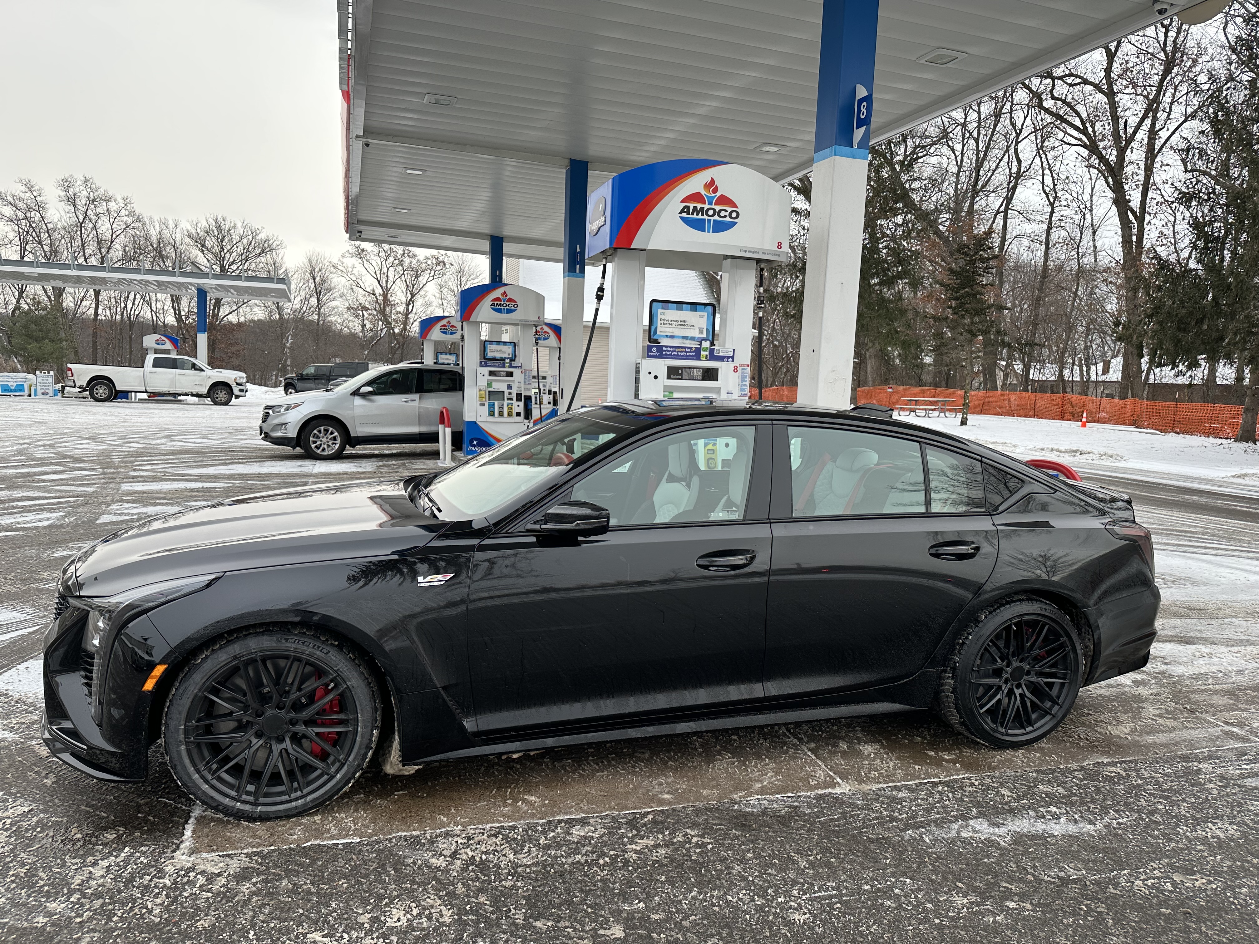

Not a deal killer, the winter set actually looks nice and much better than I thought it would. Had some fun today in parking lots get the feel of the PA5’s traction with nanny’s full on and partially off etc.

Are those the tech bronze wheels? But paitned black?

What are the wheel/tire specs you used?
