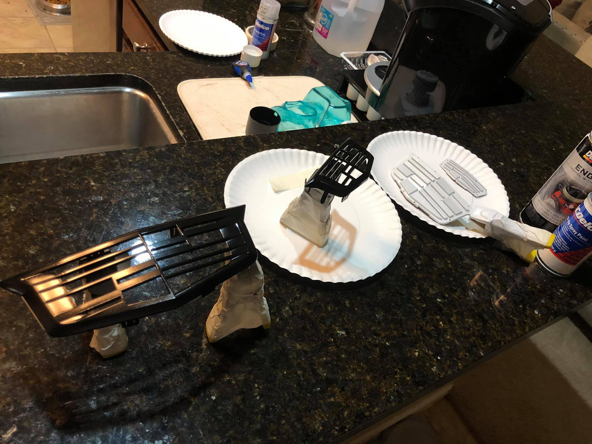

if you remove the two sided tape, you will see the plastic parts that line up where they come together.... use a Dremel and Dremel away at reach one.... the chrome grille will detach from the rest of it..... you can then paint each piece separately. I've don't it on all of my personal Cadillac's
They might be hard to find because I have my parts dept constantly restocking them ;-)
wife's XT6 badges below while painting....
So is this the same for the badge that contains the adaptive cruise distance sensor? Can that be done without affecting the sensor's operation?
no. only the badge without the sensor
