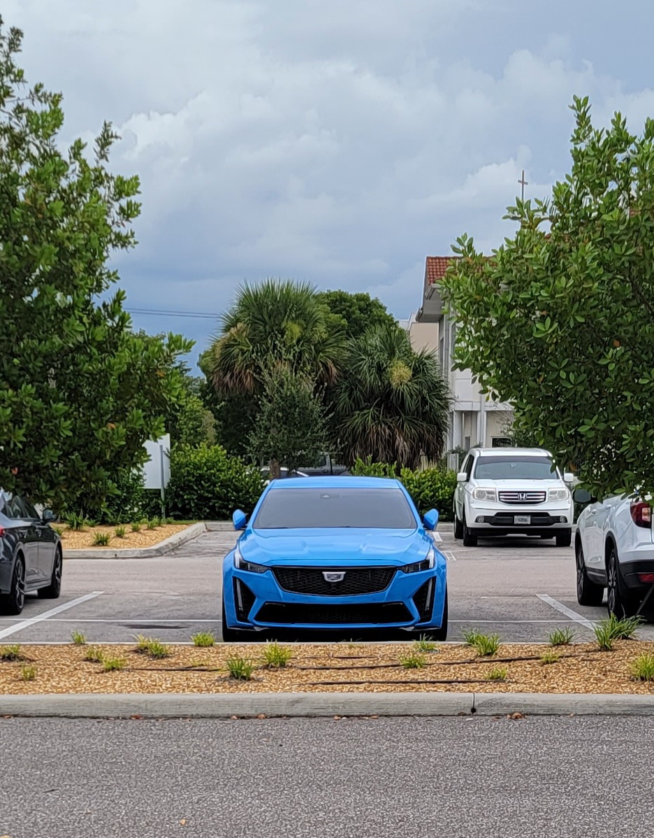

CT5-V BW Monochrome emblem
The front is easy, stick your finger through the grill and pop off the side piece then push the badge forward. Get a small flat head and then push the 4 top tabs down while applying pressure and then the whole thing will pop out, didnt break any tabs on the factory.
