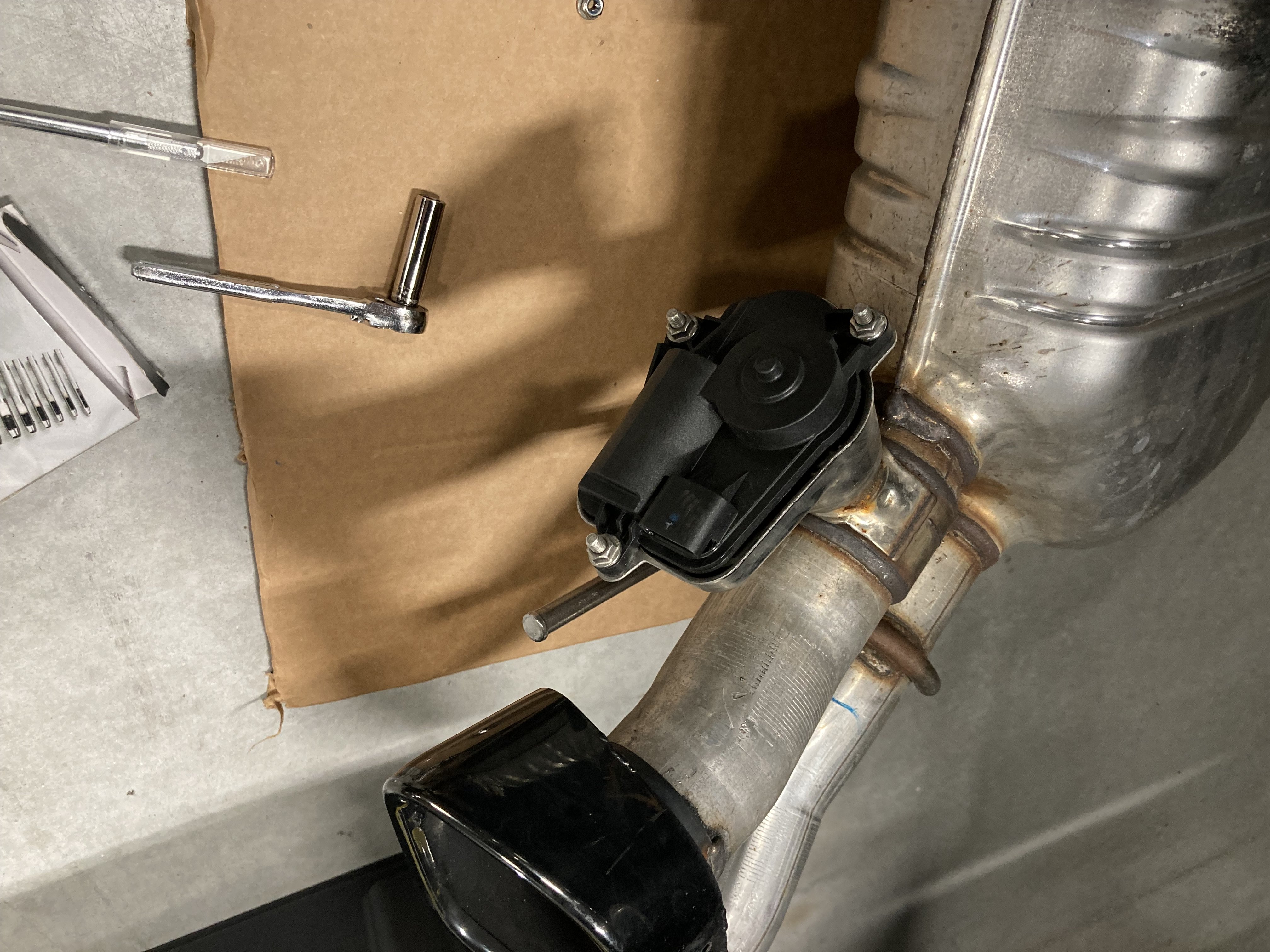

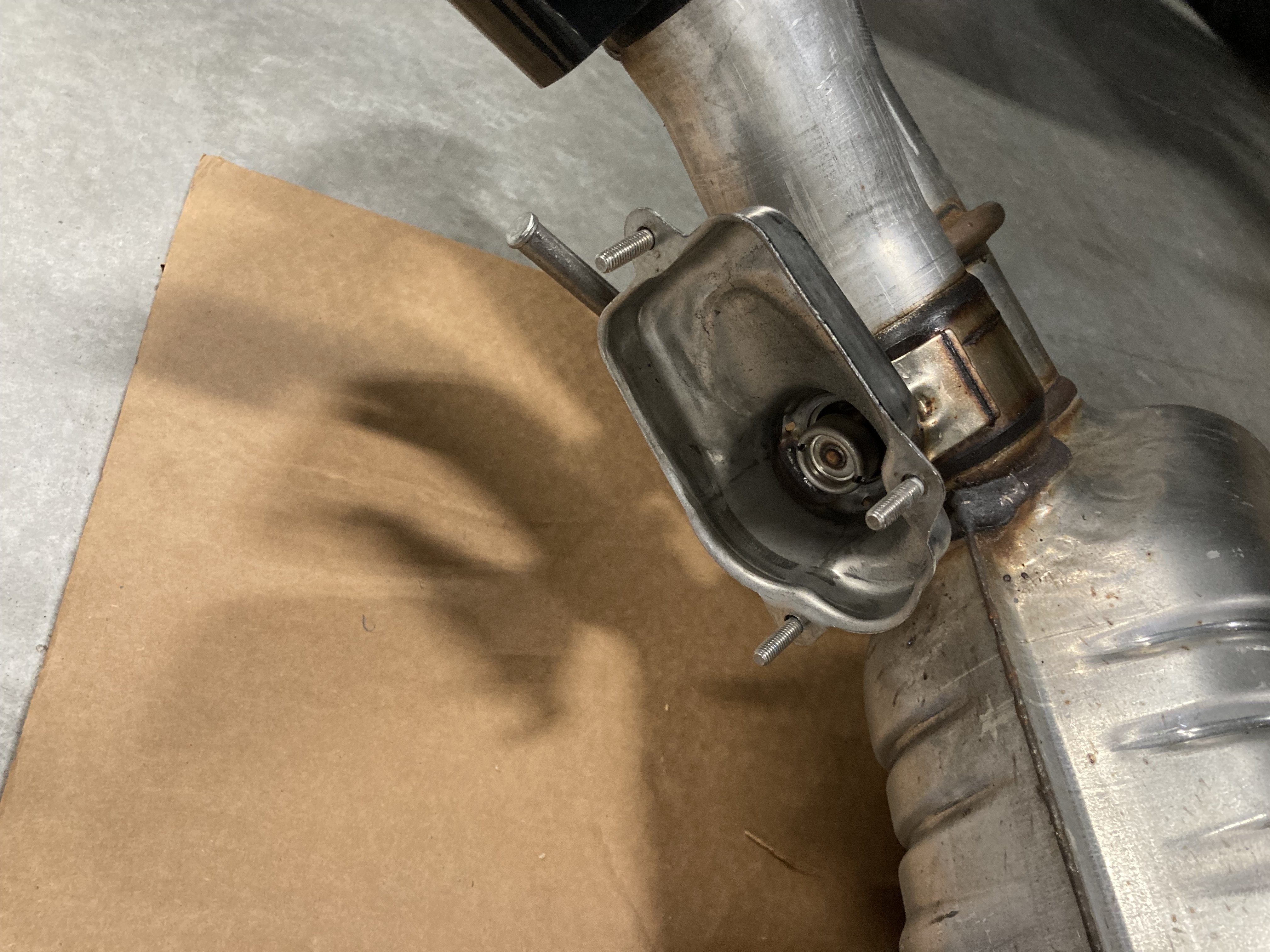

Here is a picture of the valve in place and then removed. There is a coil spring that goes between the electric motor and the mechanical part of the valve. The spring is not shown in the picture. It seems that the spring is designed to keep tension on the valve, so it doesn't rattle. This is on a 5BW but I'm guessing it would be the same. Hope this helps.

Is this the same rattle everyone is talking about?

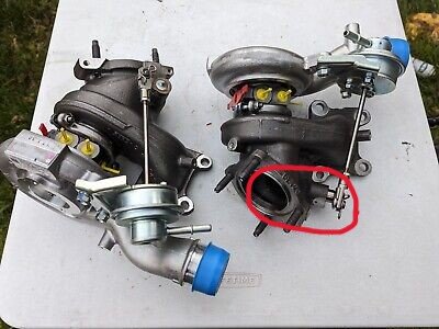

No, thats the wastegate squeel. People have replaced turbos under warranty for it and it came back. My guess is the housing hole for the wastegate flap shaft isnt smoothly bored.

Thanks for input, mine is definitely up front underneath. I think it’s the watergates these are famous for. Likely will just deal with it instead of having turbos changed to have it come back anyway.

There’s a fix that’s hard to find but there’s a TSB somewhere to use spring cup washers or something like that and it keeps tension on the wastegates and fixes the rattle. That’s how they fixed it on my ATS V. It went from sounding like I was dragging tin cans to gone. If you do some google searching you might find it in some of the threads.
