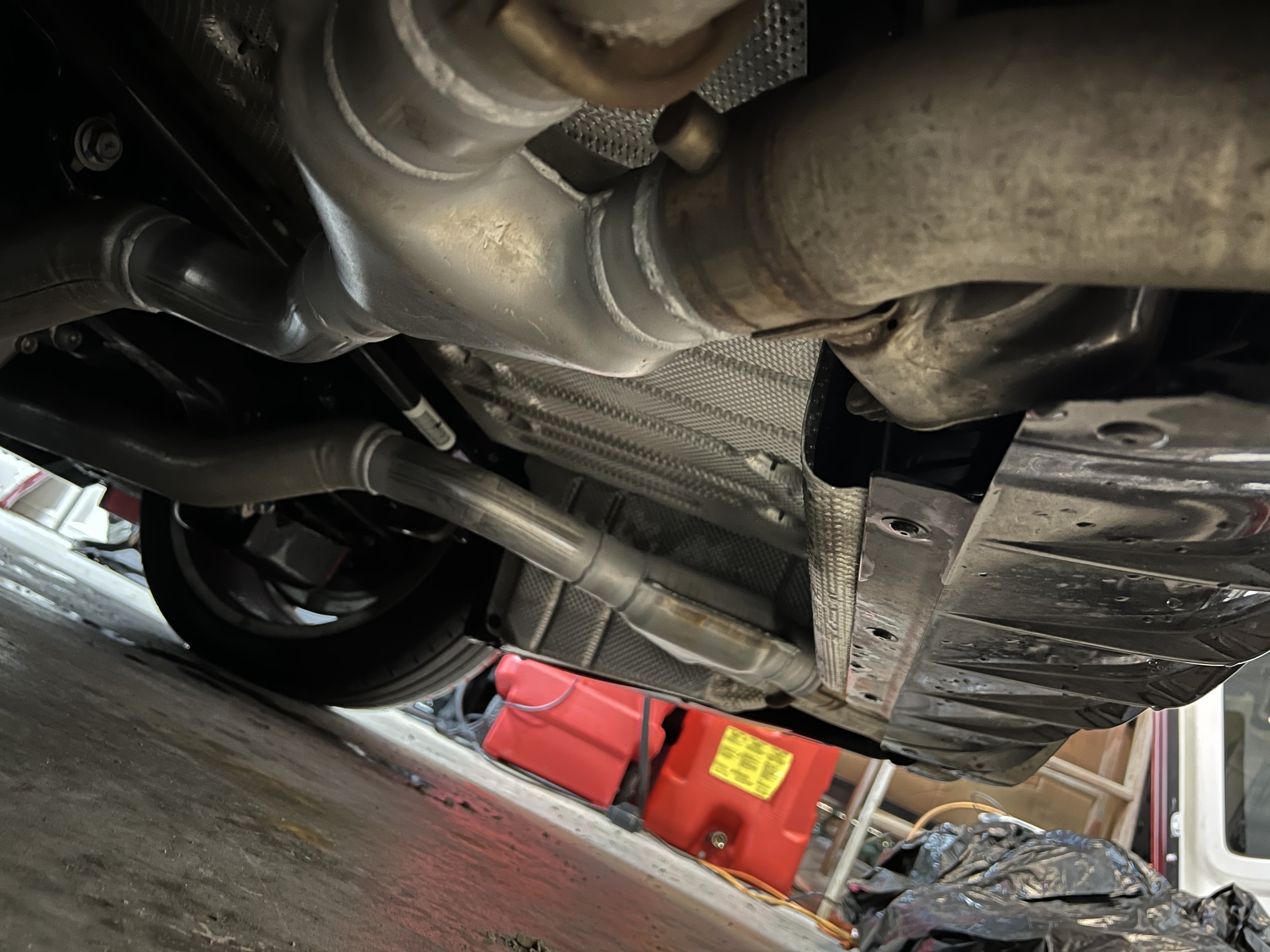

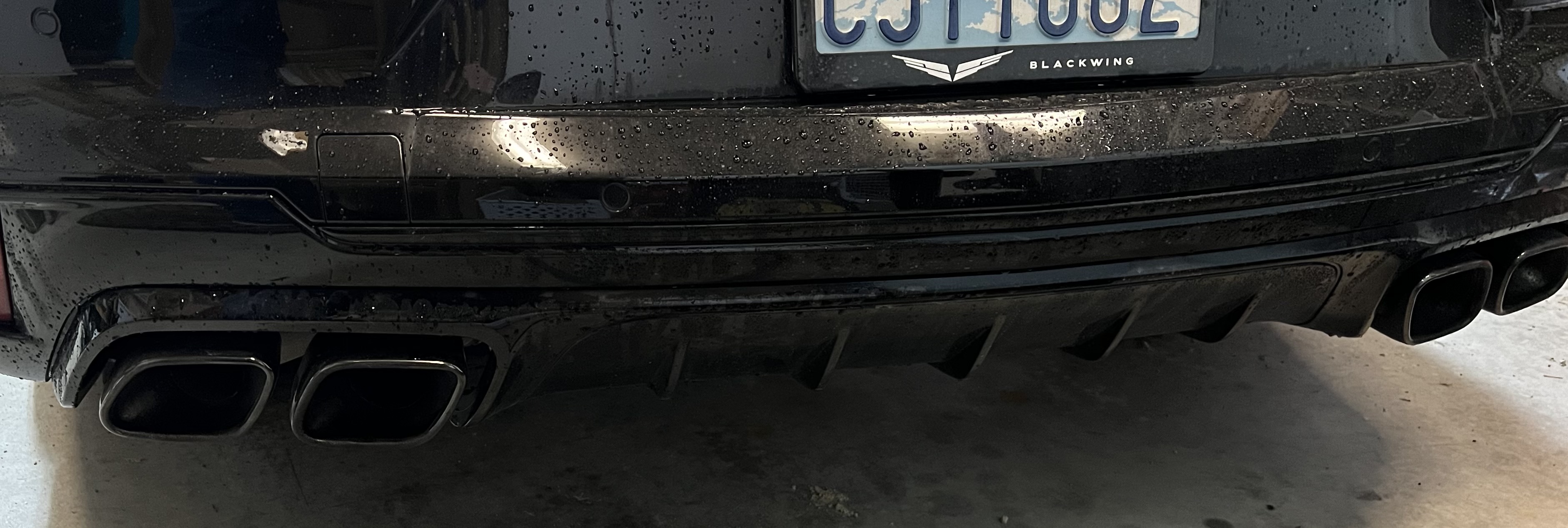

Well as requested I'm reporting back after just picking up the car. This is it!! This is how I think this car should have sounded from the factory. There are all sorts of vids with the sound of the mod but it really is hard to hear it that way. It will be hard to talk about how much louder it is but here is something you can probably get the jist of the change from. In stock form on race mode that is now the sound I get while in tour mode but with a verys slight bump up in decibals. Now when it track mode you know it for sure. I would recomend this muffler delete to anyone who is unsatisfied with the stock exhaust note. Before doing this I was planning on doing dp's too but now I won't do that until much later down the road if I get the ECM unlocked for a full tune. I think the dp's with the muffler delete would probably get into that obnoxious range. I feel like I found the sweet spot with this mod!!
How can you post with no pictures? What did it cost you and are you happy with the quality of the installation. Inquiring minds and all that,...
Pretty simple process. They kept the stock tips with valves and just added pipe to delete the muffler. The guys did great that did the work. My biggest concern was not ending up with caddywompos tips. They were sure to weld them together before removing the unit to keep the stock look. Best $550.00 mod I have done to the car!
View attachment 24553View attachment 24554
