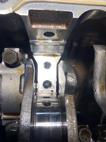

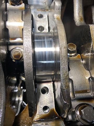

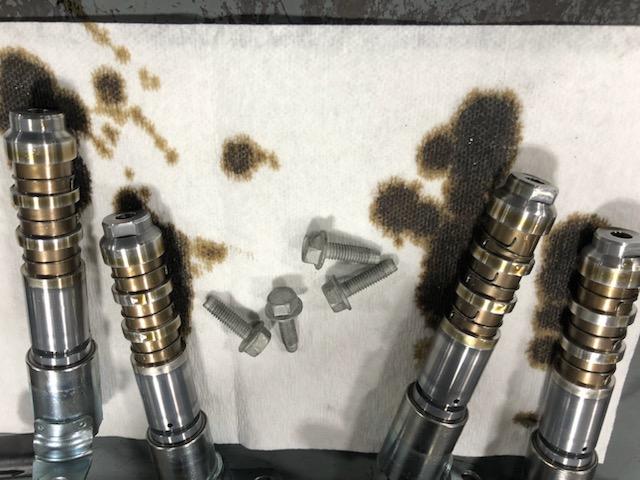

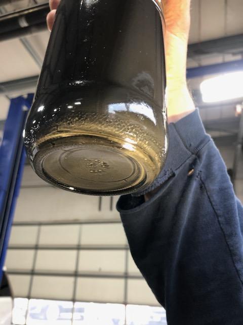

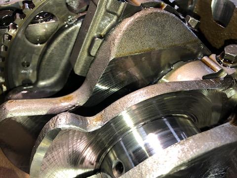

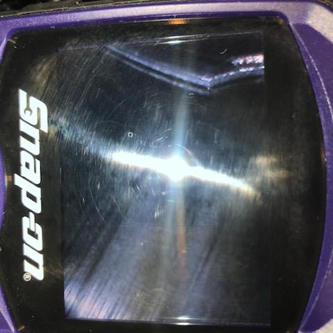

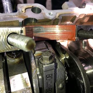

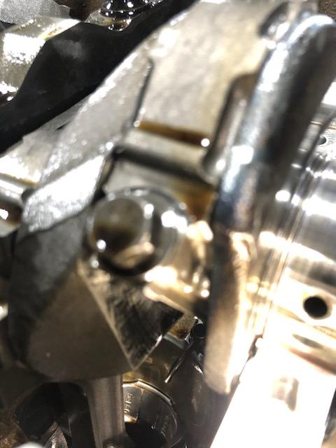

Pics as promised... I have no clue what to look for but even I can see some carnage in there

Pic 7105 is the money shot insofar as the bearing shows uneven wear through layers of babbitt material. That's the stuff of nightmares. Great to hear your back on the road. Good luck with it.
