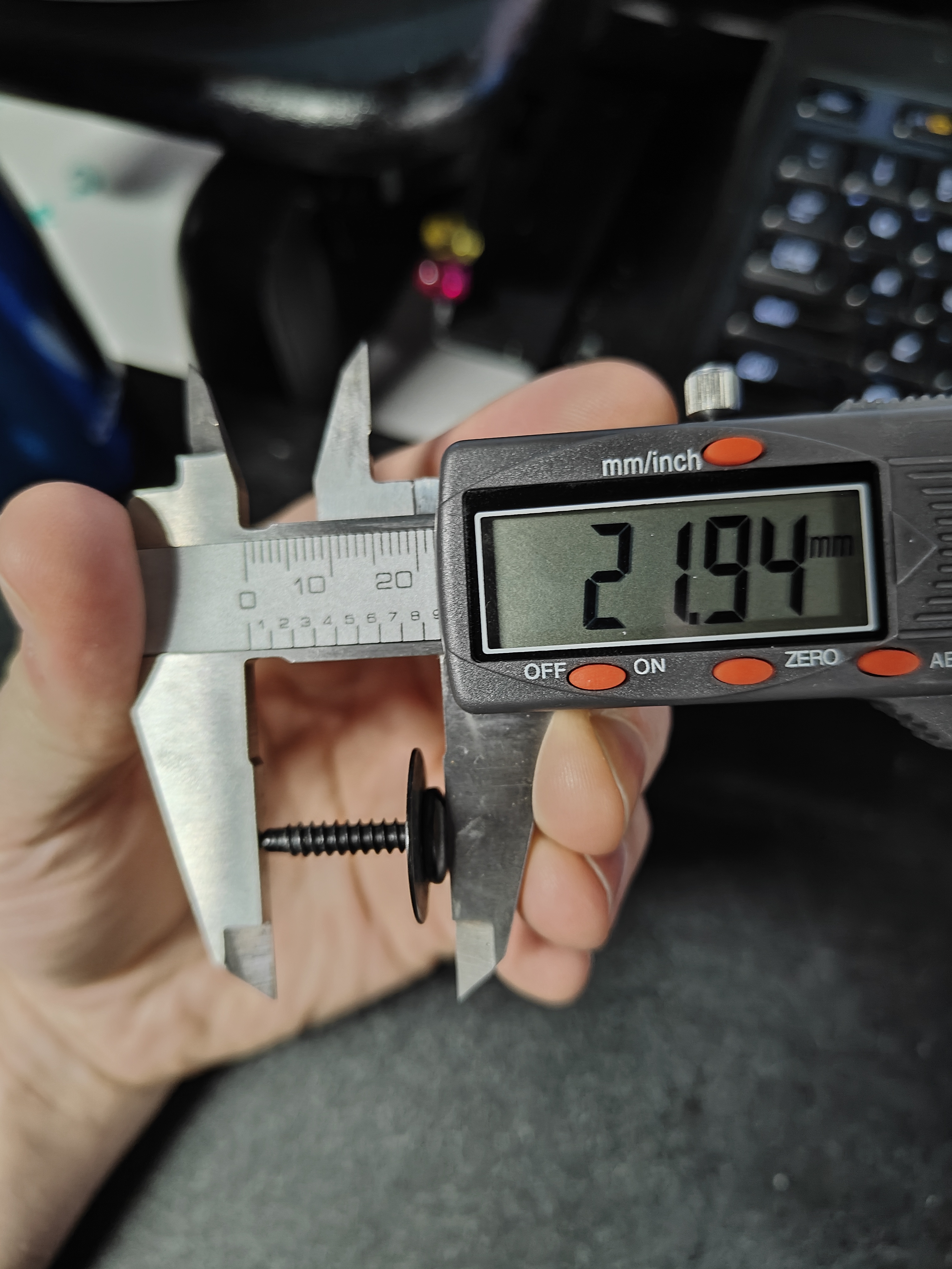

@WONT TAP can you confirm the length of bolt used to bolt the wheel deflectors through the front splitter and to the bumper? The stock mounting bolts are missing from that position for non cf cars and a bolt for the front splitter that is 22mm total length is too short to work. Parts diagrams dont show bolts for that or the wheel deflectors in a diagram. I'm assuming I need a bolt with an overall length of 25 or 30 to secure it but wanted to have that before the parts I ordered from you arrive. Thanks!

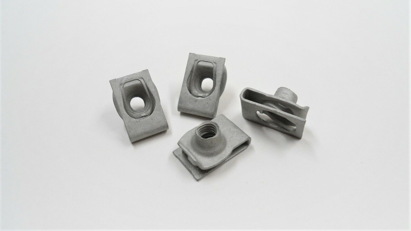

I think the screws I posted and used to secure the splitter are correct, but non cf cars aren't shipping with the speed nut clip at the edges. I ordered some of these to be safe.

Front splitter won't need anything additional, all the screws and clips will be reused from the removal of the black splitters. I went through that a bit in the cf p/n thread. For the wheel deflectors I think it'll be the same m4.2 screws but cannot confirm. I ordered a pack of 10 of the speed nuts and same sized thread bolts off eBay. If they work I can send some spares to you for the cost to ship. It was $20 for the whole lot and the individual nuts and screws were ~$6 ea.... If you don't want to wait a week or so, the screw should be GM M4.2x1.41x20. you'll need to find the nut that has that thread. I think I ordered this p/n but not sure if it's correct -11548579

Our technician just took a look at these. He believes the screws are all the same length. You would just need the screw clips. You could check with a dealership parts department to confirm.
Went to the parts department and they confirmed part numbers.
Speed nut - 11548579
Bolts - 11548270
The speed nut and bolt are both around $13 PER PIECE from the dealer. Insane.

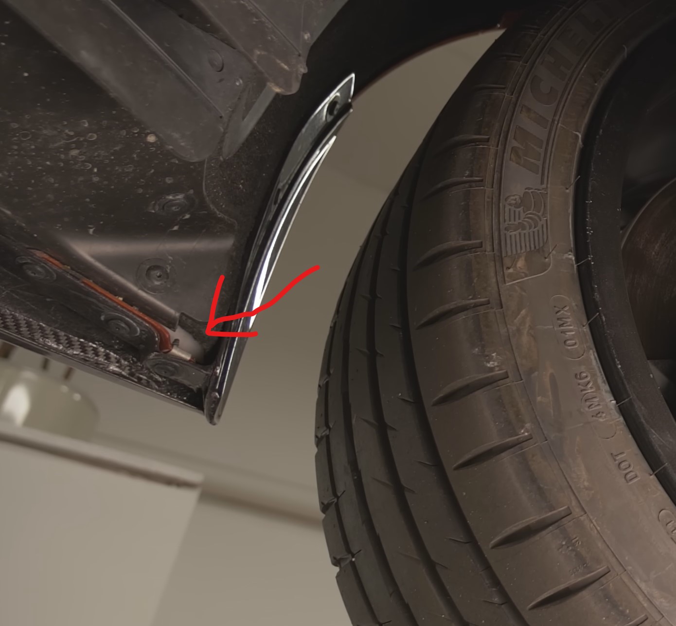

Update. The screws and clips I ordered work to mount the wheel deflectors. I have 4 extra pairs of anyone needs them, just pm me. Probably be the $6 or 7 it costs to ship. I also have a pack of 25 of the screws if anyone needs a spare one or 2.

Where did you get the screws and clips and how many are needed on each side?
