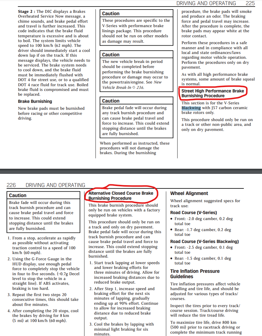

Why does my 2026 manual have a far more gingerly procedure? Did pad materials change? It basically says at the end “but do it the old way if you have to”

Looks like this procedure is for corrosion cleanup as opposed to bedding in new pads. Thus the less aggressive nature.
