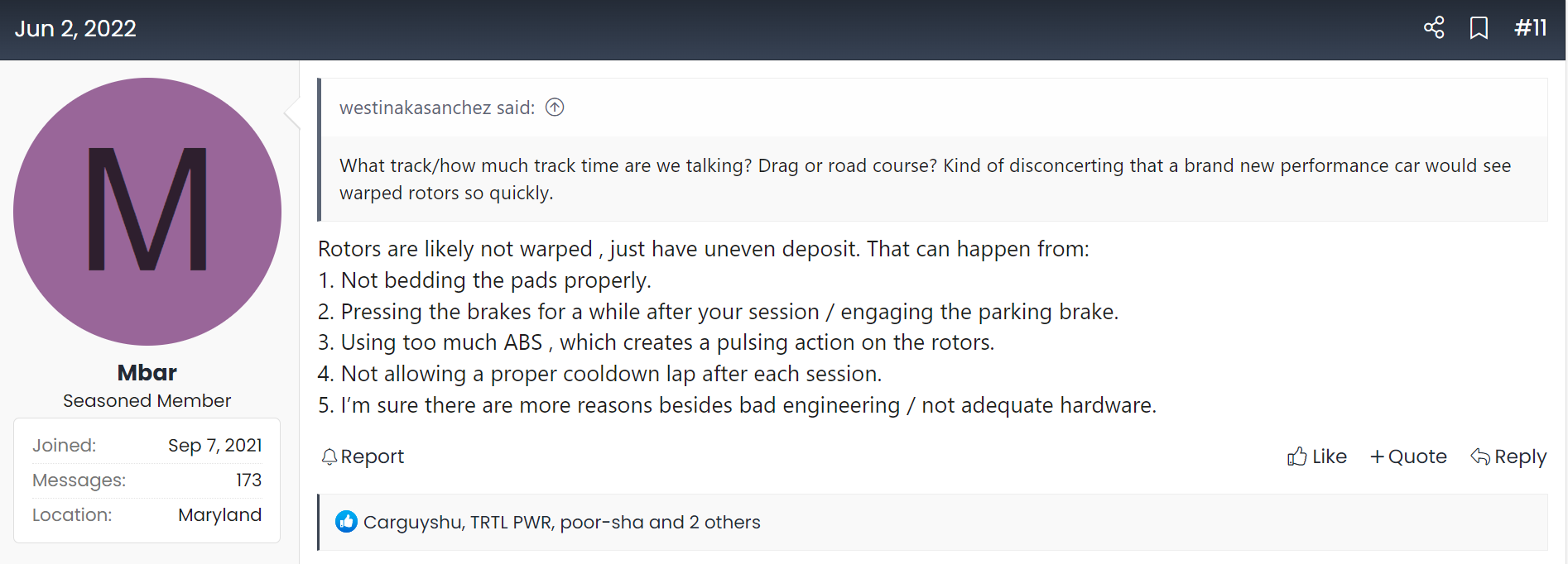

Note that I am not the only person suggesting this state and or solution:
This screen capture is from the forum Thread - ct4 v blackwing upgraded rotors.

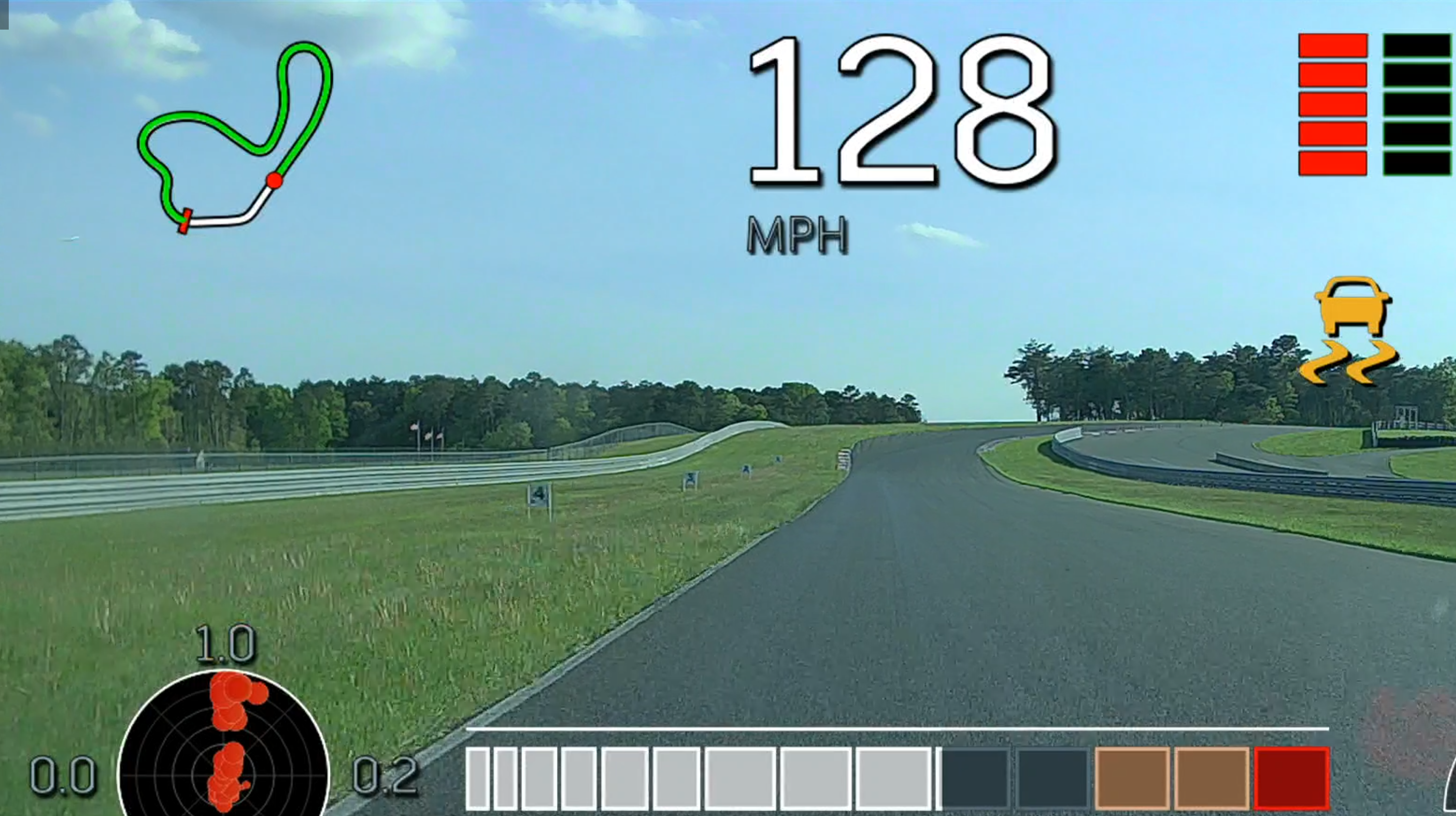

I experience brake vibration after 3 track days - approx mileage 5K. Three dealers stated that I had "warped rotors" due to track use and that the rotor replacement was not covered under warranty and would be in the $2500 range.
After two track days using EBC SR11 brake pads, the significant brake vibration during medium to hard braking that I was experiencing has been corrected.
Therefore, my issue has likely caused by heavy ABS braking using the stock pads.

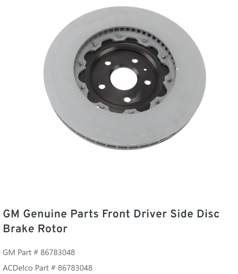

Currently, GM is selling the rotor as a complete unit - Hat and Disc.

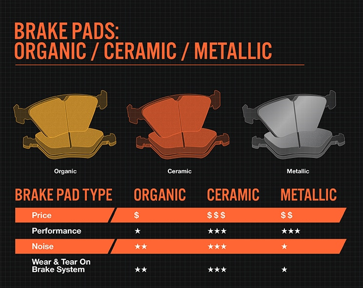

Sintered brake pads are a type of brake pad commonly used in high-performance and heavy-duty applications, such as racing vehicles and motorcycles. They are made from a combination of metallic particles and other materials that are compacted and fused together using heat and pressure. Here's how sintered brake pads work:
  • Friction Material: The main component of sintered brake pads is a mixture of metal particles, such as copper, bronze, iron, or steel, combined with other additives. This mixture is designed to create a strong and stable friction material that can withstand high temperatures and heavy use.
  • Manufacturing Process: The raw materials are mixed, compacted, and then subjected to a high-temperature sintering process. During sintering, the metal particles are fused together, creating a solid and porous structure with uniform friction properties.
  • Braking Action: When you apply the brakes, the brake caliper squeezes the brake pads against the brake disc (rotor) on each wheel. This action generates friction between the sintered brake pads and the brake disc, converting the kinetic energy of the moving vehicle into heat energy.
  • Heat Dissipation: Sintered brake pads are specifically designed to handle high levels of heat. The porous structure of the material allows it to disperse heat effectively, preventing the brakes from overheating during intense braking situations, such as repeated heavy braking or driving downhill.
  • Consistent Performance: Sintered brake pads provide consistent and predictable braking performance over a wide range of temperatures. This characteristic makes them ideal for high-performance vehicles, off-road use, and situations where braking conditions may be more demanding.
  • Durability: Sintered brake pads generally have a longer lifespan compared to other types of brake pads, like organic or semi-metallic pads. Their robust construction and ability to withstand heat contribute to their durability and resistance to wear.
  • Brake Dust: One downside of sintered brake pads is that they tend to produce more brake dust compared to organic pads. This is due to the metal particles and abrasive nature of the friction material.
Overall, sintered brake pads are an excellent choice for high-performance and heavy-duty applications where consistent and reliable braking performance is crucial. However, for everyday driving or less demanding conditions, organic or ceramic brake pads may be preferred due to their quieter operation and lower dust generation. Always consider the specific needs and requirements of your vehicle and driving style when choosing the appropriate brake pads.

I had 3 track days where I was doing hard stops from 125MPH+ when the brake vibration issue started. The ABS system was engaging. I am not sure that the C&D test car has been doing this type of driving, certainly not with that gas mileage.

This second shop is also recommending replacement and is quoting the same price. Pads are at 4mm, and "hotspots are worn into the brake disc. Heat spots will cause noise with new pads."
They are quoting labor as $472.50 and parts as $2697 (rotors 999 each and pad set 699), to replace front rotors and pads.
Maybe I am getting into stupid question territory but is it correct that I will need:
Rotor - Right
Rotor - Left
Front Brake Pad Set
Even if I pay $100 in shipping that brings my parts cost down to $1775, reducing my total by over $900
Thoughts?
