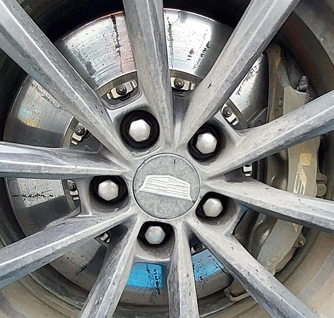

Well, I did order them but I've had other projects over the holidays and just have felt like doing it. So I don't have any updates. Plus, my rotors now look like this from all sticking they've been doing. Surprisingly I don't have any vibration yet when the brakes are applied but that'll change. I may make time this weekend and get them changed out.

I replaced the OEM pads at about 600 miles with Z26 PowerStops for dusting purposes and I have not had this problem. However I park in a level garage and have an automatic, that likely has never had the parking brake on. Are the pad outlines the brake pad or the parking brake outline?
If you're talking about the picture of my rotor, that's my front rotor.
