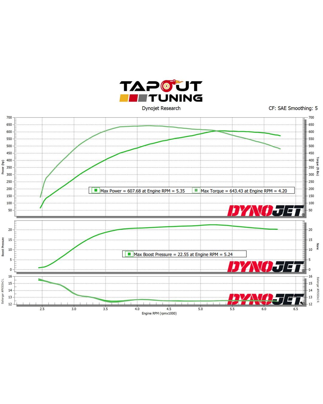

Second chart is Purple Belt with ethanol fuel blend. Note the 600 plus whp from 5,200 to 5,900 rpm, right in the meat of the power band. At WOT, it pulls HARD and non-stop.
