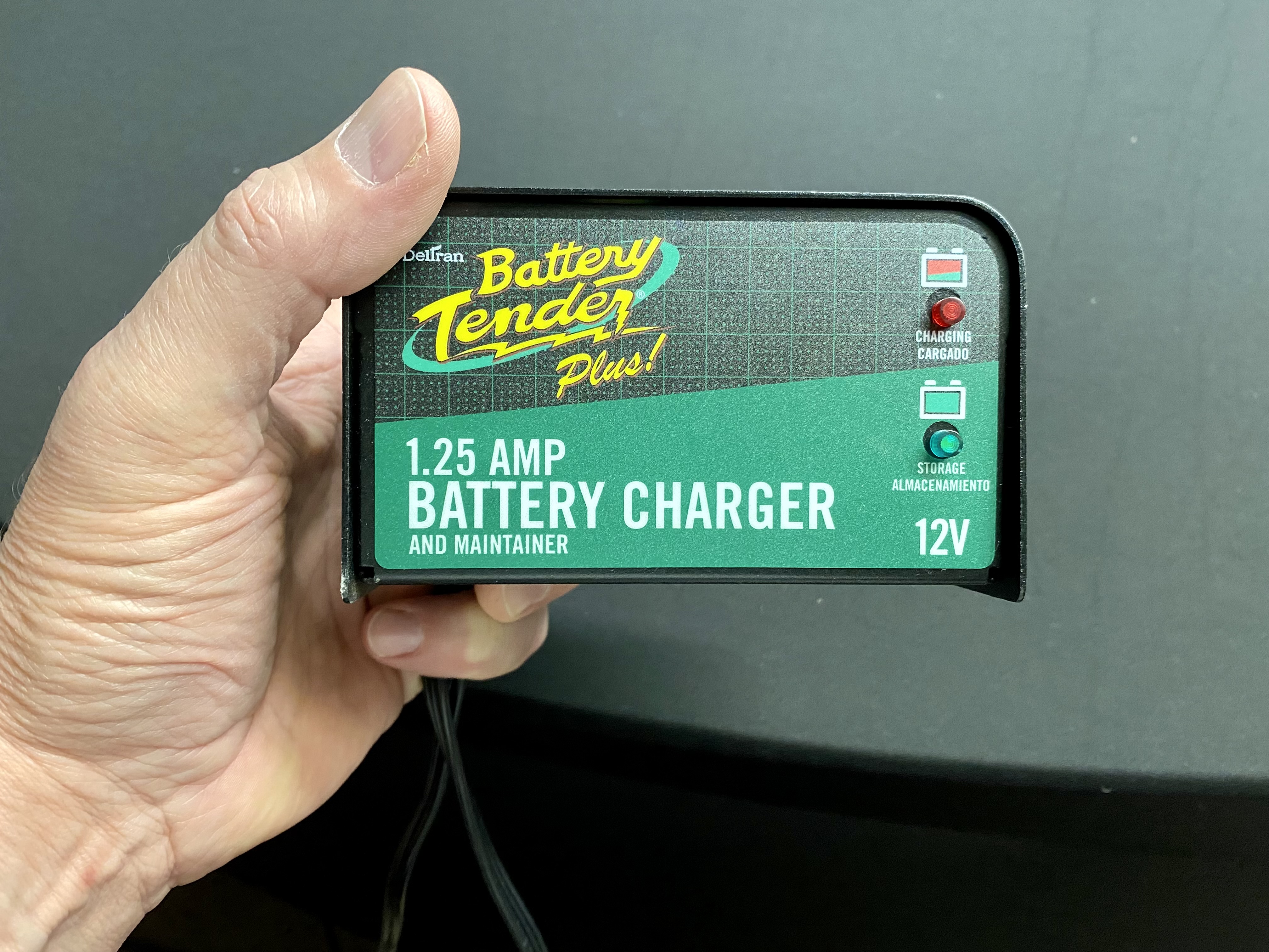

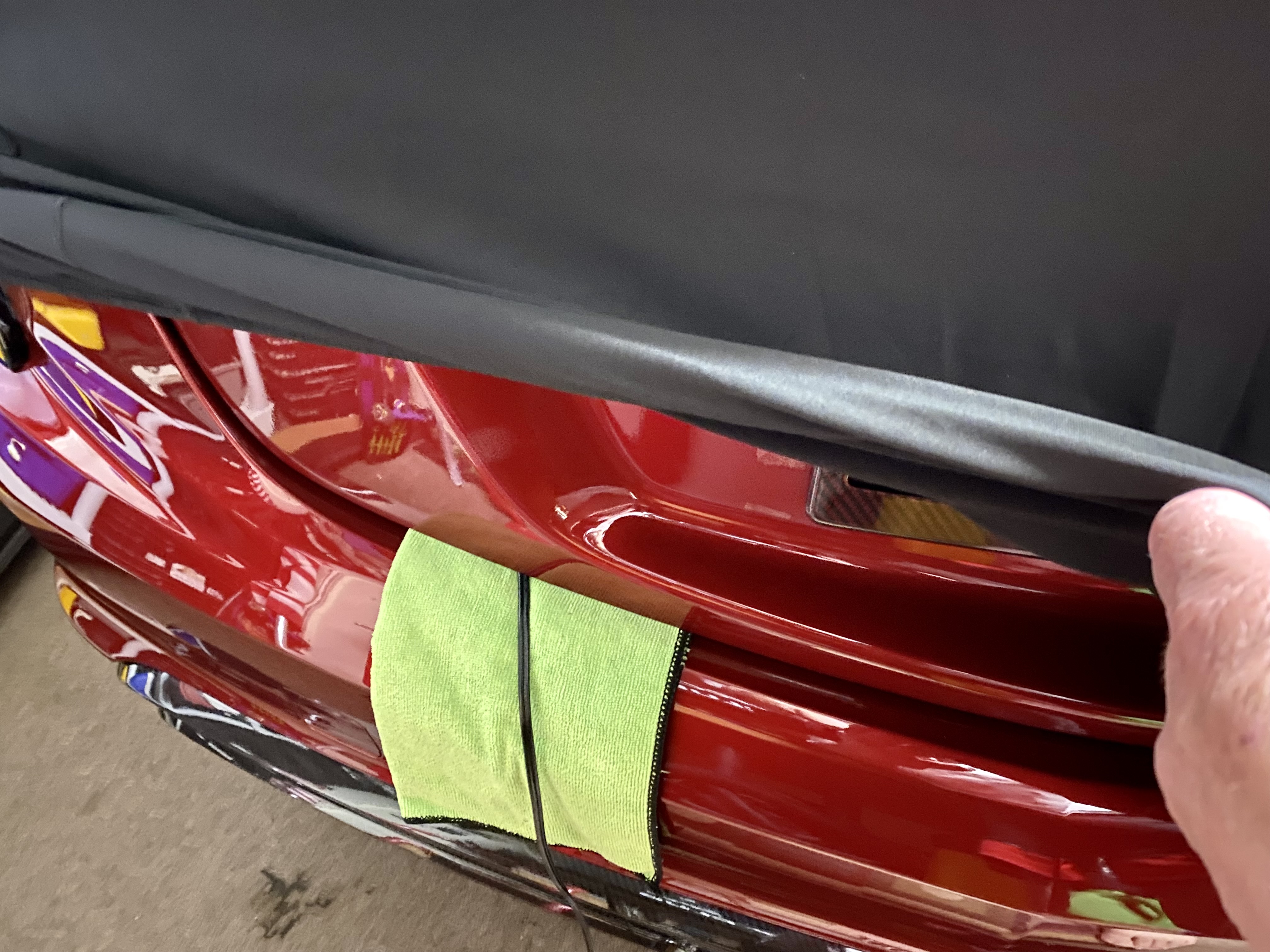

This is my setup and it's worked for me very well...

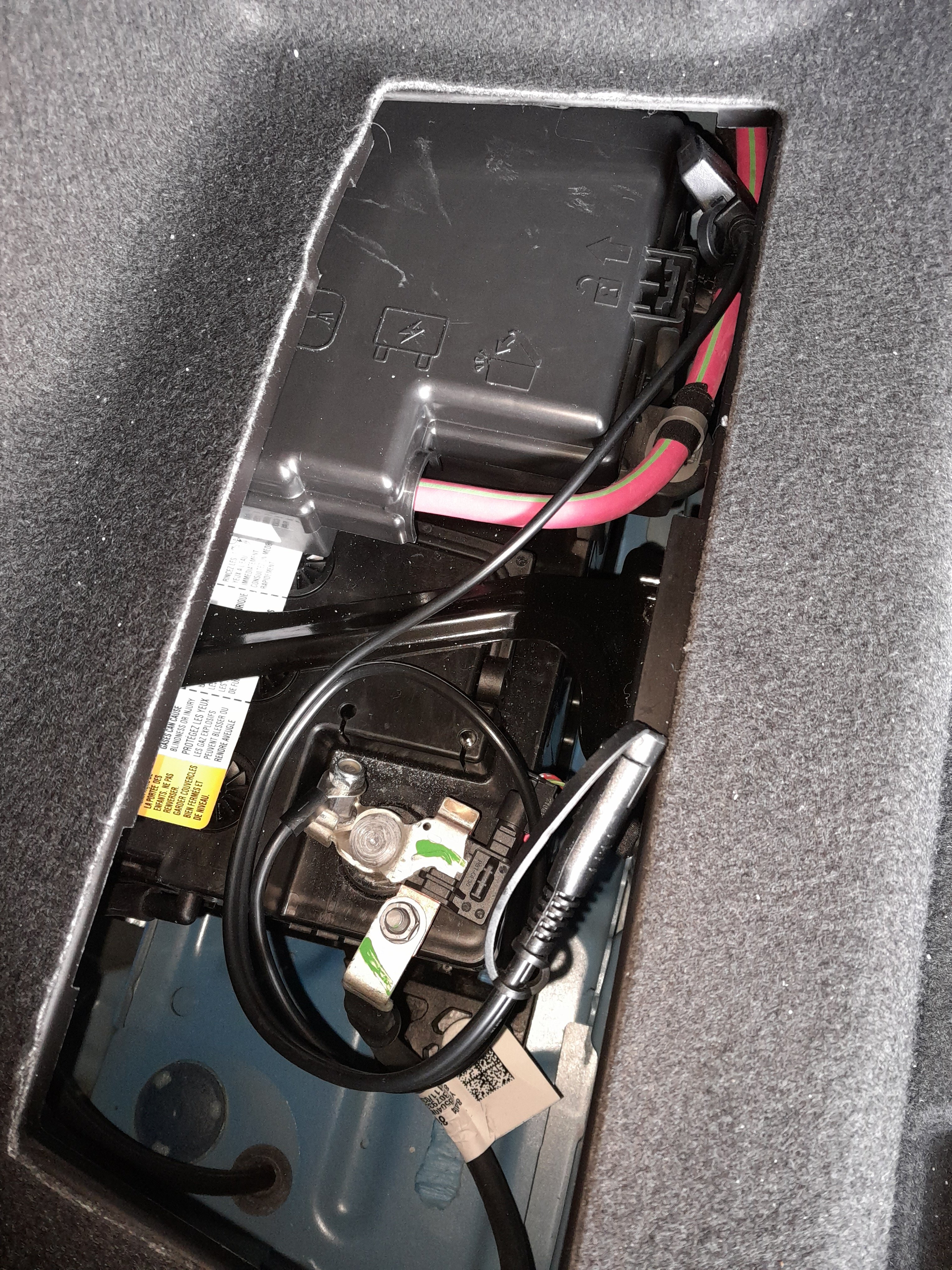

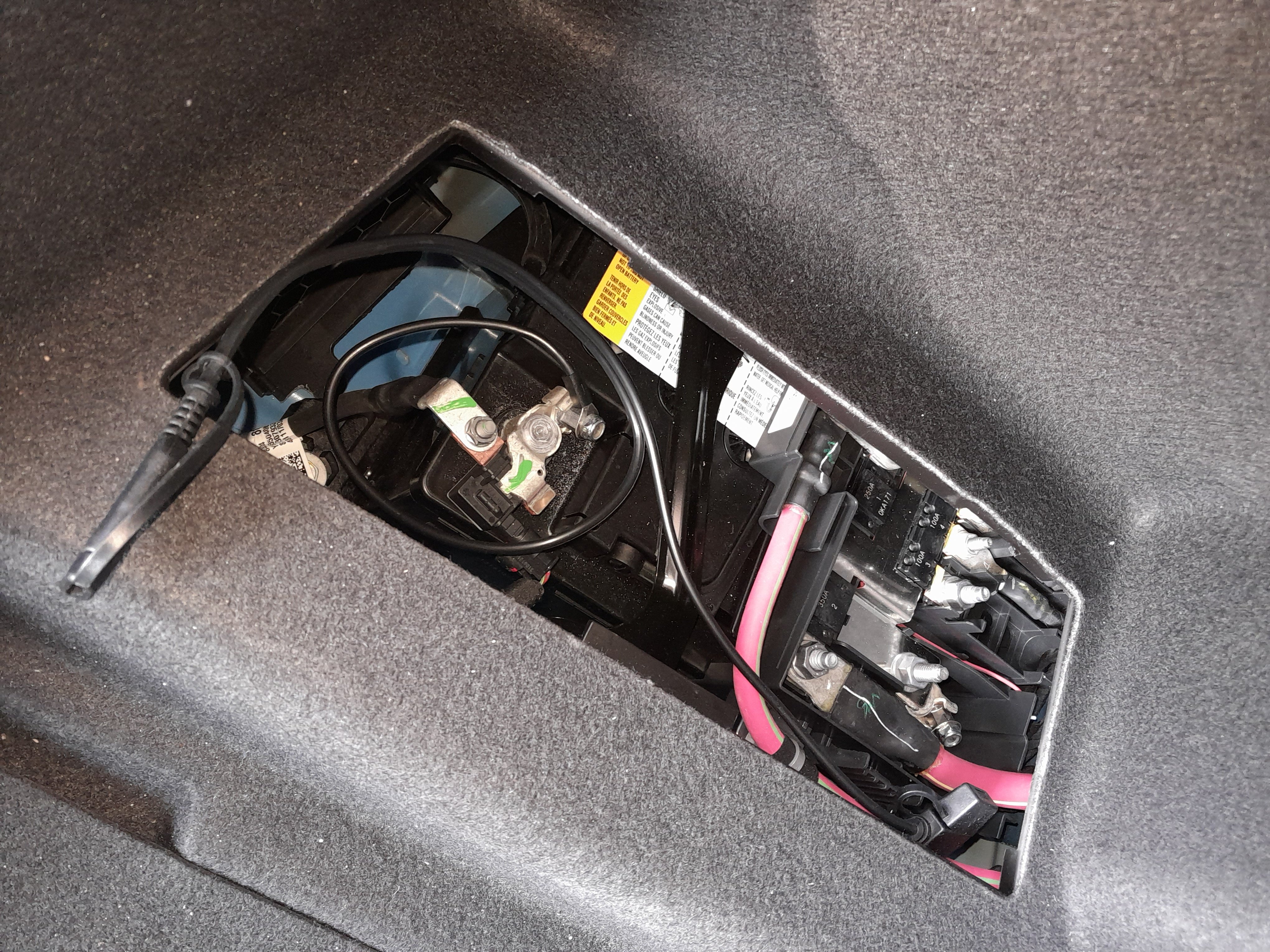

Here's pics of my install. I went right to the battery posts themselves. I just matched the thread on the oem bolts and got 2 extra nylon lock nuts. I did trim a tiny area/corner of the black plastic cover to allow the wire to come out without being pinched or rubbing.

I'm going through this process right now as well. I believe its best to connect any tender directly to the battery terminals, unfortunately the positive terminal is shrouded in some overly complex plastic work.
Judging from the photos some of you have had luck removing the top plastic cap off that terminal shroud without removing any interior trim panels?
I had to mangle the interior fabric trim a bit to get the plastic top cover off. I also have small hands which helped. I had to super glue the fabric trim back onto some plastic frame after I was done. Way easier to get plastic top off with fabric trim off, but guess it’s up to you which path you want to go.
