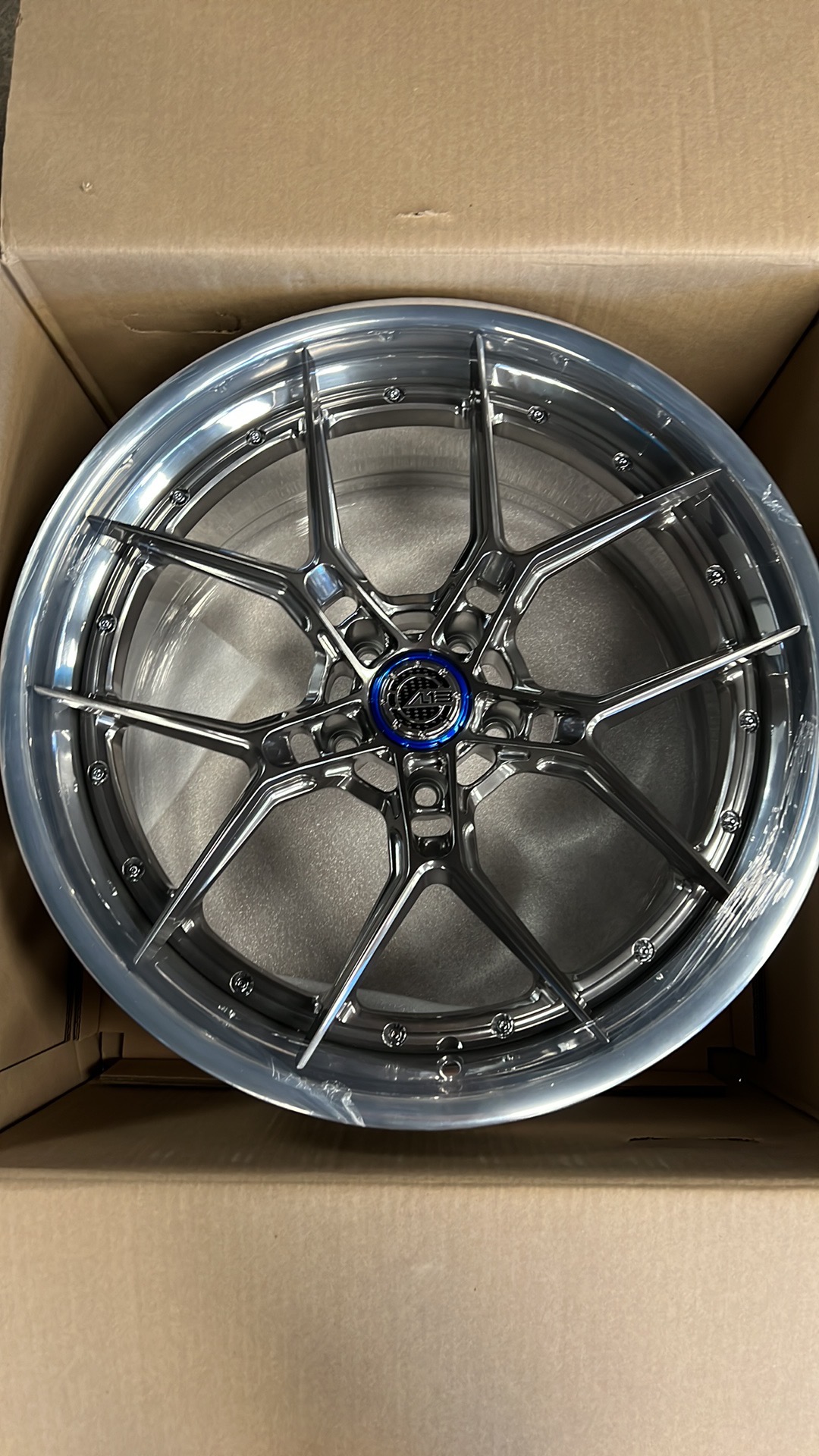

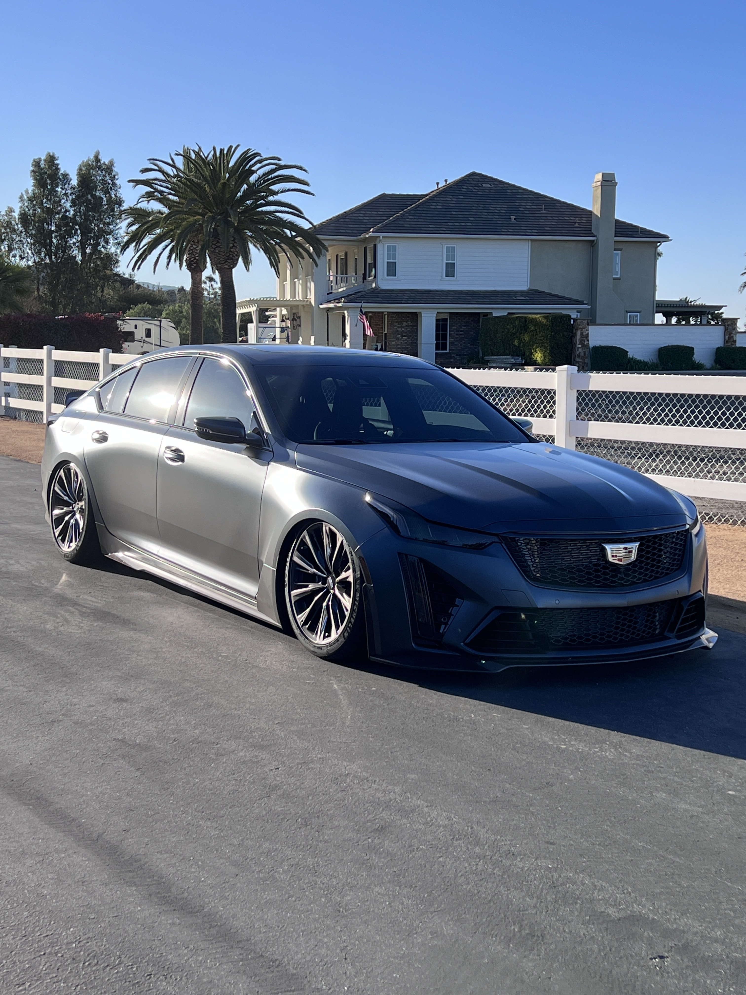

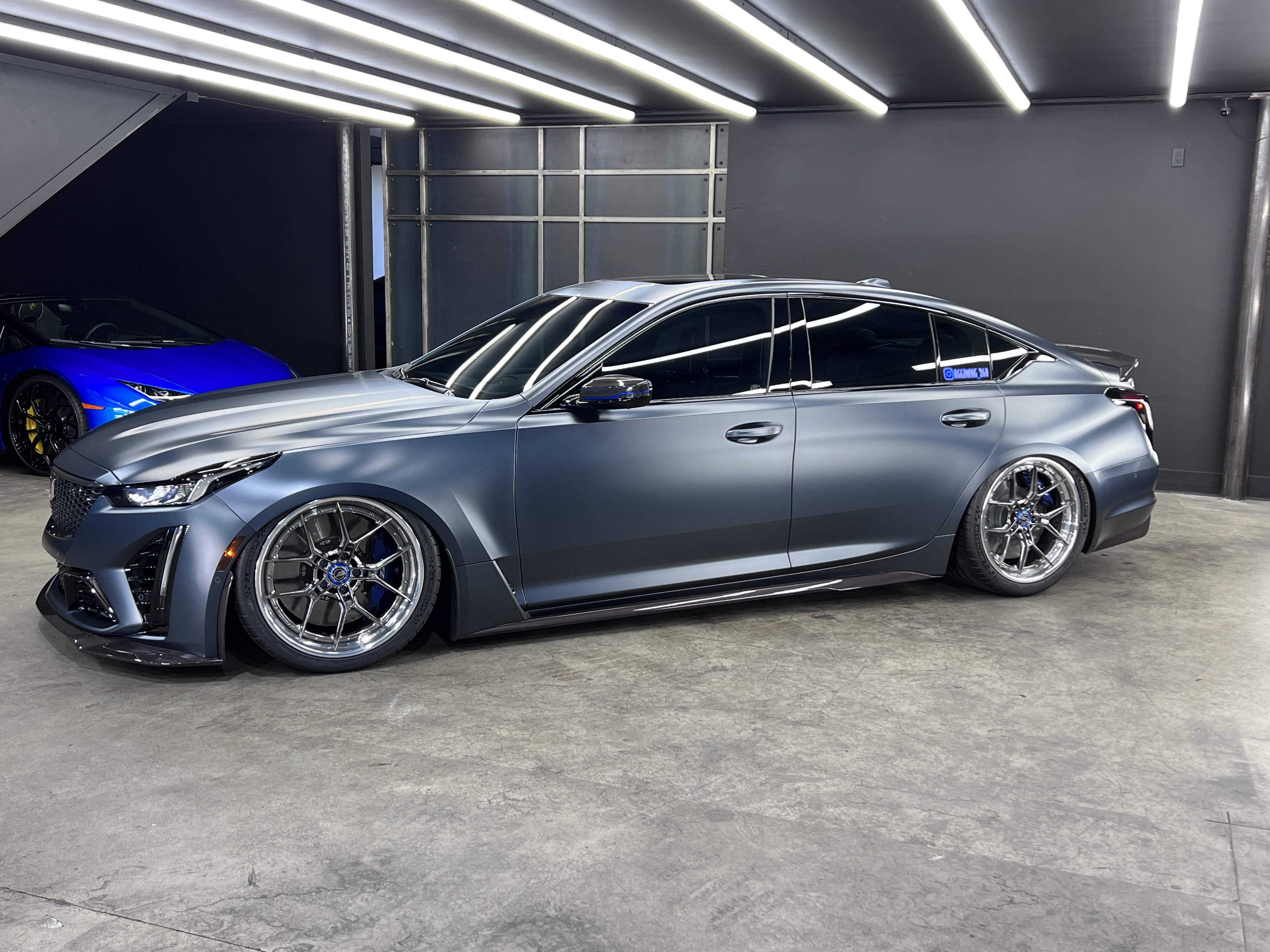

May 19, 2022 (day 104)
The wheels finally showed up a couple of weeks late and not without problems. had to send one back because the finish was less than perfect but they assured me that I'd have it back in about a week. Overall I'm super happy with the design and how the finish turned out can't wait for the last one so I can get these mounted on the car. Went with F 285/30/20 and R 305/30/20 Michelin Sport cup 2 tires since PS4S's are back ordered until god only knows when. nothing wrong with some added grip.

Looks good, surprised you didnt go blue with the hardware too.
That would have looked cool but it wasn’t offered and I didn’t even think about it until after we had ordered them. I have titanium lugs with burnt blue tops so maybe that will provide some more contrast

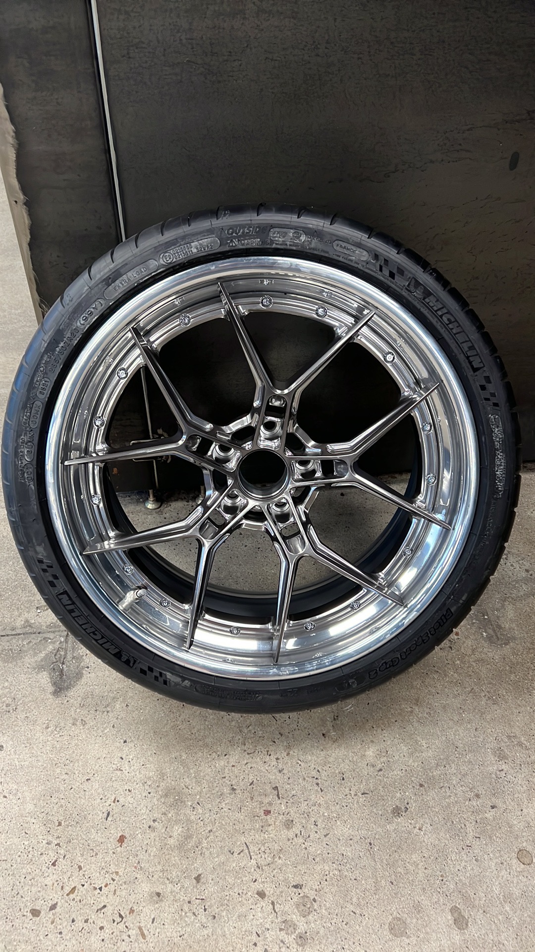

May 27 2022 (day 112)

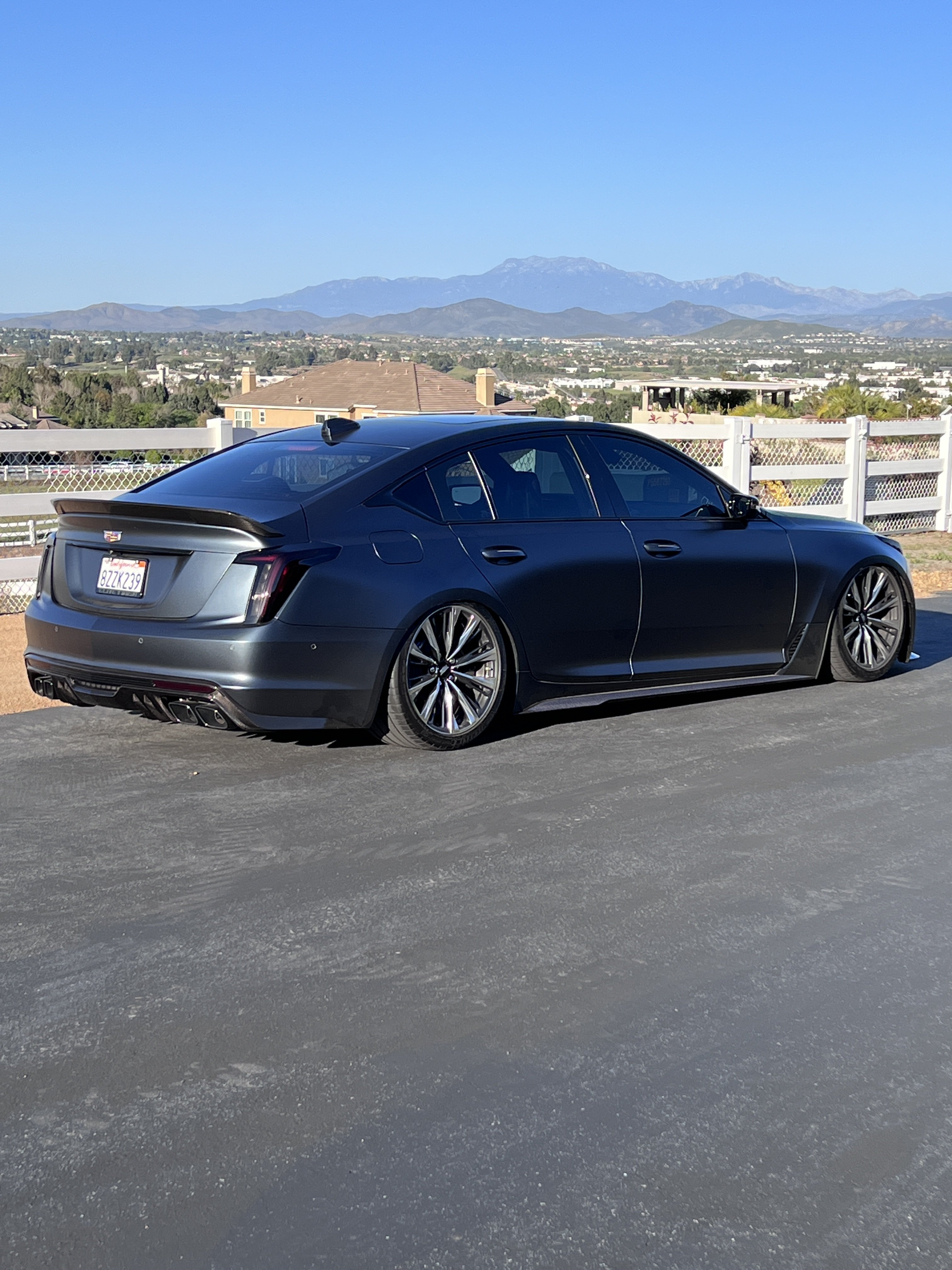

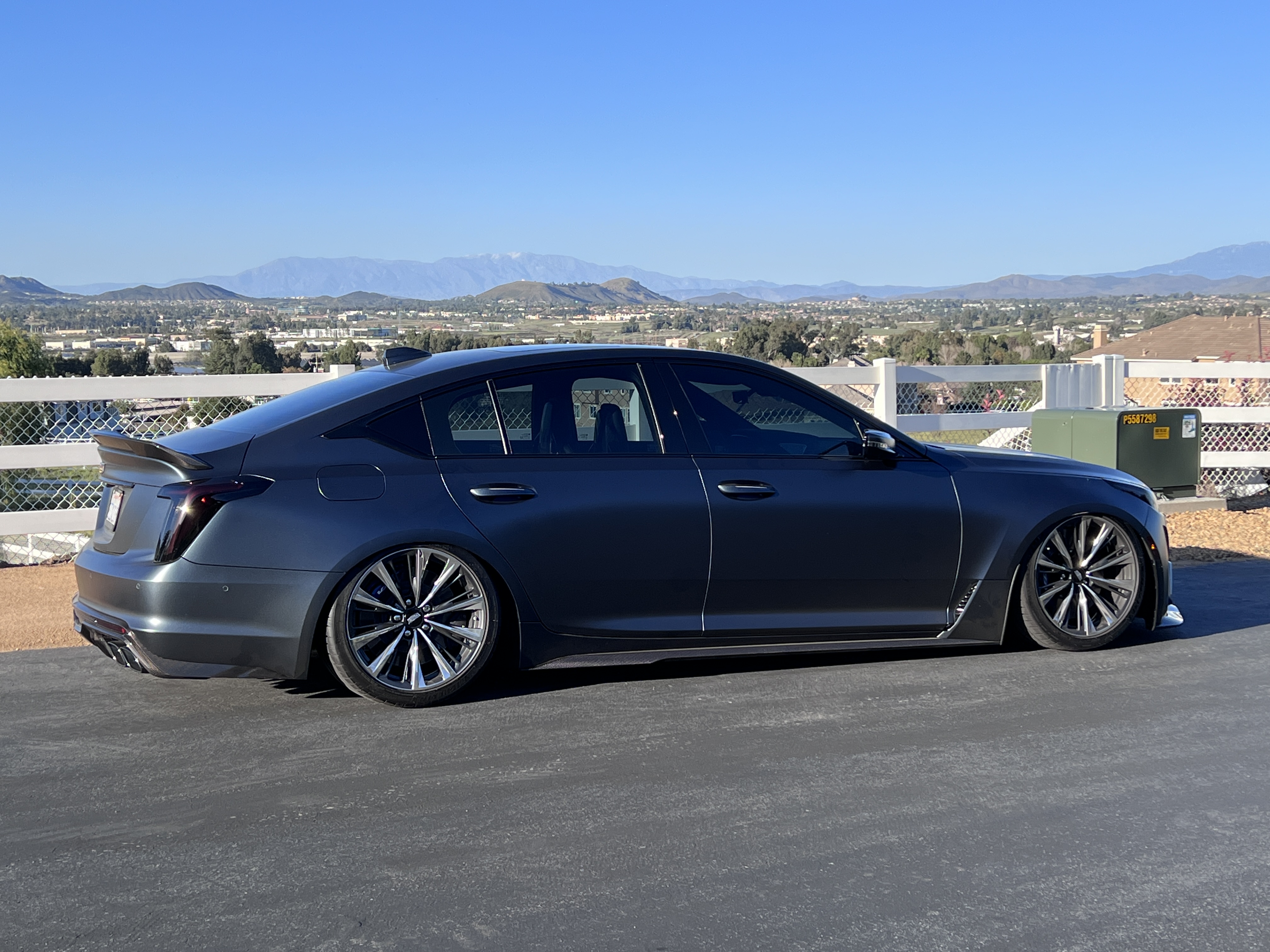

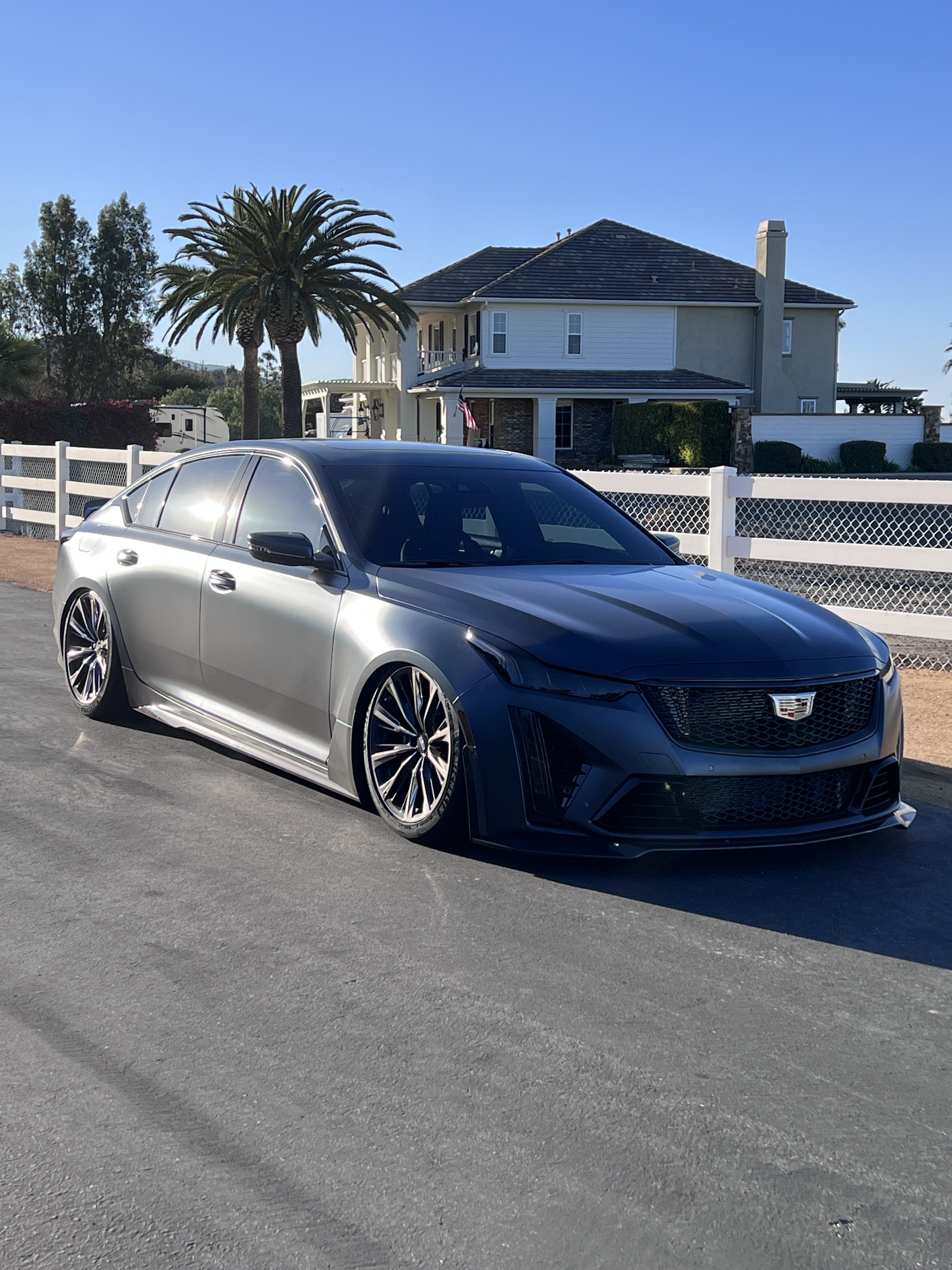

Last wheel showed up and I got the tire mounted.....then we mounted the wheels and prayed that the front fitment would work without trashing the front fenders when aired out. ultimately I chose to go with a 20x10 -12mm front wheel with 285/30/20 tires. The fitment literally couldn't have been better. I will try to get some pictures of it at normal driving height so you guys can see what the fronts look like without being aired out. the refs I kept GM's stock fitment because I was worried about them rubbing in the rear (20x11 -50mm) 305/30/20 tires. Over all I am extremely happy with how it has turned out do far......more stuff coming in a little bit. I have a bunch of audio equipment waiting for install and maybe some performance items down the road with Trifecta finally cracking the C8 ECU. I'm heavily considering switching back to a static drop with lowering springs when someone develops them and BMR everything in the rear to make the rear end more solid. I'll keep waiting for springs until then.
Stunning!
Love the finish - looks amazing on the shadow metallic! Love the wheels too!
Stocks up front are 19x10 +20 right? So you moved it out 32mm? Thats alot of poke and suprised that it sat inside the fenders. What lug nuts did you end up running? Doesnt seem to have a whole lot of options for m14x1.5 compared to m12s.
