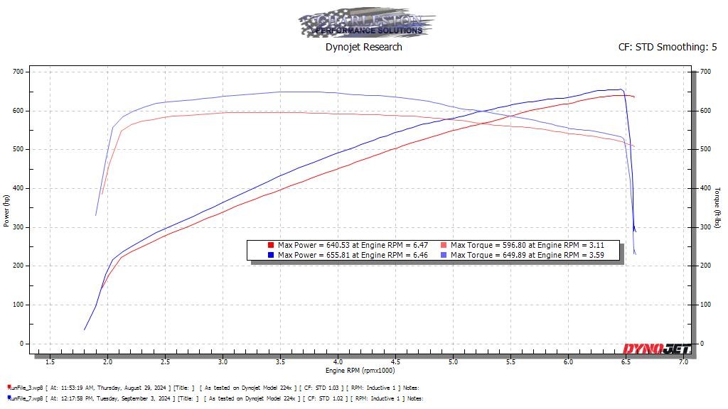

Just got my Kooks headers installed.. OMG why did i wait this long to do it? Sound is incredible with the valves wide open. Fully closed you can hardly hear it over music. Open the windows and have the valves full open it sounds like straight pipes! 15 hp and 55 tq gained as well. No CEL yet.
First pull is stock headers, second is with the Kooks.

Catted or catless?
