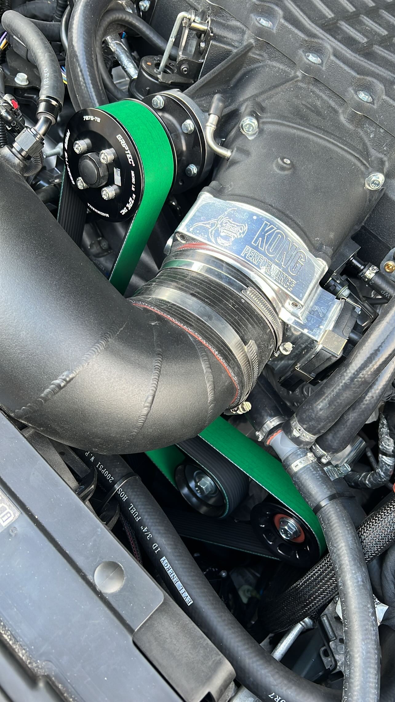

10 rib

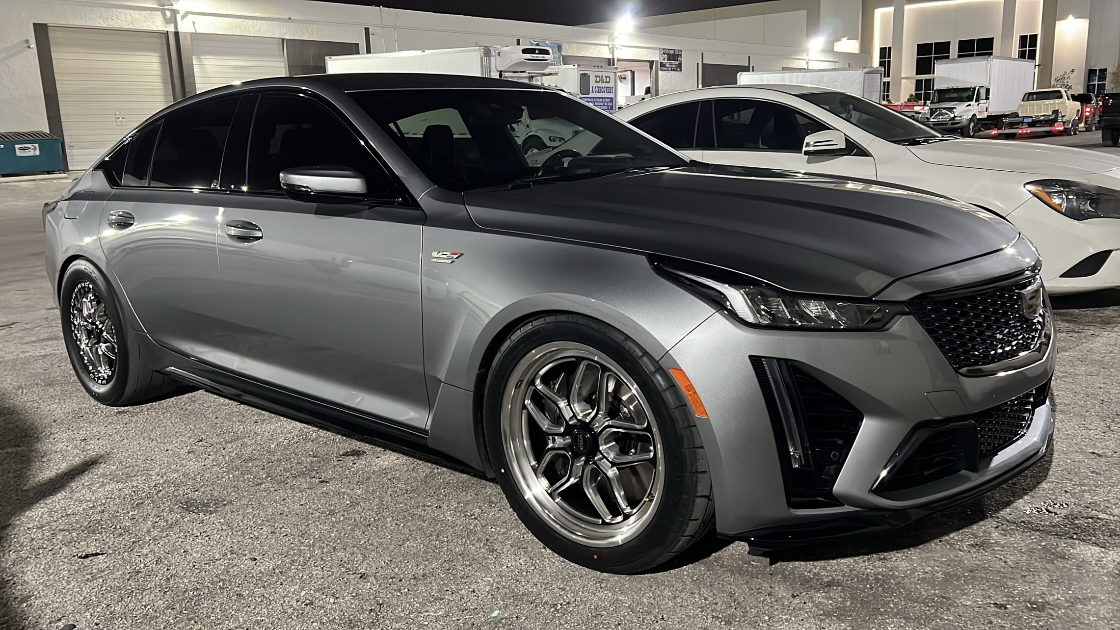

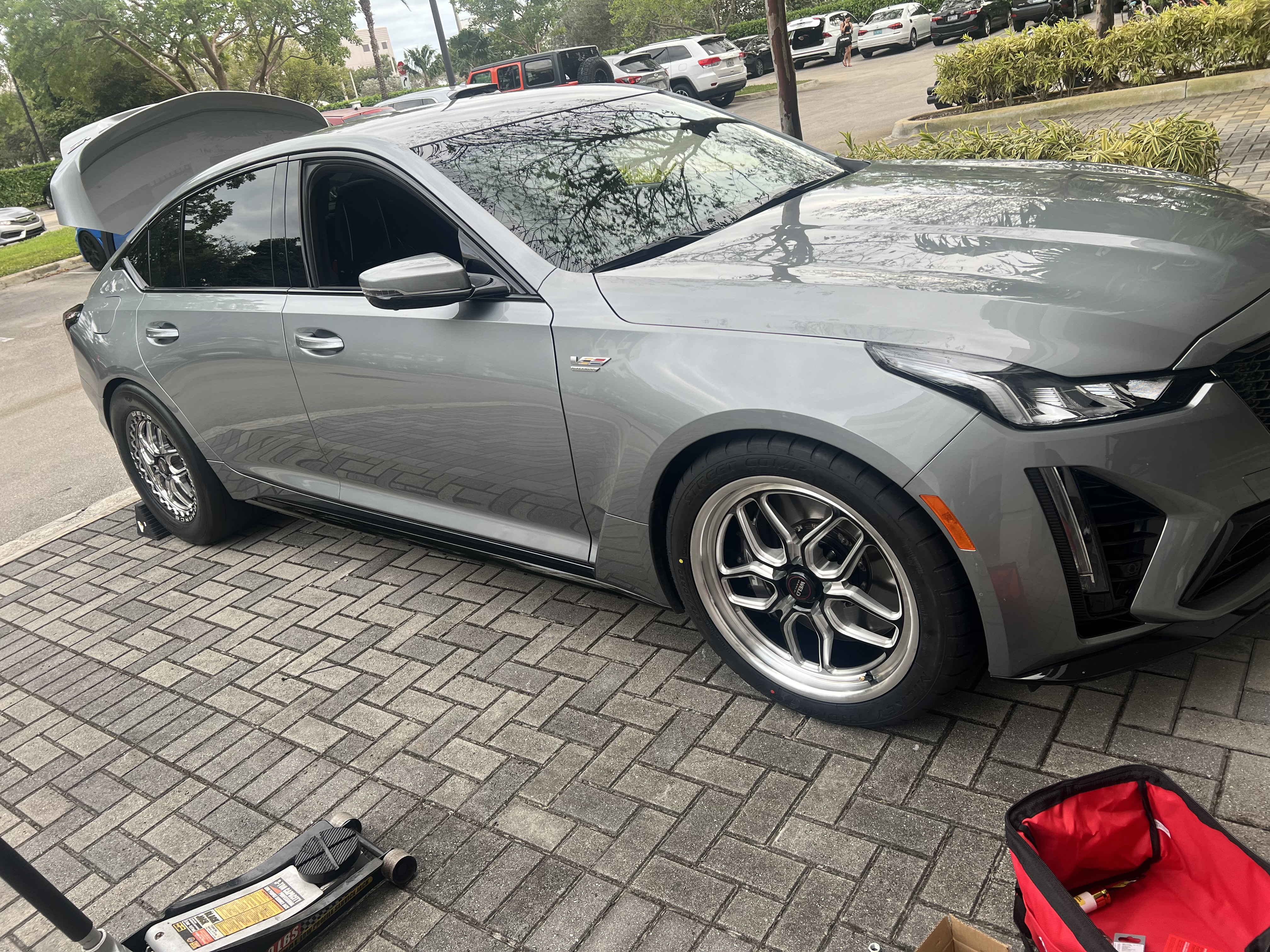

Hello v cousins, we got some weld wheels workin, rears are 18 fronts are 20 we needed to keep the diameter of the tires the same so the computers n sensors are happy

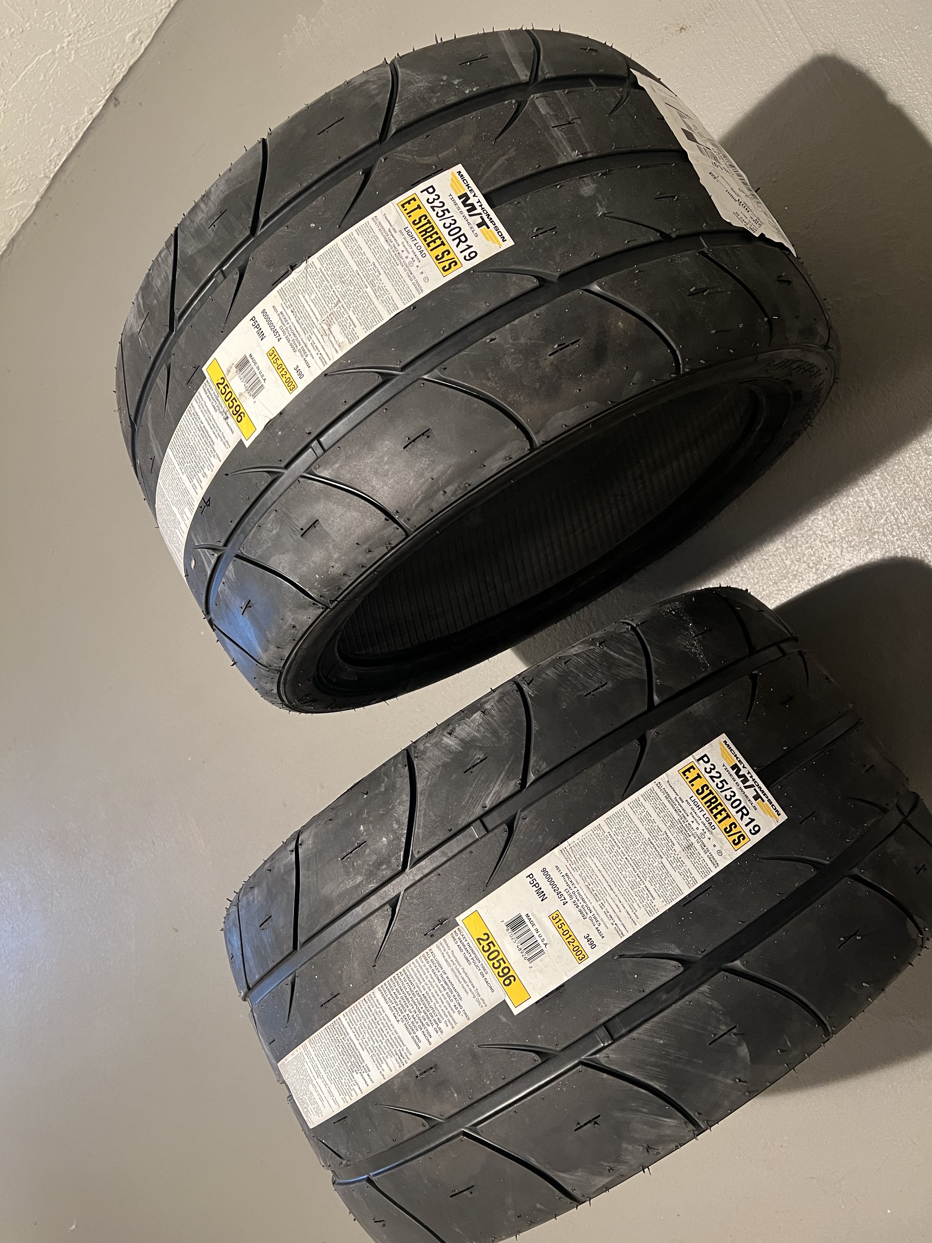

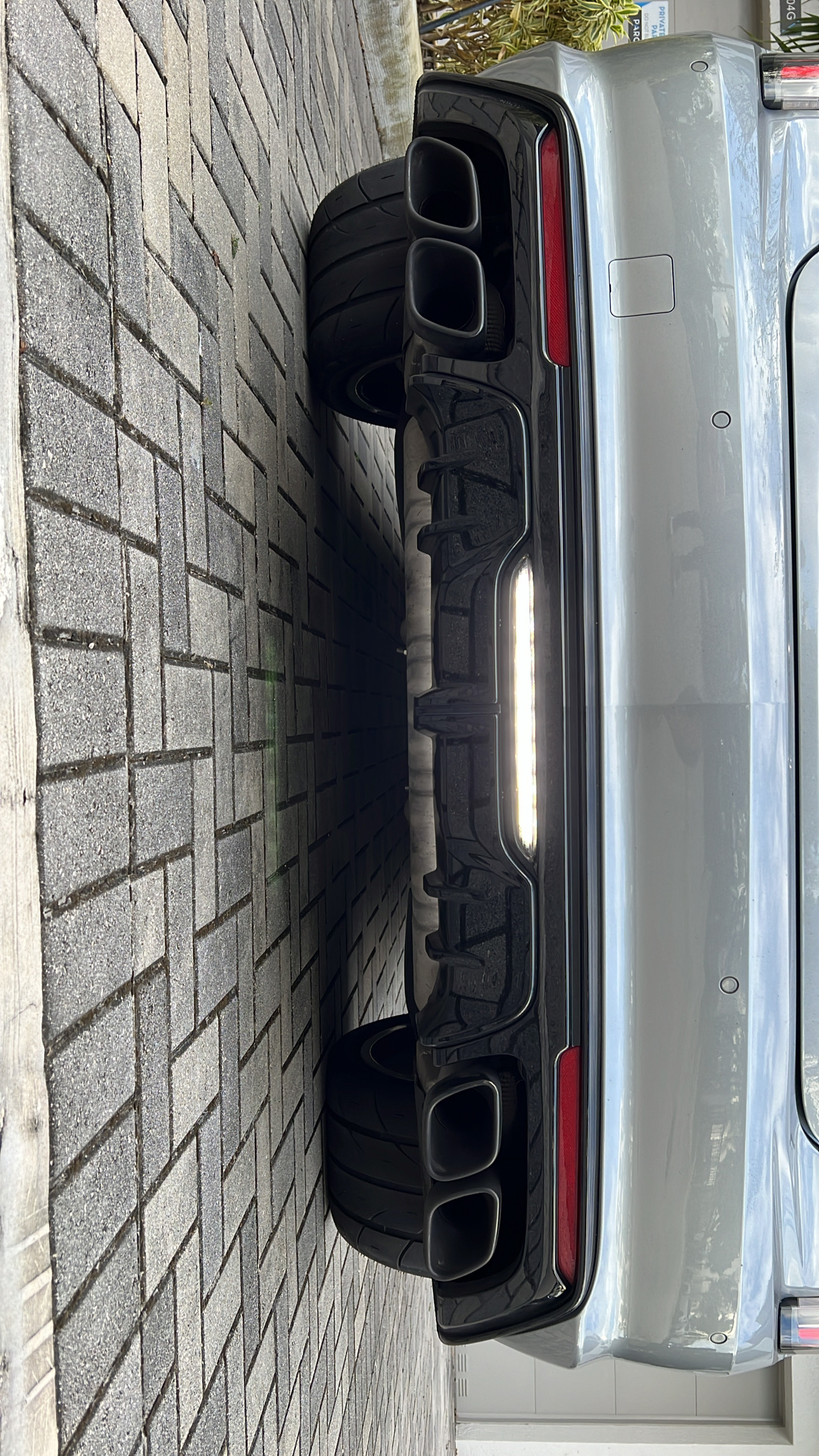

I also got 325 Mickey Thompson ets for the stocks car drives much better with the current power level on these

To fit the welds safely we are installing longer wheel studs from ARP. As the fronts do need spaces.
We did the rears with a tiny 4mm spacer but we will see if we can do without it. I’ll probably need to grind down the 2nd caliper more.
Yeah we grinded it down 😹😹😹

Did some test pulls n the car is super sketch kmao car semi hooks over 50mph rolls but it almost glides left n right as you’re going over 100mph, makes me feel like I’m gonna lose it
we ordered a 10 rib kit for our set up, when the 15 inch conversion from lmp shows up we will try for 1000hp see if the trans holds

Do you have the solid rear toe links yet? If not, they would probably really help with the squirrelly feeling it has.

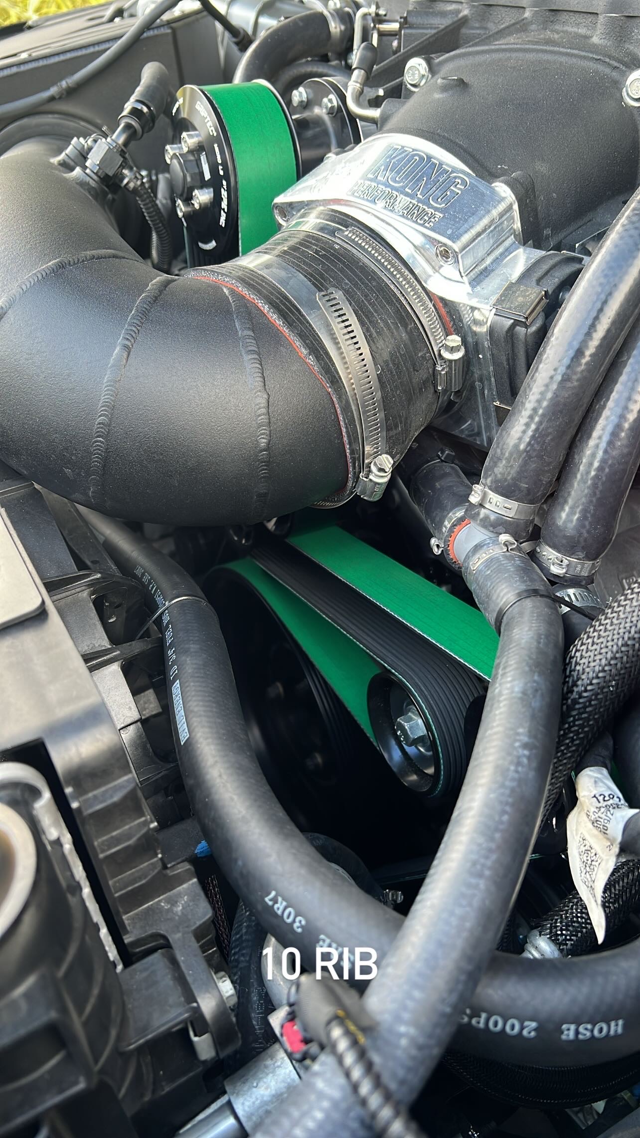

The strut brace doesn't fit with the 2650 does it?
It does but when the engine inevitably has some movement at wot it will make contact.
I have a buddy who didn’t think much of it and it did in fact hit this blower which is lower than the stock maggy lid btw
I have thought of using like a washer or something but seeing as the car will only go in a straight line I don’t think it matters for now
Your build is awesome - I was just curious because I wanted to 2650 at some point myself (y)
