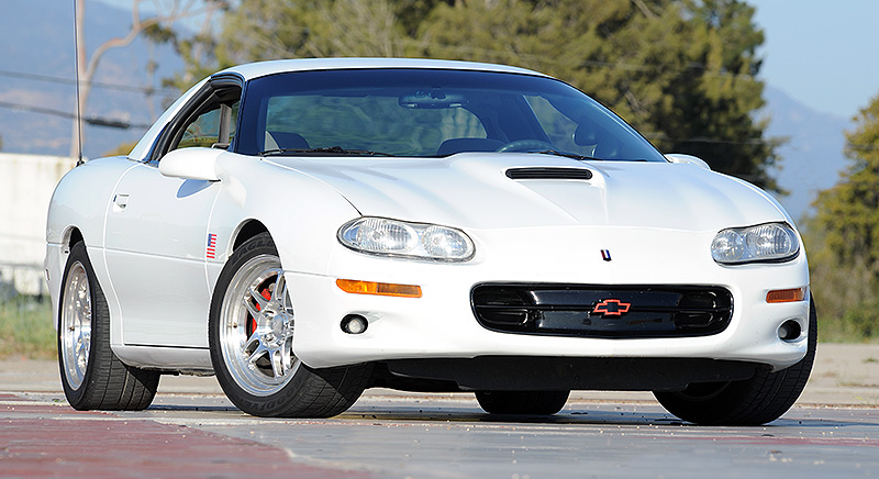

For another several days, I'm stuck driving my old hot rod Camaro–I hope you feel my pain going from my cushy Blue BMW Buster back to that 16-year old, retired magazine/Internet project car.
My 2001 Camaro is a Sport Coupe with the base V6 and a five-speed manual transmission. It was ordered with only two major options, the Y99 "Performance Package" and the "Monsoon" sound system. Y99 added a Torsen limited slip to the rear axle, higher rate springs and stabilizers and dual exhaust. The Monsoon system? Well...if you like your music loud (which I do) the Monsoon stereo was a must-have in a 4th Gen Camaro.
In 16 years of ownership and 135,000 miles, that Camaro has been a great car and a good platform for modification–oh...did I mention it was a hot rod? The engine began life as a 200-hp 3.8L pushrod V6. It's now a 300-hp 3.8. During that car's tenure as a magazine/Internet project vehicle, I often got the question: "Why a V6 project?" My answer? Anyone can build-up a Camaro with a V8 and lots of people have done it, but a hot rod V6? That's unique and was far more of a challenge, in part, because there is not near as much bolt-on performance parts for the 3.8 V6.
I gained that 50% more horsepower with engine "top end" work. It has a Comp Cam, ported heads with bigger valves, Katech valve springs, higher ratio rocker arms, extrude-honed intake manifold and plenum, RC Engineering injectors, a low-restriction air filter assembly, tube headers, a high-flow catalytic converter, a Flowmaster exhaust system and my own custom tuning work. The engine makes 300-hp@5750-rpm.
I also added a lot of aftermarket parts intended to improve the car's handling. To stiffen the car's structure, I had Global West Suspension install a set of subframe connectors.The car has a coil-over-shock conversion in the front with control arm bushings from a 1LE Camaro. It, also, has Z28 stabilizer bars and QA1 double-adjustable shocks all around. From an at-limit handing perspective, the 3-and-4 Gen Camaro's weak spot is how the rear suspension works (or doesn't work) exiting turns. I fixed that with a bunch of parts from Global West–constant rate rear coil springs, tubular steel lower control arms, tubular steel adjustable track bar and Global West's famed Trac-Link system. Even with all those mods to stiffen all the suspension links and optimize the rear roll center and rear suspension geometry, the fact remains, a 4 Gen Camaro still has a live rear axle.
I finished off the package with Baer drilled-and-grooved brake rotors, Porterfield R4S brake pads and 265/40ZR17 Goodyear F1 Supercar tires on Fikse Profil 5S, 17x9.5-in aluminum wheels.
If you want all of the nitty-gritty on how to build a hot-rod V6 fourth-generation Camaro, you can go to - Tom Henry RS V6 Camaro Project and read all six parts of the "long" Camaro Homepage version of the project.
My aftermarket-enhanced Camaro and an ATS-V are worlds apart. With 164 more horsepower, Cadillac's littlest V as a lot more fun to drive in a straight line. With independent rear suspension, modern suspension tuning, MagnaRide and stability enhancement and ATS-V is a lot easer to drive at the limit than is my Camaro. There really are only two advantages to that Camaro: 1) it gets better gas mileage and 2) it's cheaper to insure.

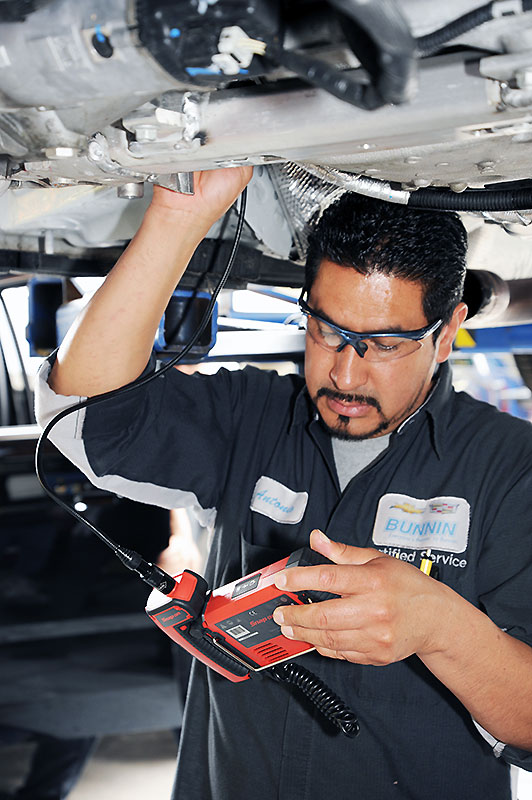

After 4000 miles of oil consumption tests, next, TAC instructed Bunnin Cadillac to pull the spark plugs for inspection–no easy task on an LF4. Getting them out requires removal of most of the turbocharger compressor plumbing. A couple plugs showed some evidence of oil use, so TAC, next, ordered Tony Espinoza, Bunnin's Lead Service Technician, to borescope the engine.
The first borescope session showed a couple of pistons and some combustion chamber walls with a modest amount of burnt oil residue. I did not expect a lot of oil residue on pistons or walls because the engine's overall oil use was low. Bunnin's ace service tech, Mr. Espinoza, did a second borescope session with a different end on the 'scope which allowed him to view intake valves once the engine was manually turned until the intake valves on the cylinder in question were open. What he saw was alarming: some intake valves with significant coke deposits. Tony's boss, Bunnin Fixed Operations Manager, Chris Williams, told A Little V-Blog that he'd never :nono: seen valves with that much coke on them after only 26,000 miles.
Williams and Espinoza sent TAC digital images from the bore scope and suggested that the heads be replaced. Technical Assistance decided there might be a valve stem sealing problem and agreed (perhaps reluctantly?) to the head change.

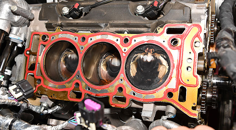

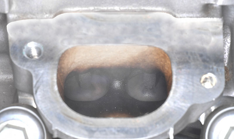

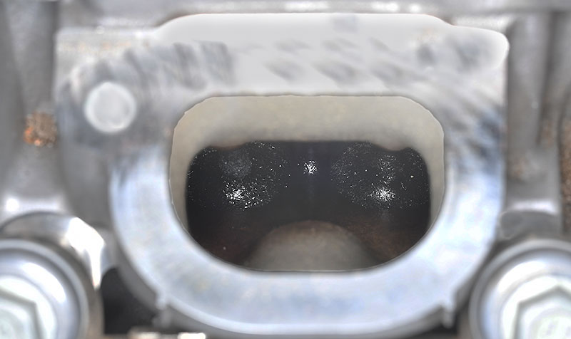

Once Tony had the heads off, we had a better view of the problem. Puzzling all of us was that not all the intakes were equally coked–some were heavily deposited, but others were fairly clean.
Some intake valves were badly coked.
Others were not.
Images: Author
Additionally, some piston tops showed modest indications of oil use. It was clear the engine was ingesting some oil and and, at the time, we all figured there was a valve stem sealing problem, but regardless of the source of the oil ingestion, currently, at the field service level, a method of "de-coking" intake valves in LF4 engines does not exist; so the heads had to be replaced.

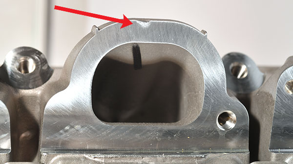

After an inspection, the first pair of heads from GM's parts network was rejected because one had been damaged during shipping or packing. It had a large "dent" on an intake port flange such that the intake manifold would not seal. A second set was shipped direct to Bunnin's Parts Department from the LF4 engine assembly plant at Silao, Mexico.
Oopsee! :rolleyes:
The drive-side head from the second set of heads.
Images: Author

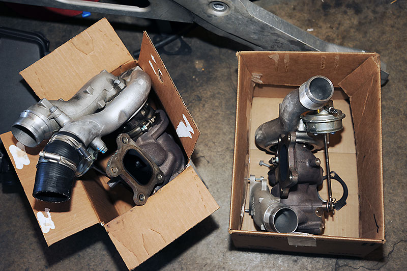

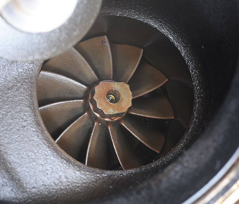

After tearing down Pearl's LF4 in preparation for the head swap, we got another big surprise. Tony Espinoza observed liquid oil on the left-side turbocharger's turbine wheel hub and blades whereas the turbine wheel in the right turbo was dry.
Uh-oh.
:pat:
The two turbos off Pearl's LF4.
The turbine wheel in the driver-side turbo was wet with oil.
Images: Author.
Espinoza suggested a turbo change. Bunnin Cadillac's Chris Williams advised the Technical Assistance Center of his top tech's findings and recommended the turbos be replaced. The Technical Assistance Center rejected Bunnin's recommendations and told them to only replace the heads.
Big mistake. One of many TAC makes in sacrificing customer satisfaction on the alter of warranty cost reduction.

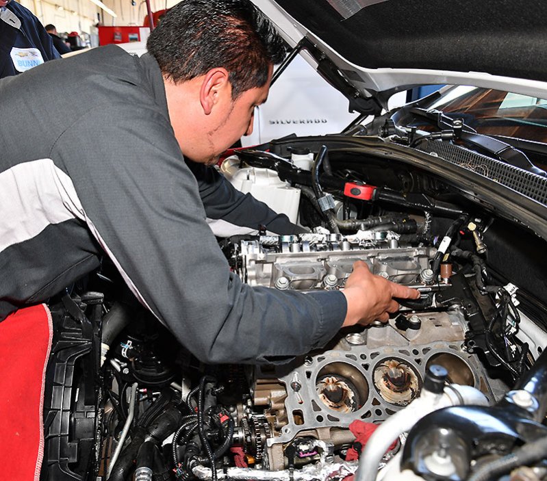

Bunnin's top tech, Tony Espinoza
lowers the right-side head into place.
Image: Author.

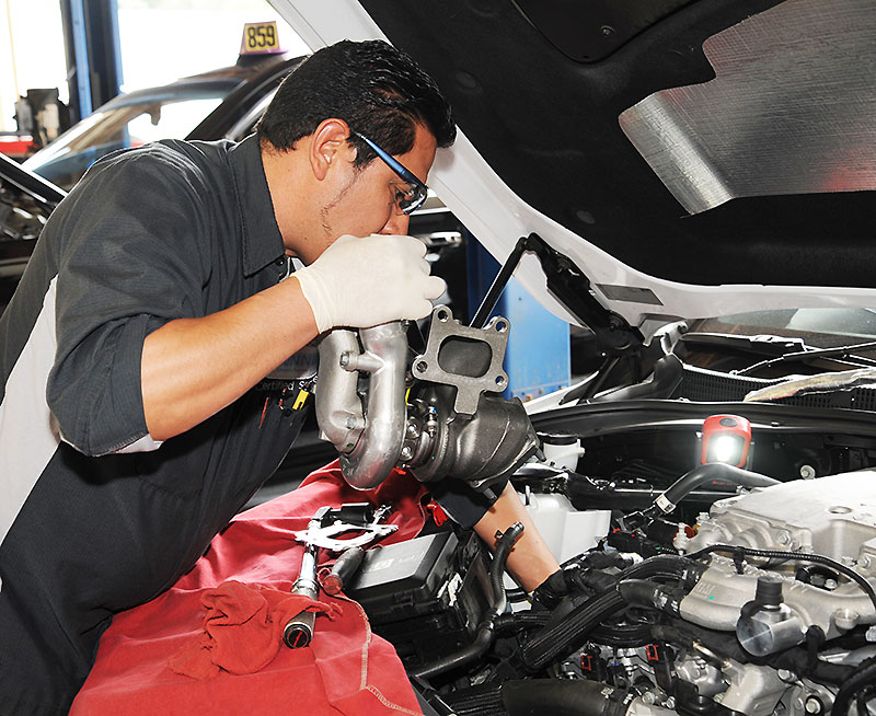

Heavy engine work on the LF4 in an ATS-V is time consuming because of the tight packaging in the car's underhood, so It took a week to change the heads. Once we had the car back, It only took a day or so for me to determine the oil smoke on cold start problem had not been solved and, if anything, was getting worse. My Wife was pissed :mad: that GM could not fix her car. Click here to see video footage of the problem after installation of new heads.
A week or so later, we took the car back to Bunnin Cadillac. They let it sit overnight then started the engine and filled the service drive full of oil smoke. TAC changed its "tune" and authorized replacement of both turbochargers. I, also, asked Chris Williams to request replacement of both catalytic converters because excessive oil burning–in my opinion, 10 months of oil smoke on cold starts qualifies as "excessive"–can decrease cat life. Expectedly, TAC told my Bunnin, "Watch our lips: no new cats". Ok–just kidding on the "Watch our lips..." part. I admit, asking for new cats was a "hail Mary" play, but It will not surprise me if, sometime soon, the driver side cat prematurely fails an emissions test, and then, I'll get to fight with General Motors :argue: over a new warranty claim.
The turbo change took two weeks because of 1) the complexity of working on an LF4 and 2) a parts shortage which delayed arrival of some key gaskets and o-ring seals. Once those seals arrived, Tony Espinoza had the car back on the road.
Tony lifts the right-side turbo into place.
The space around the turbos is is so restricted a borescope must
be used to verify the turbo oil return gasket is installed properly.
Images: Author.
Since we got the car back on Monday, so far, we have a week's worth of cold starts in the books with no oil smoke whatsoever.
Wait–what!? Finally...after all these months, no smoke? Be still, my heart.

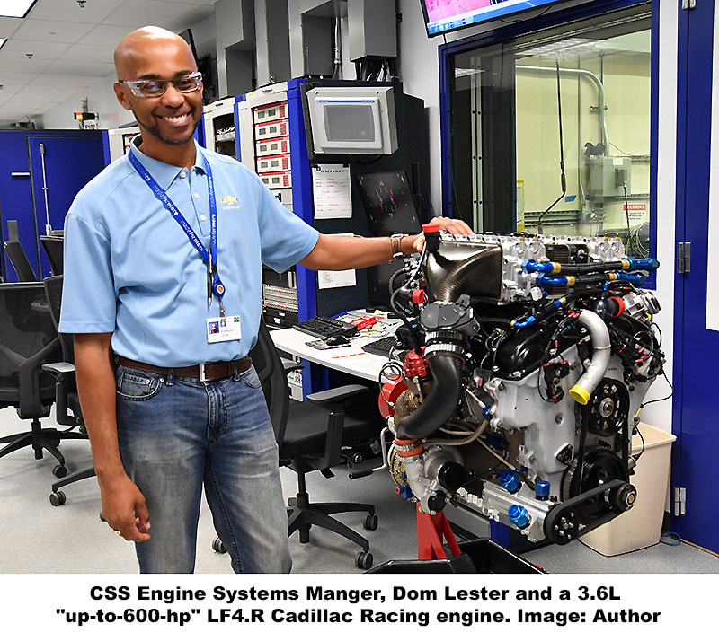

Two weeks ago, I was in Michigan on business doing research for an article I'm doing for Corvette Magazine. During my visit, I got a tour of GM's new Performance and Racing Center, a $200,000, 111,240-sqft addition to GM Global Propulsion System's "Pontiac Engineering Center.
When you first walk into the "PRC" you see a mobile hanging from the ceiling of an exploded LF3.R engine out of one of Cadillac Racing's ATS-Vs. I'd love to have that in my home. Well...on second thought, I'd need a 20-foot ceiling, so...maybe not.
My tour was guided by Dom Lester one of the PRC's CSS Engine Systems Manager and who, interestingly, was the Design Release Engineer for the cylinder head used on the LF4 engines in ATS-Vs. He showed us a fully-assembled LF4.R. The engine shares production block, con rods and cylinder head castings, but the induction system...intake manifold, charge air coolers, intake plumbing and (much) larger Borg-Warner turbos...is completely different.
We asked Dom how much power the engine makes. He did not give us a specific number :dunno:
but he did say the engine is capable of, "...up to 600-hp".
Our guess?
The actual number may be less than 600 at times and may be governed by what restrictions the officials of the Pirelli World Challenge might put on the engine.
I also asked him about "his" cylinder head and whether or not the integral exhaust manifolds are ported or extrude-honed for use on LF4.Rs. I was astonished to have him tell me they are not modified at all. But then, I thought about it for a while. I guess with a boosted engine the change in air flow characteristics might not make as much a difference as some people might think.
Pretty cool that some of the stock LF4 pieces can support up to 600-hp.

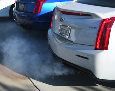

Cold Start Oil Smoke v2.0
It's time to check in with one of the V-Net's product evaluation cars, Pearl, our Crystal White Tincoat ATS-V, four-door, automatic.
Unfortunately, the news is not good. The car is having a second round of oil burning after cold starts.
The characteristics are like before–the exhaust outlets emit oil smoke for a short period after every cold start. As was the case before, the smoke is definitely oil burning and not due to the normal rich fuel mixture during cold starts.
This began a few thousand miles after both turbochargers were replaced late last Spring. By early September 2017, it was obvious the engine was blowing oil smoke, again. To see the evidence, click here.
The oil put in the engine in Dec. 2016, Mobil 1 5W30, when the second oil consumption test was ordered by TAC prior to the cylinder head change, was still in the engine after the turbocharger replacement in April of 2017. Concerned that the head change followed several weeks later by the turbocharger replacement (both of which "opened up" the engine oiling system) might have affected the engine oil or oil filter, a while after the turbo work was done, I changed the oil. Knowing that an oil change before 0% oil life would not be covered by Cadillac Premium Care, I did the work myself. Rather than using Driven LS3, I use a Dexos 1 Gen 2 licensed 5W30 synthetic sold by Valvoline. The filter is an ACDelco PF63E.
During the last couple of months, I've been searching the Internet for other instances of this problem and I now have read anecdotal information about two other cases of this smoke-on-cold-start problem with LF4 engines in ATS-Vs making, a total of five cases: 2 different incidences with our car and problems experienced by three other ATS-V owners who are members of the Cadillac Forum.
I'm starting to consider the possibility that GM has a problem with the shaft seals in the turbos used by the LF4.
