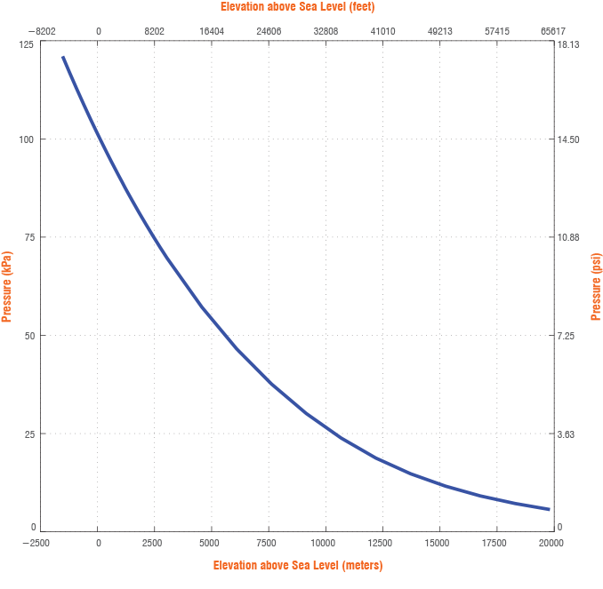

I just hit the 500 mile mark and did a similar pull (40-120ish). I've done a couple of pulls since as well. I can only get to 8 lbs. of boost. I see you hit 9 easily and 10 as well.
What would cause me to only get 8 lbs? My best 0-60 so far is 4.4 with a relatively soft launch and a bit of an early 1-2 shift. I can't see any chance of getting sub 3.8. Is it just the altitude? I'm at like 4700 ft. Any ideas?
Possibly an air pocket in the intercooler system that needs to be bled out?
Higher altitude will result in less boost from a supercharged application all things equal. I'm a CPA, so I can't give you a technical answer, but it is a real thing. :D
Here's a graph of atmospheric pressure over elevation. It's not the whole story, because the pressure drop is not as smooth at the surface (i.e., on the ground in Denver at ~5,000 feet will not be the same as 5,000 feet in the air over the ocean) and the temperature and humidity also play a role.
Bottom line, density altitude is probably what really matters- and on a hot, humid, summer day in the mountain west can easily exceed 7500' in places that are only physically 3-4,000' above sea level.
