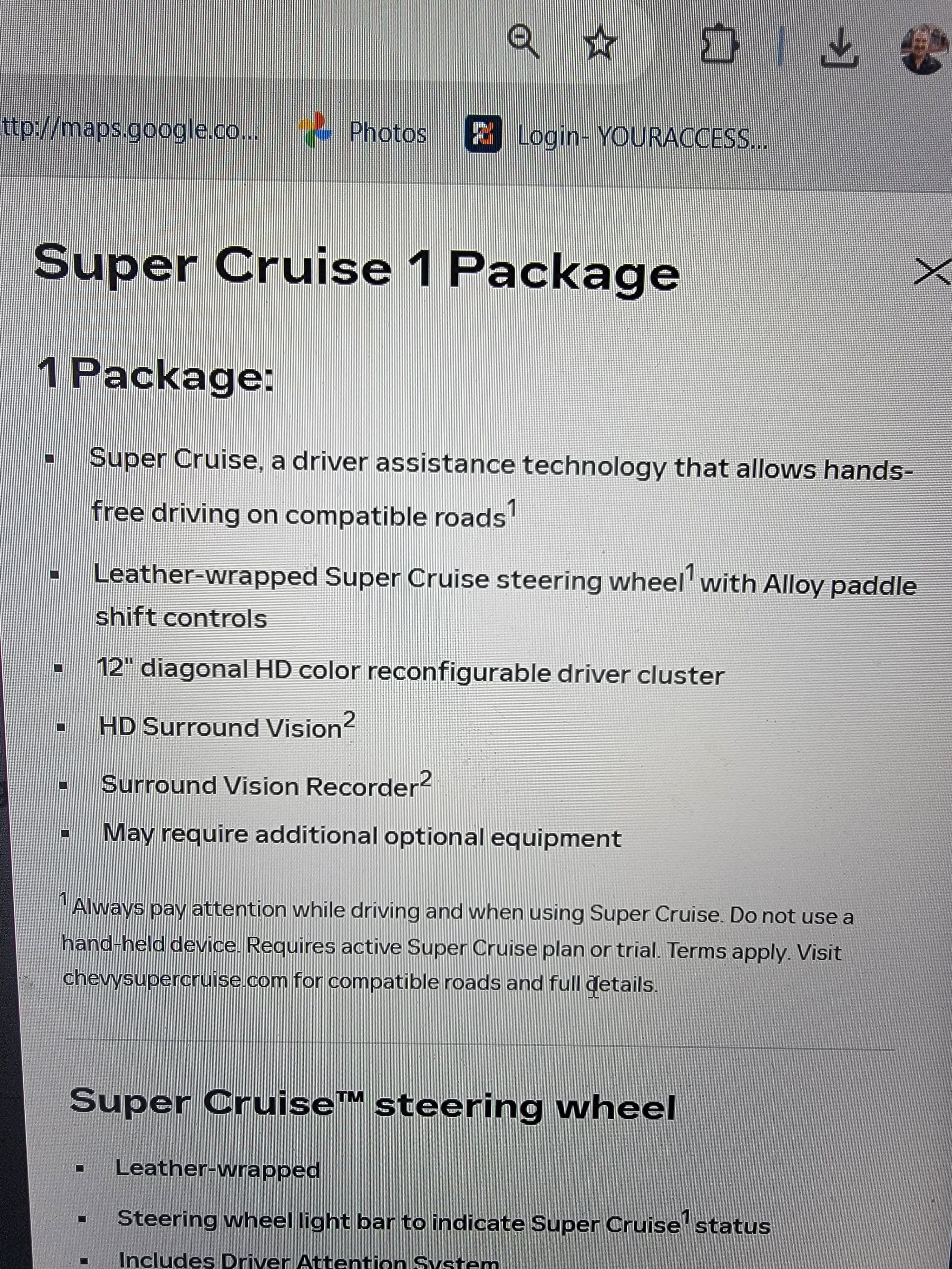

Just went Cadillac website to rebuild my car, and if you select (which they made me for what I wanted) the Super Cruise 1 Package it includes as they state "Surround Vision Recorder (see pic)

SVR- waiting for USB to play with Surround Vision Recorder APP, but it is included with the Super Cruise 1 Package see attached pic

GM's websites are worthless and nothing but a marketing tool.
The rubber meets the road on the order guide and RPO guide.
www.gmfleetorderguide.com

Does/did it? I know I've seen "HD Surround Vision" but didn't see anything that's includes the "recorder" portion.
