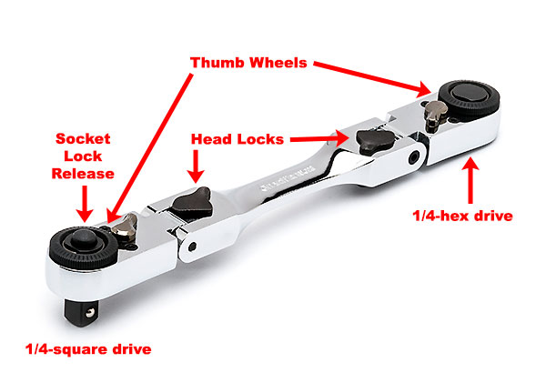

A 1/4-drive socket set which includes hex bits seems a strange combination until you check out the two ratchets. Each is a dual-flex-head design, with a ¼-in. square drive on one end and a ¼-in hex drive on the other, hence the terms “Multi-Function”.

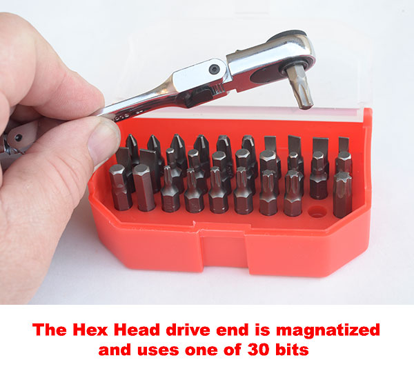

We like these ratchets for their smaller heads–3/4-in. rather than the usual inch or so wide. We also like their 72-tooth mechanisms which have a five-degree swing per tooth. The ¼-in drive end of each has a quick release feature, but it’s not just a “detent” which allows the socket to come off with a tug. It’s a real lock which retains the socket on the drive tang until you press the release. The hex drive head of each ratchet is magnetic, so it retains the bit you’re using until you remove it. We like both those features, too.
Not only did we find the “dual role” of these ratchets handy at times, these tools fit our hands nicely. When gripping the shorter ratchet at its end for maximum torque, the extra thickness of the second head gave us more to hold onto. The two flex heads have a lock-out feature, so, if you don’t want the heads to move, you set the head at the angle you want, then lock it.

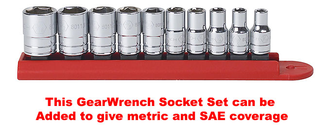

The sockets range from four to 13-mm. This set’s only drawback is there are no SAE sockets, however, GearWrench does offer a separate set (PN 80303) of 3/16-to-9/6-in., ¼-drive sockets which could be added to have both metric and SAE coverage. The hex bit set includes six slotted and six phillips head screw driver bits, six metric and six hex key (“allen”) bits and ten Torx bits.
The combination of the short ratchet and one of the slotted or phillips-head bits make a heck of a good offset screw driver. Not only does it work well in that role, but the locking flex heads make it easy if you’re trying to get at a fastener which is difficult to access and requires not only an offset screw driver but one which is offset and angled.
