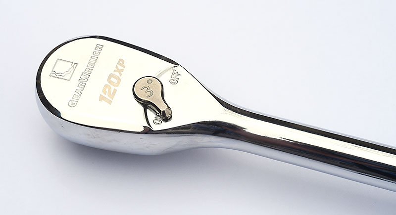

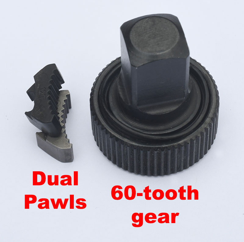

In 2012, GearWrench introduced its “120XP” line of ¼-, ⅜- and ½-drive inch drive ratchets, each of which has a high, 120-tooth count and a small, 3-degree swing arc. Not only do these GearWrench ratchets offer the advantage a high tooth count offers when working in a restricted space but their ratchet mechanism has the strength of a 60-tooth count which allows the user to really pull hard on the tool. A 120 tooth count, 3° swing and strength meeting ASME requirements comes through a 60-tooth gear and a clever “double-stacked pawl” system. The patented design has the 60-tooth gear alternately engaged by two pawls giving the ratchet 120 positions and the 3° swing arc.

GearWrench puts the 120XP mechanism in its “tear drop” low-profile ratchet head and uses a flush-mounted directional lever. The double-stack pawl system has less back-drag than competing products. Additionally, the flush-mounted directional lever is easy to manipulate. Those features make for a compact, easy-to-operate tool–another advantage when working space is limited.

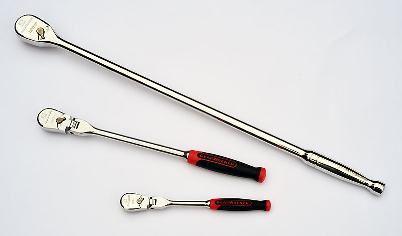

The 120XP ratchets are available with either fixed or six-position flex heads and we usually prefer the flex-head models especially in the case of GearWrench because their flex-head detent springs have higher tension compared to some other flex-head ratchets I’ve tried  made by Mac Tools and Craftsman. Their weaker detent systems allow the heads to flop around when we don’t want them to move.
The 120XP ratchets come with either polished steel or “cushion-grip” rubber handles. We already knew about the Cushion-Grip feature because we’ve been using a GearWrench offset, flex-head spark plug ratchet with a Cushion-Grip handle for many years. We like that type of handles because they’re easier on our old, tired hands.
At the CAC’s project vehicle shop, we wanted to upgrade some of our ratchets so we ordered a set of GearWrench 120XP, Cushion-Grip, flex-head ¼- and ⅜-drive ratchets (PN 81204P.  In our first use of them, we were smitten by the precise, fine-tooth feel of the 120XP double-stack pawl system, their low-back-drag and the advantages the 3° swing and compact ratchet head gave us when trying to turn fasteners in restricted spaces.
We wanted to try out the 120XP system’s strength, so we also ordered a ½-in. drive 120XP ratchet with the extra long, 2-foot handle (PN 81364). This tool is only available with a fixed head and a polished steel handle. We looked around for a really tight fastener which was, also, easy to access on which to “test” this long-handle 120XP ratchet. On an ATS-V, the rear drive axle shaft nuts are easy to get to and are tightened to 185-ft/lb. In the past we’d have to use our ½-in. drive breaker bar to undo a nut like that, as it had the longest handle (24-in) of any tool we had. We tried the GearWrench ½-in drive 120XP Ratchet and broke that nut loose with ease. Up to now, we’ve never had a ½-in. drive ratchet which was long enough and strong enough to also work as a breaker bar.
