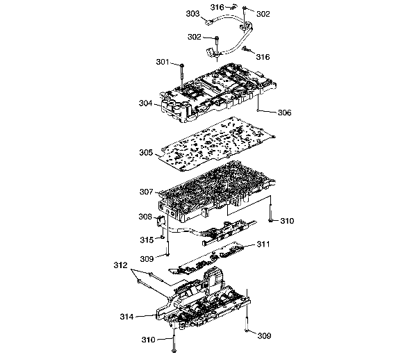

This condition may be caused by an undersized hole or debris in the control valve body spacer plate (305).
- Correction

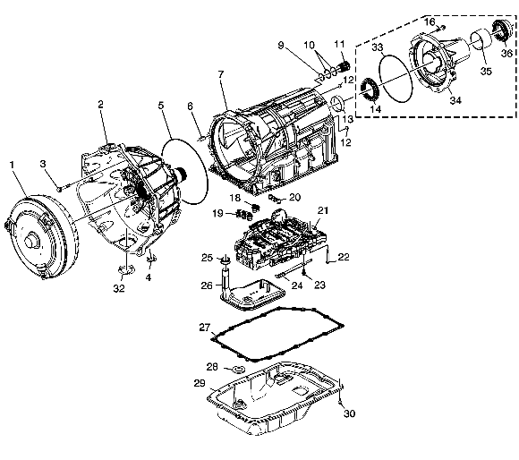

 - To correct this condition the control valve body spacer plate (305) must be replaced. The electrical connector seals (9, 10), fluid pump seals (18, 19), center support seal (20) and the filter plate assembly (311) should also be replaced. These parts are included in the filter plate kit listed below. - Changes to the control valve body spacer plate were implemented November 4, 2006 in transmission assemblies to prevent this condition. - Refer to the Control Valve Body Assembly Disassemble and Assemble procedures in the Unit Repair information of SI. - Important: - 2006 Car Applications - Do NOT run service fast learn adapts. A drive procedure must be performed instead. Refer to bulletin 06-07-30-031 for more details.
