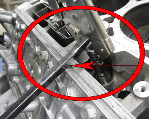

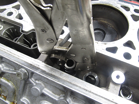

There are two approved processes for removing the lifter when stuck in the bore.  - Use vice grips with a slide hammer.
 Note: Be sure NOT to pry on the sealing surface of the block, as shown in the illustration above. - Use vice grips with a small pry bar.
 Typically, one of the above approved processes will remove the lifter that is stuck in the bore. If not, the engine will need to be replaced. With the lifter removed, be sure to inspect the bore for any damage. Typically, the lifter bores will look good with no indication of damage.
