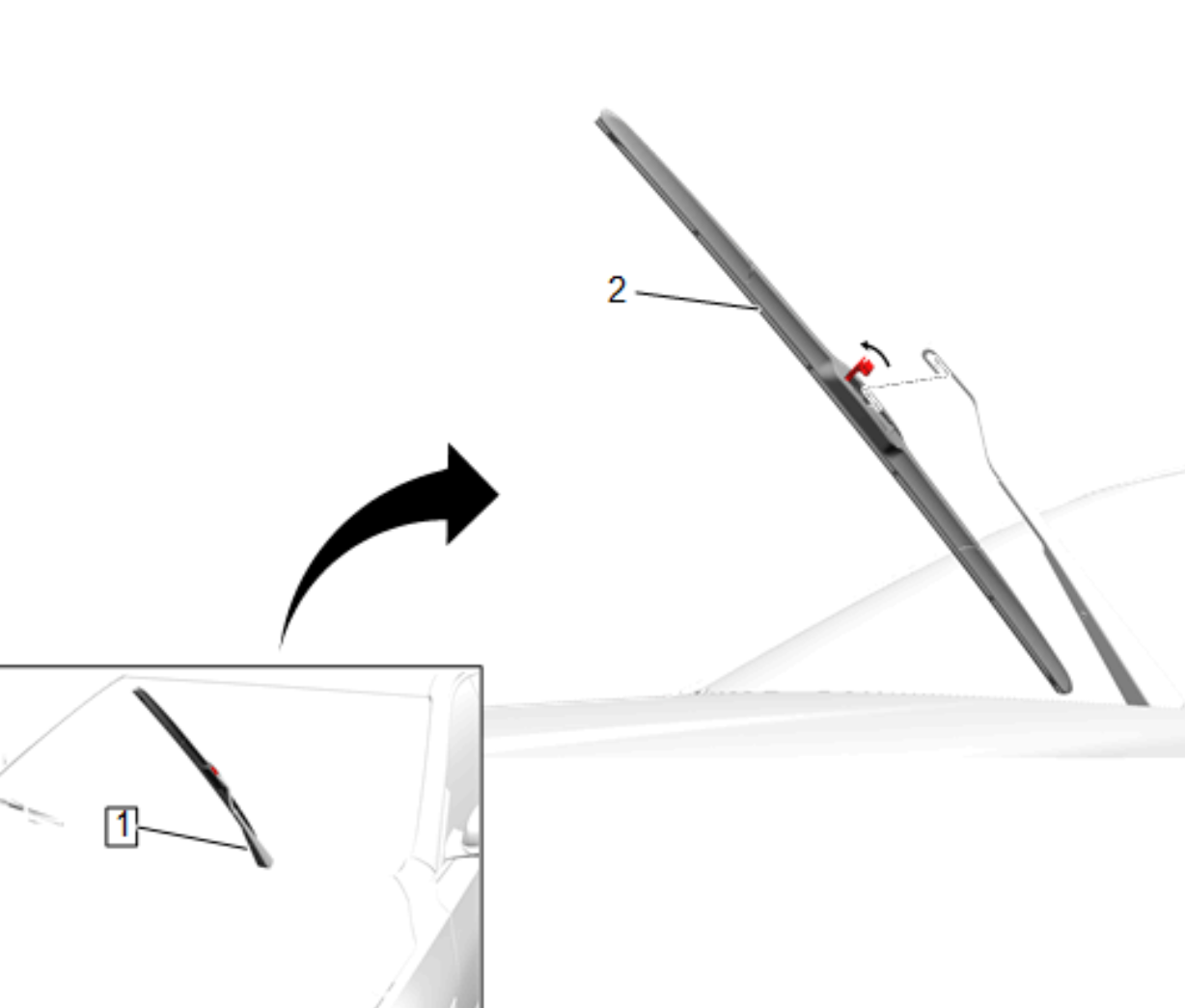

I have a 4BW and both arms can pivot up fully in the park position. I also have a 3-day subscription to the service manual and am pulling down everything on the 4BW I think I might possibly need. I checked the wiper information there, and then I checked out information for the 5BW. They both read the same as far as replacing the wiper blade which is the time you pivot up the arm. It just says pivot up the arm, replace the blade, and pivot back. No mention of any repositioning needed.
This is from the CT5 Information:
1​
Windshield Wiper Arm
Note: Do not lock wiper arm away from the windshield without a wiper blade installed on the arm.
Procedure
Lift the windshield wiper arm off the windshield to the service-up position.​
2​
Windshield Wiper Blade
Procedure
  1. Using a suitable tool, release the windshield wiper blade retaining clip.
  2. While holding the wiper arm, pull gently downward on the wiper blade to remove the wiper blade from the wiper arm.

Thanks -- The above works with the driver's side wiper. But the px side wiper arm is recessed beneath the hood so cannot be moved off the glass more than an inch.
I suspect it's done the old fashioned way. Turn on the wipers and when they reach the midway point shut off the vehicle.
