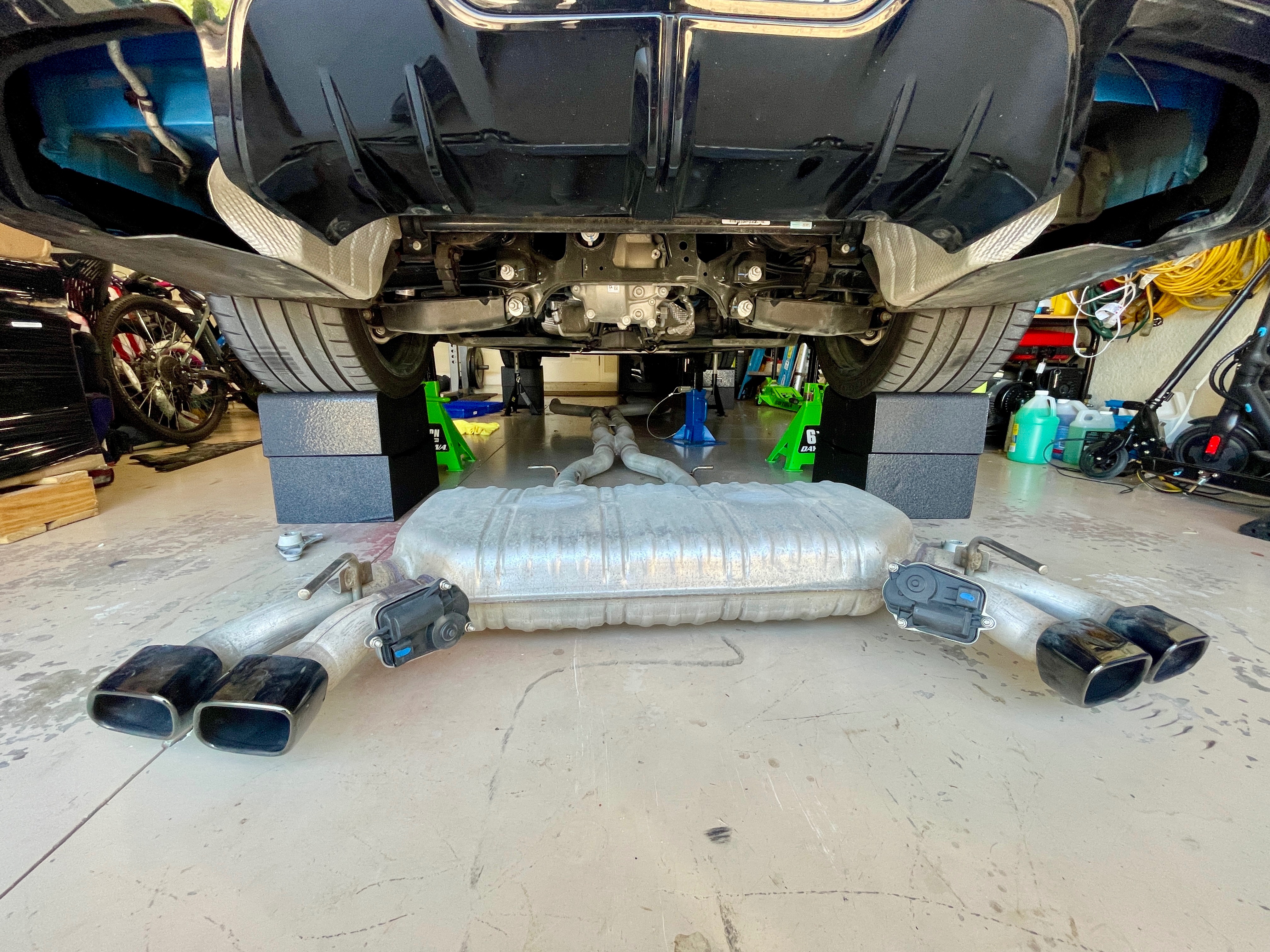

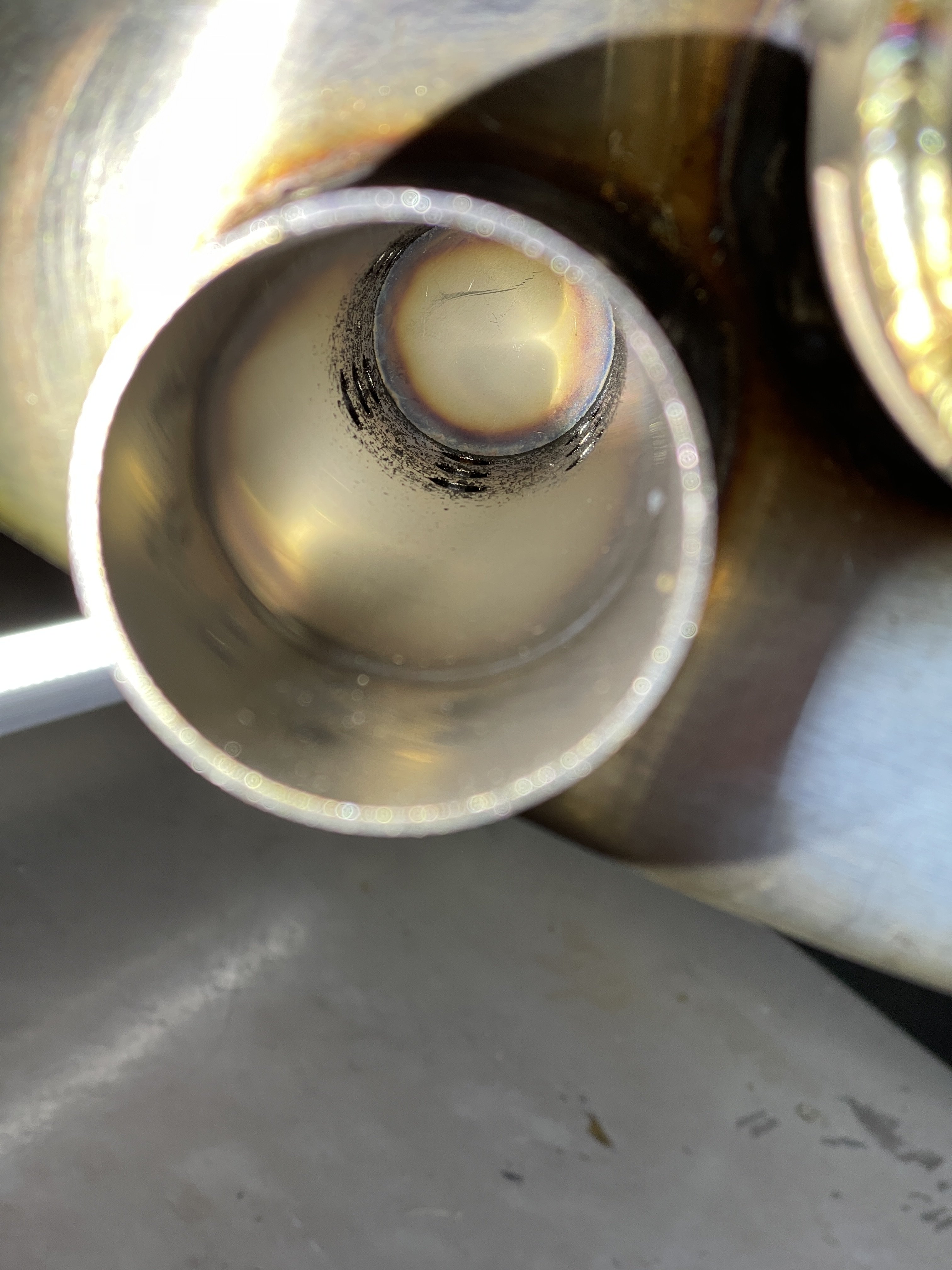

I’m installing the full system today.
Ok… install done. Holy crap. It’s a whole other level of low-end loud. The burble is amplified and seemingly occurs all the time now. I do pick up a slight drone under 3K RPM in 2nd-3rd. I never used Tour Mode as I’ve never felt stock was that loud, neighbors never cared. I’m absolutely using Tour Mode in and out of my hood now…
Speaking of Tour Mode, it’s significantly more quiet then stock when valves are closed. It’s literally a Jekyll & Hyde exhaust system.

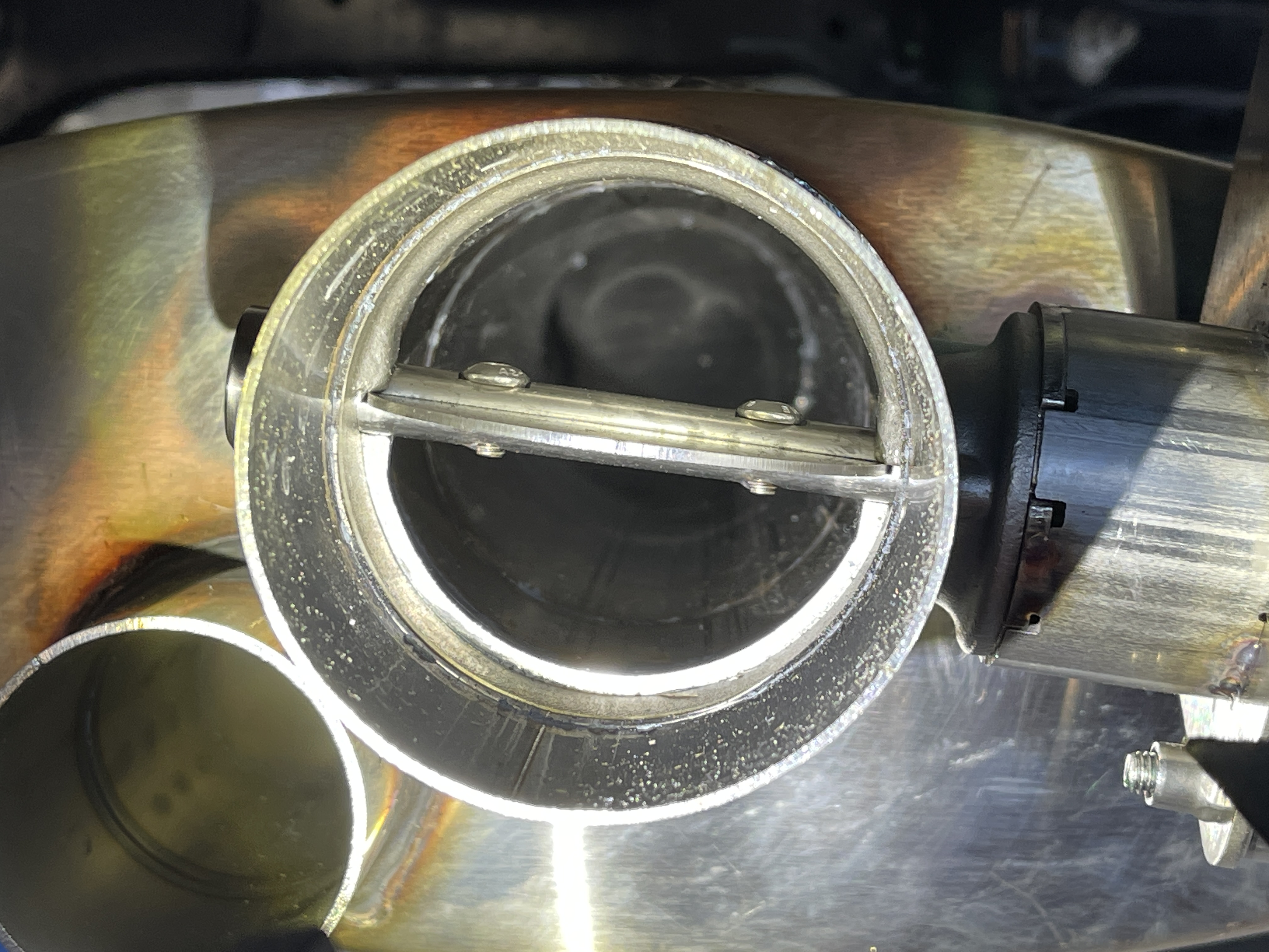

I noticed some interesting designs in the flapped bypass pipes from the muffler. The quietness I’m guessing is a product of only allowing the flow out the baffling holes, which makes sense.
I set the flaps to Tour Mode prior to install. No errors yet. Flaps function perfectly, thank god. The only pain in the ass was getting the tips to align in both X/Y axis…

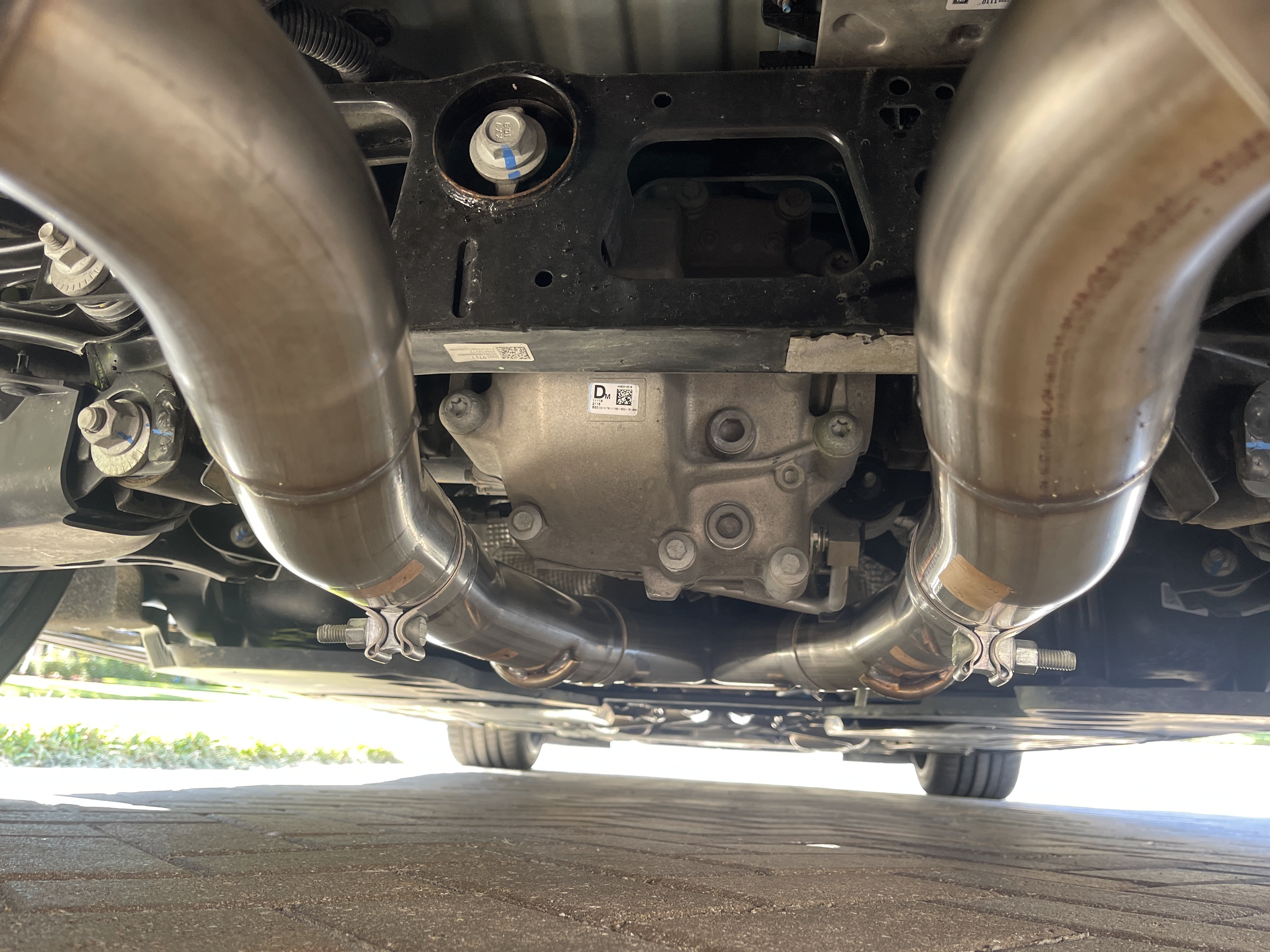

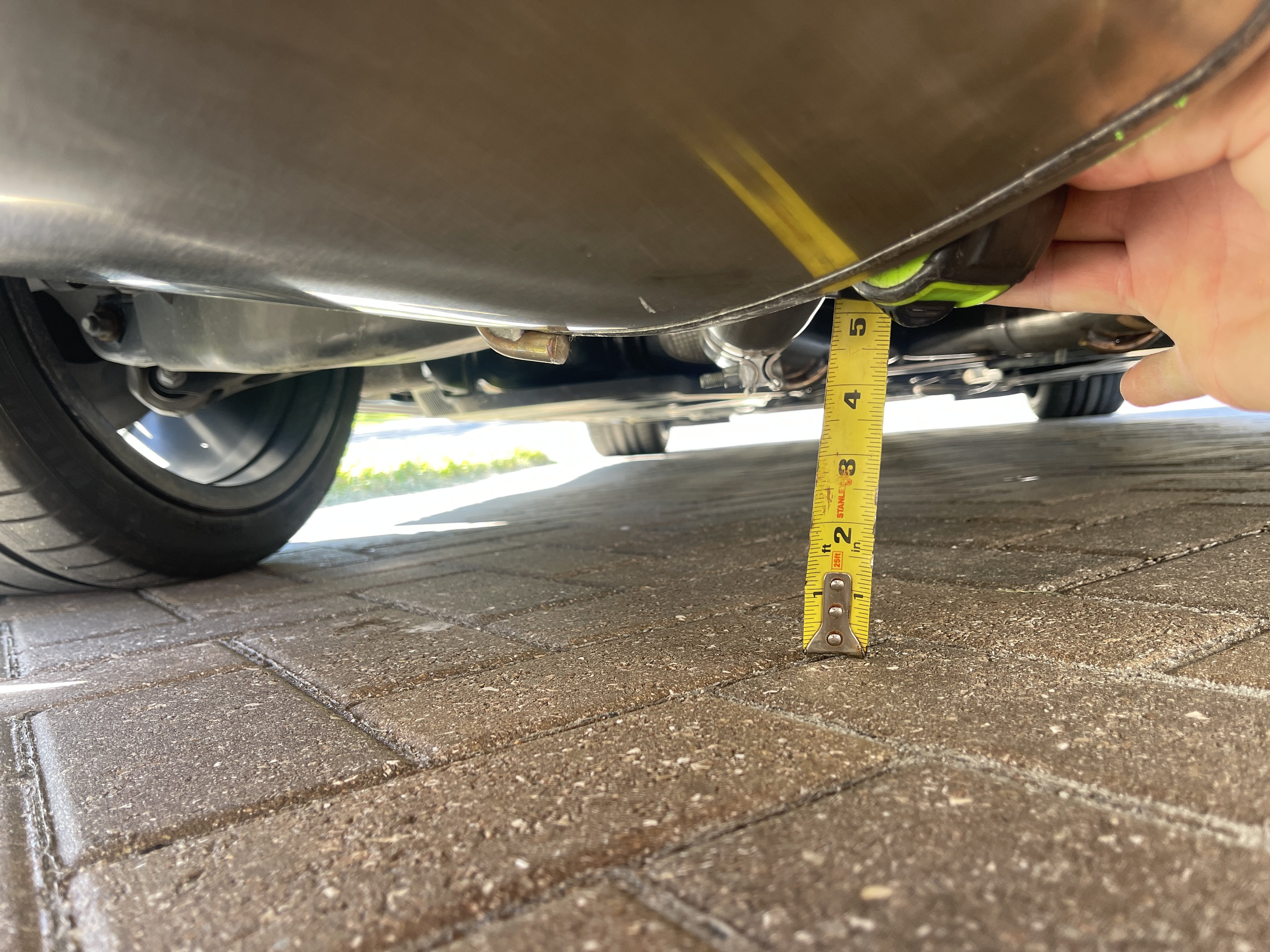

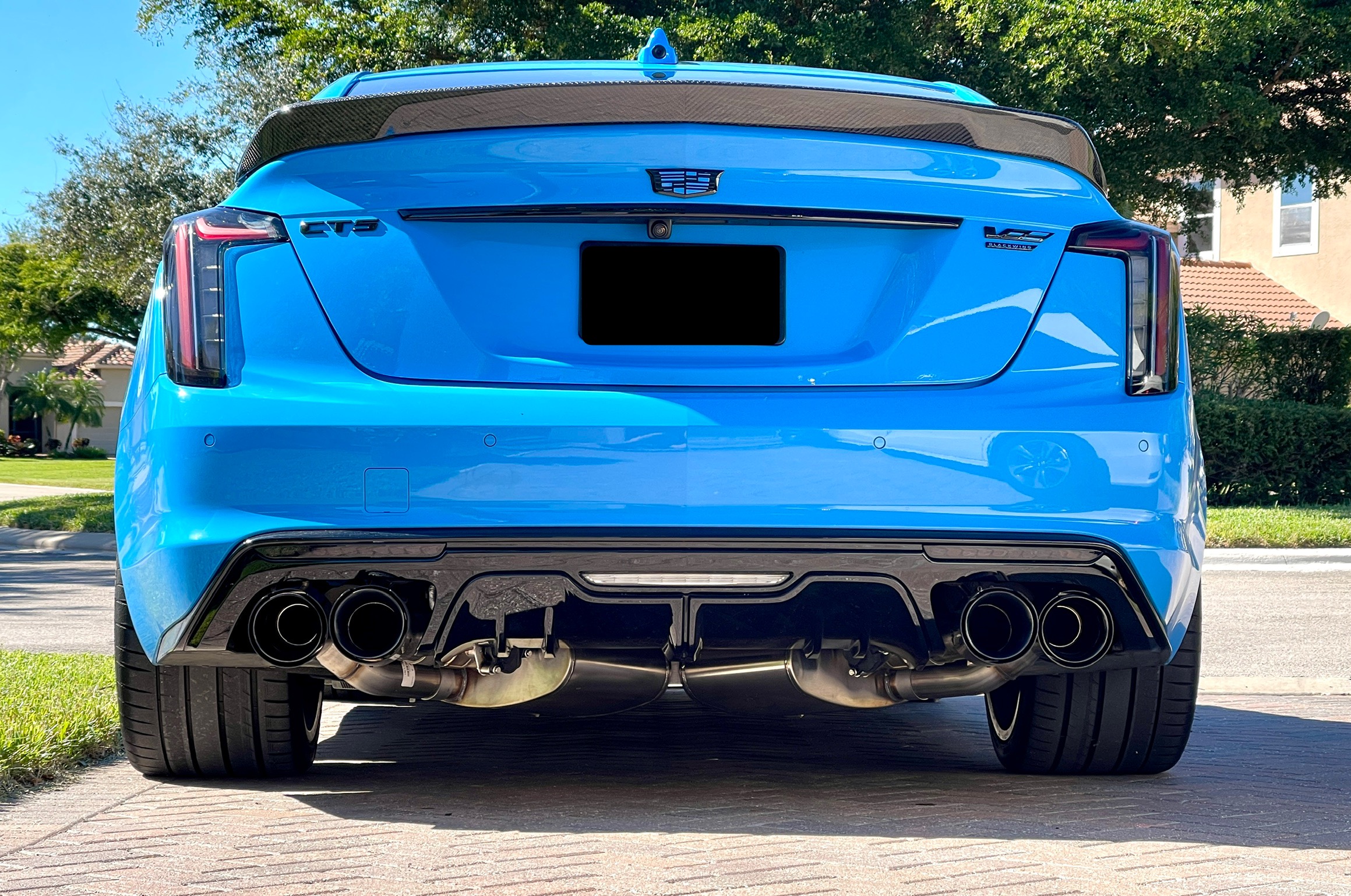

- Important Note: The mufflers hang lower then stock, no matter how high I attempted to secure them. I was reminded of this today when backing into a parking spot and hear the o'so dreadful scrapping of the muffler onto the cement parking block.. Pro tip, when backing in, stop before the block passes the bumper line in the camera... Now I have a nice dent/scraps on the inside left and right mufflers. (f me)
I have zero regrets. I still need to adjust the tips in a bit and get them aligned better but I'm smoked from the install. This exhaust is night and day different then the stock. No exaggeration.

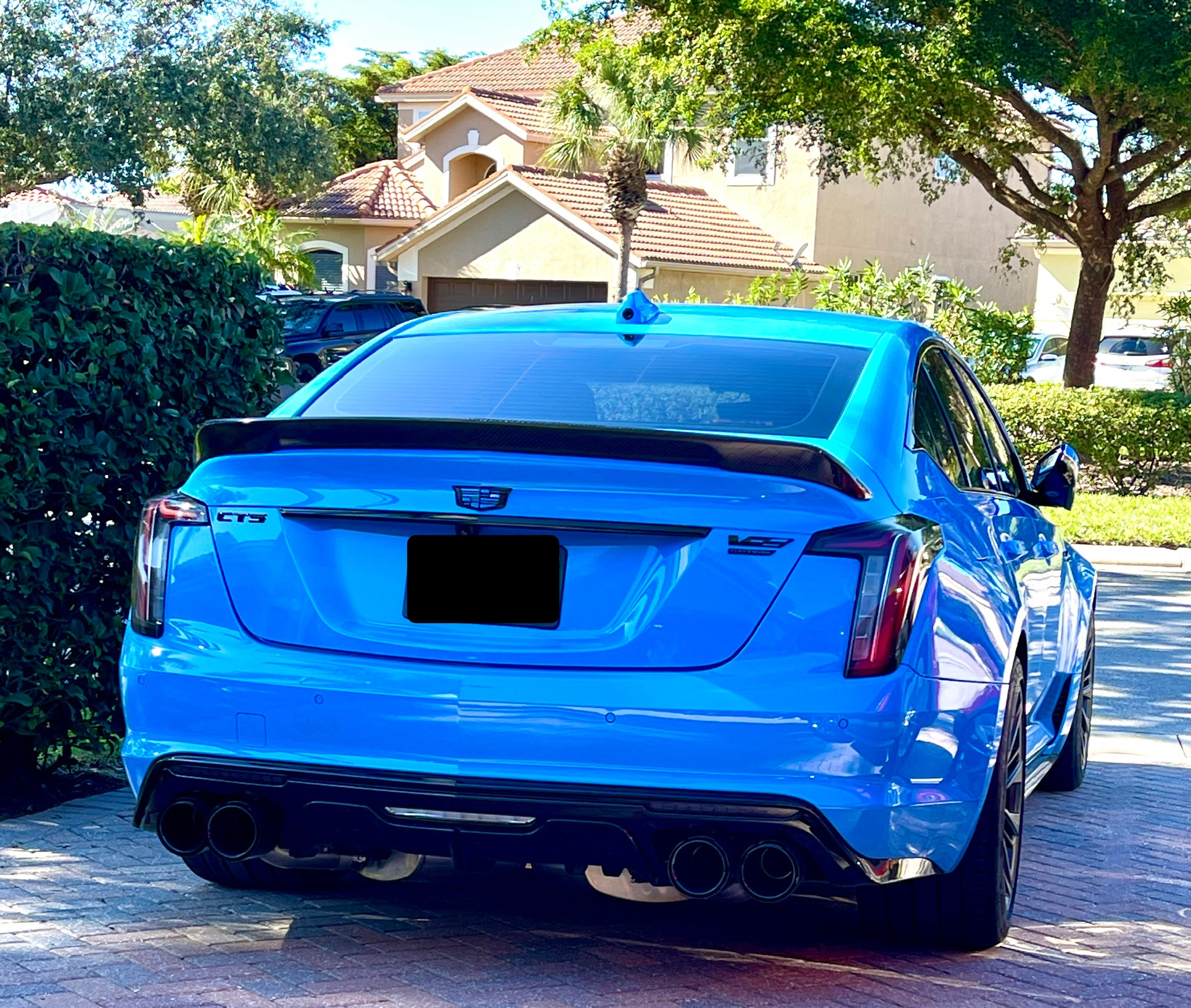

Looks wise, from behind, the two mufflers, hanging at an angle, give me those JDM vibes. I don’t mind the look. I just wasn’t anticipating how low they’d be. Perhaps they can be adjusted higher but they hang from rear axle hangers so you can only move them so much vertically.
Meh.. is what it is, they sound bat shit crazy, so winning.
Maybe do like the BMW guys and paint them flat black (high temp of course)? Maybe they just need some adjustment? Do you even see them just normal, walking around the car?
Doesn't look bad from other pics I have seen:
Really depends on the angle in which you look at it. From the angle of the Corsa shots, the mufflers aren’t as present. I measured the can to ground height and I’m about 5” at lowest. I’m going to try and adjust more but we’ll see.

Wow that does seem low 🤔
Definitely flat black spray paint to hide them
