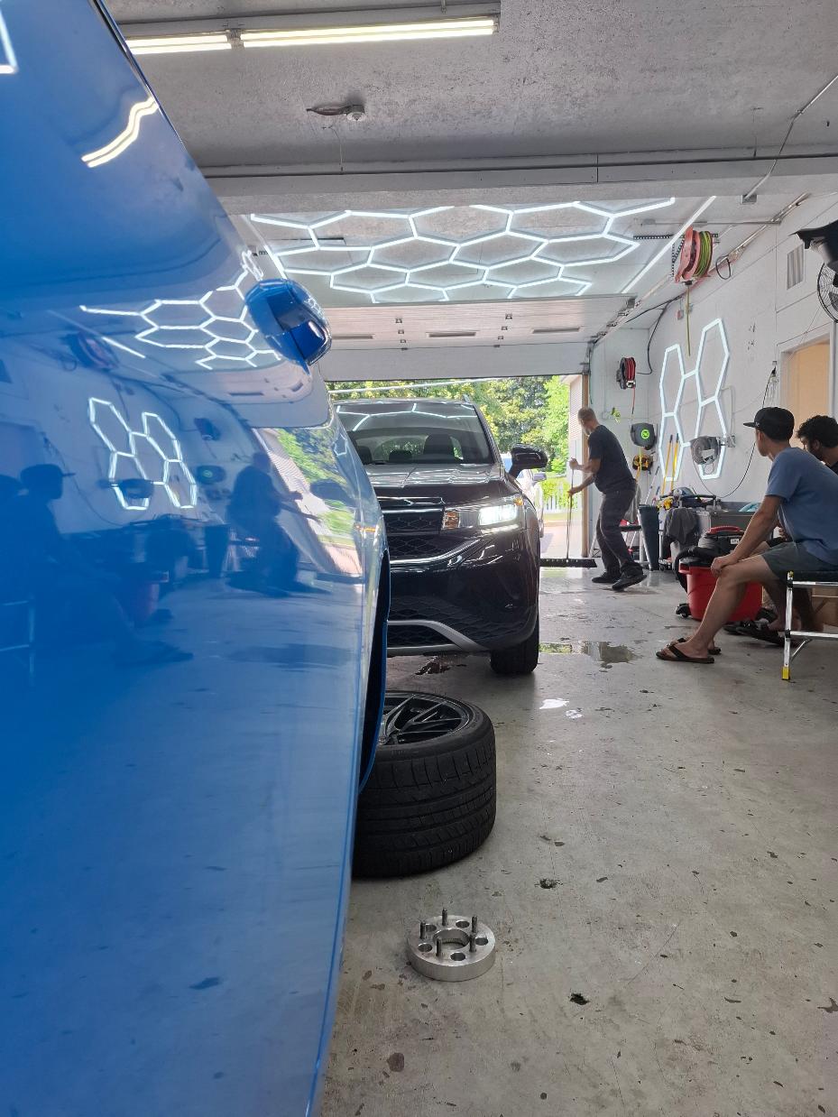

So, what has been done here?
functional vent? I thought they were just aesthetic.
Where are the detectives that start listing the types of ants found in a picture. It's subtle, but it's there to be seen?
Again, what has been done?
Remember, the game wouldn't be fun if it was too easy.
Where the the detectives that start listing the types of ants found in a picture. It's subtle, but it's there to be seen?
Remember, the game wouldn't be fun if it was too easy.View attachment 35490
Rolled your fenders?
Ding Ding!! We have a winner!
Yes, rolled the fronts and pulled all 4!
Now I should be able to get the 315/30's in the front. Still not sure if it will be an 11" or 11.5" wheel.
There are endless videos on-line showing it being done. First you heat the paint to make it more malleable to prevent it from cracking while being worked. It's so subtle, if you didn't know it was done, you wouldn't even notice it. But I gained about 1/4" inside the well.
ZL1 Addons splash guard?
The rears doesnt have a lip so it makes it easy to give it a slight pull. The fronts, the lip is already kinda rolled, easy to flatten it but also very easy to warp/bacon it since its so thin when you pull it.
