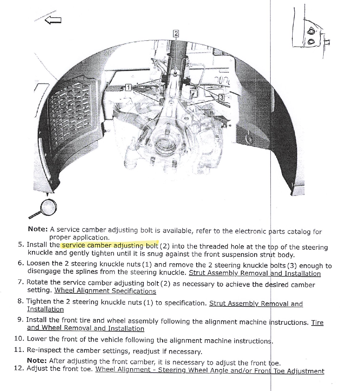

i told my selling dealer when they prep the car for delivery to align it to track spec and they mentioned needing to order different bolts to do so
Yep, they told me that too and were only able to get 1.6 without them. Do you know what bolt it was?
This is what the dealer provided me and they were like, we have no idea about this bolt
You don’t need that service bolt. Just loosen the bolt on the strut and slam them all the way in. It ends up right at 2.5. Set toe and you’re good in the front.
The FSM does say the eccentric bolts in the rear are single use but there was a later update that said just the nuts were. I didn’t replace mine.

The adjustment bolt is a separate tool you can use to adjust how far out the strut is - it’s basically acting as a stop until you put the main bolts back in and tighten.
