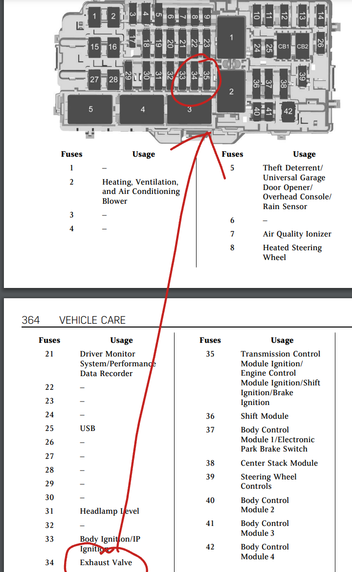

It's a fuse pull.
It sets a code, but does not trigger the Check Engine light.
Dustin is correct, even in Track mode, the valves are only fully open in certain conditions.
Pull the fuse and it's open all the time.

Is the fuse labeled as ?
