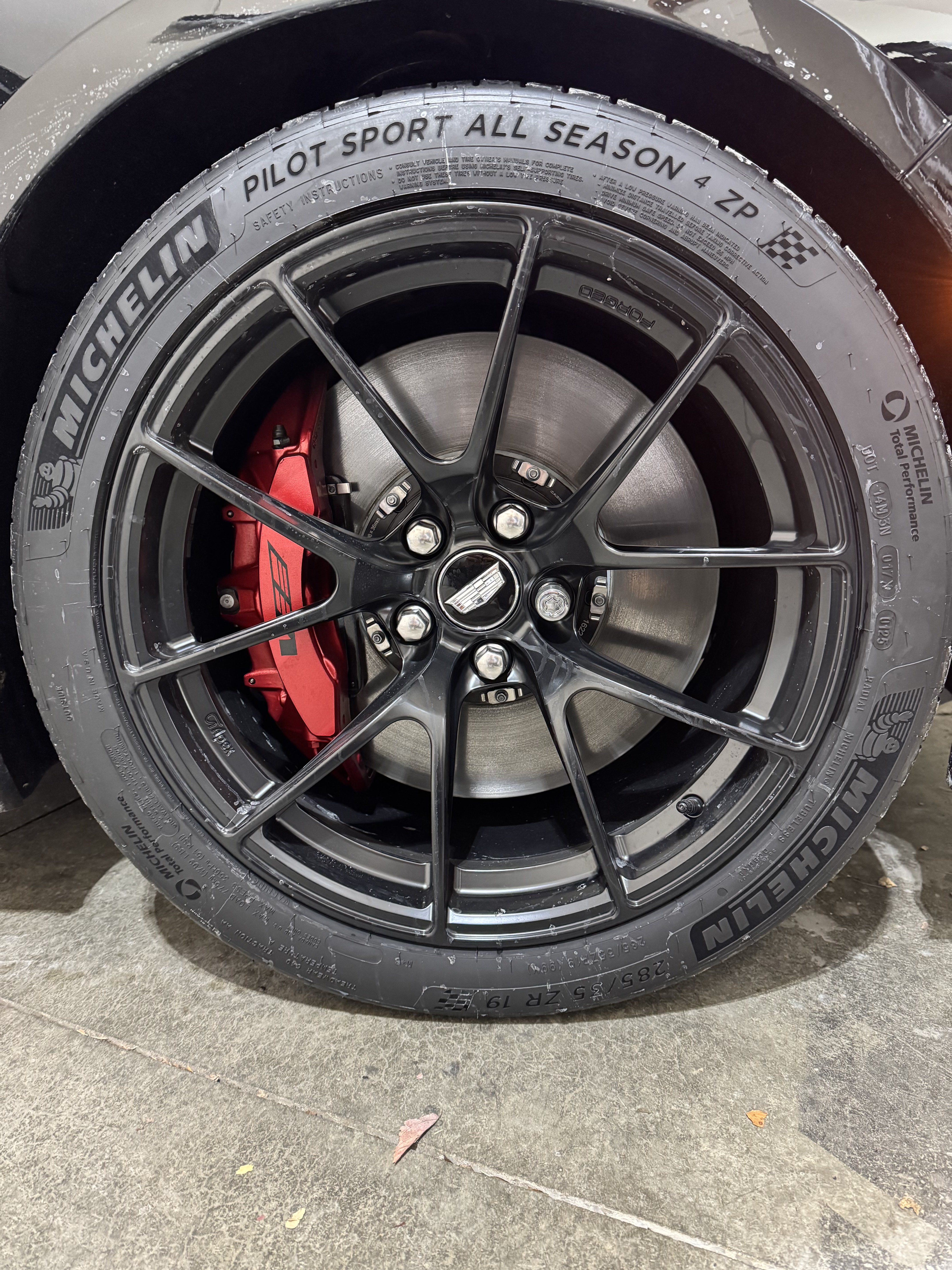

Apex wheels
VS-5RS 19x10” ET20 5x120/67.1mm
VS-5RS 19x11.5” ET48 5x120/67.1mm
Running Michelin Pilot Sport All Season 4 ZP
285/35/19
325/30/19

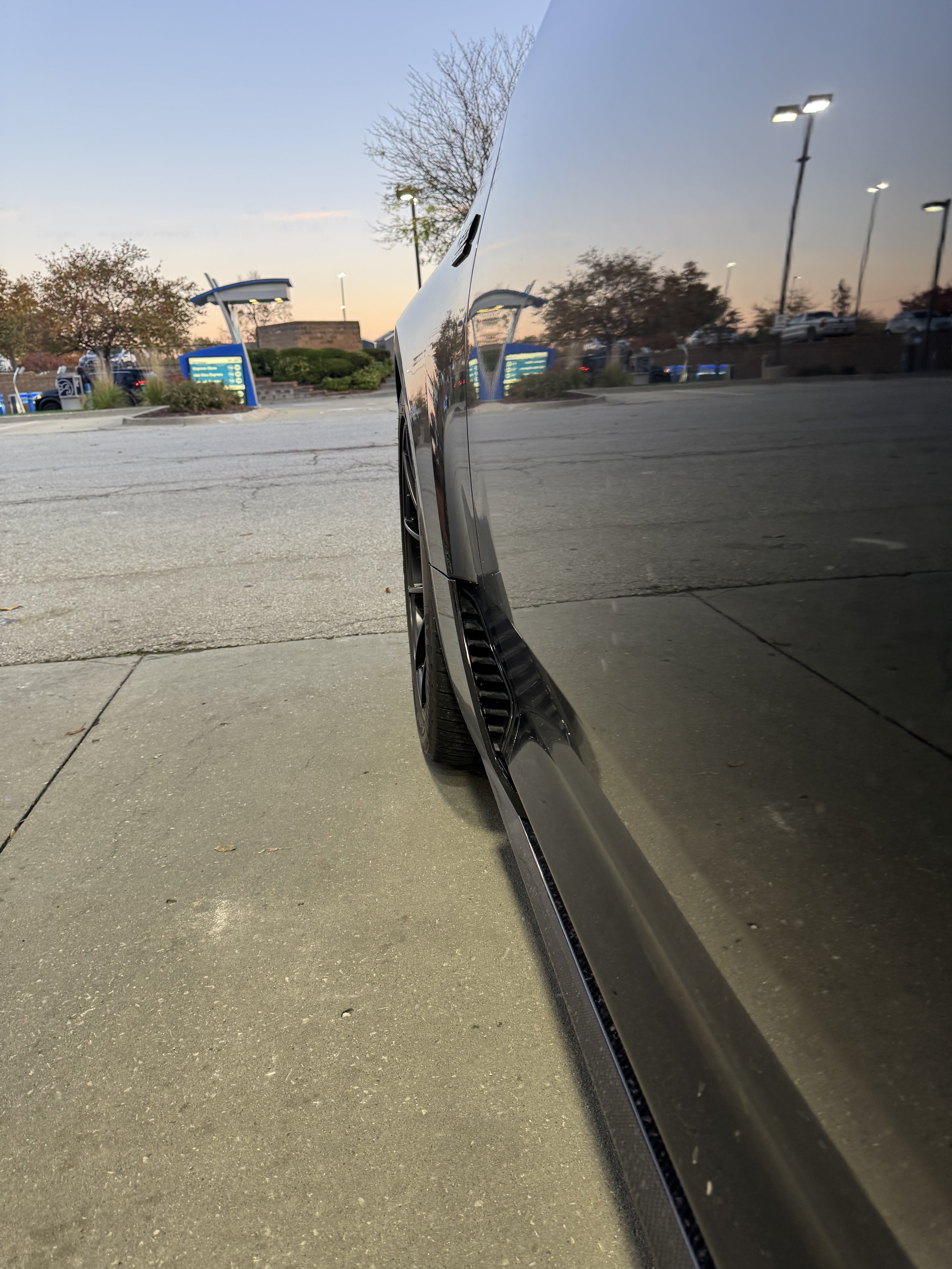

Went with neutral alignment. Ran this setup for 3k miles early this year on a 2025 ct5v blackwing without any issues or rubbing. Great traction through light snow and cold temperatures. This setup functions as my winter setup and then I go back to stock setup for summer months.
Very nice. The "no rubbing" part was what I wanted to hear.
How much different are the centerlines compared to the stock wheels, if at all?
Does Apex have these off the shelf, or did you spec them yourself?
They were off the shelf and hub centric which was important to me as I didn’t want to deal with additional rings or spacers. I’m not sure about the true centerline difference between the two setups.

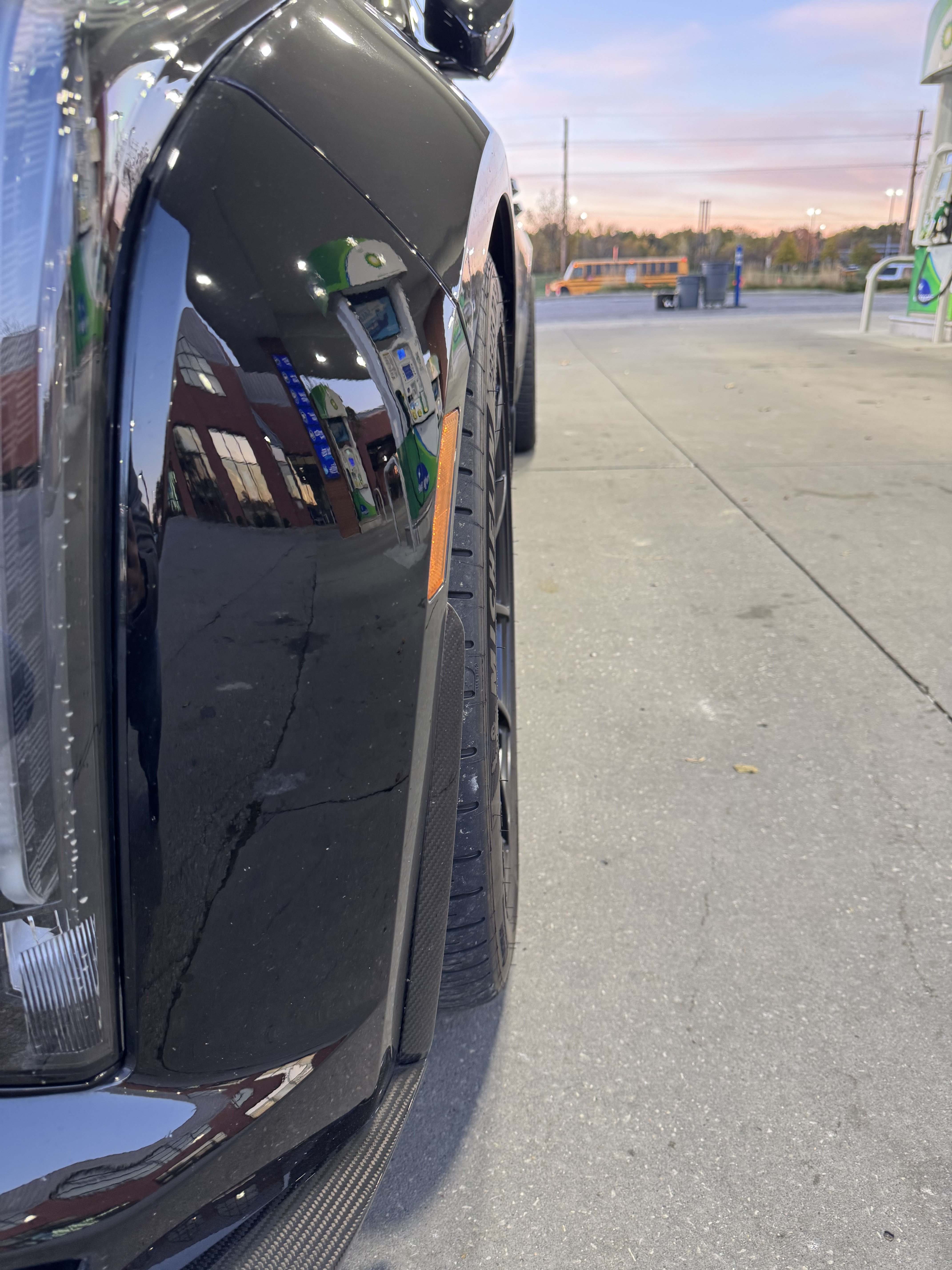

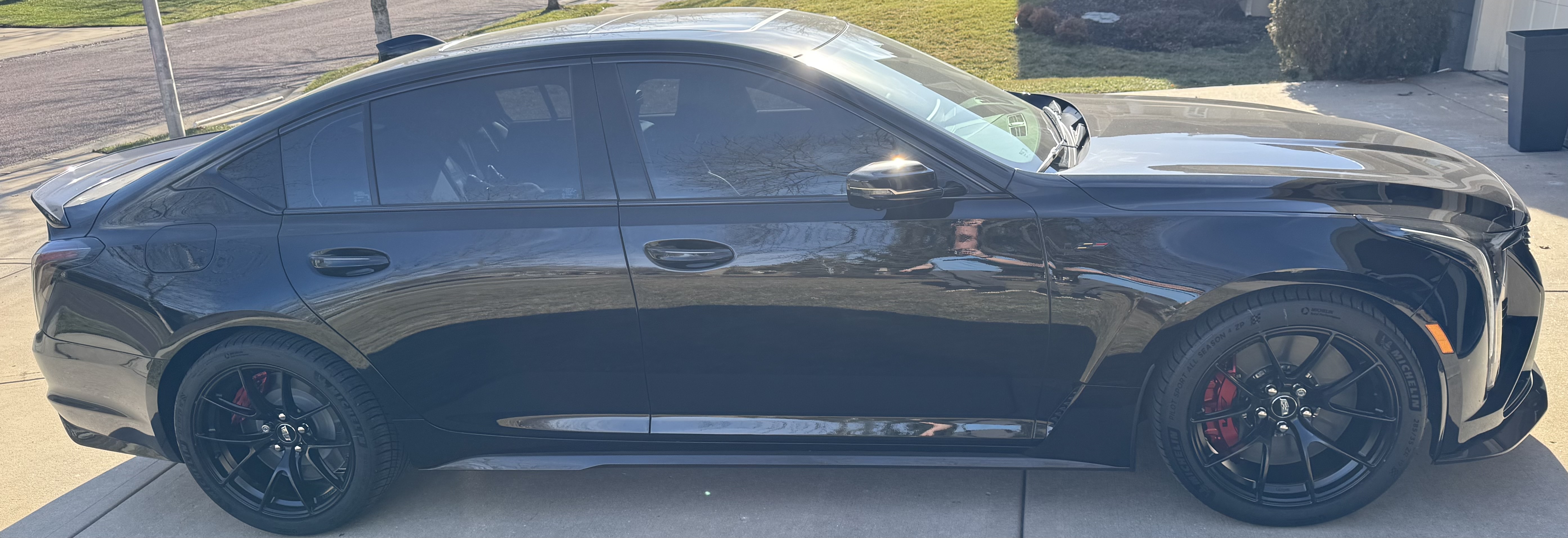

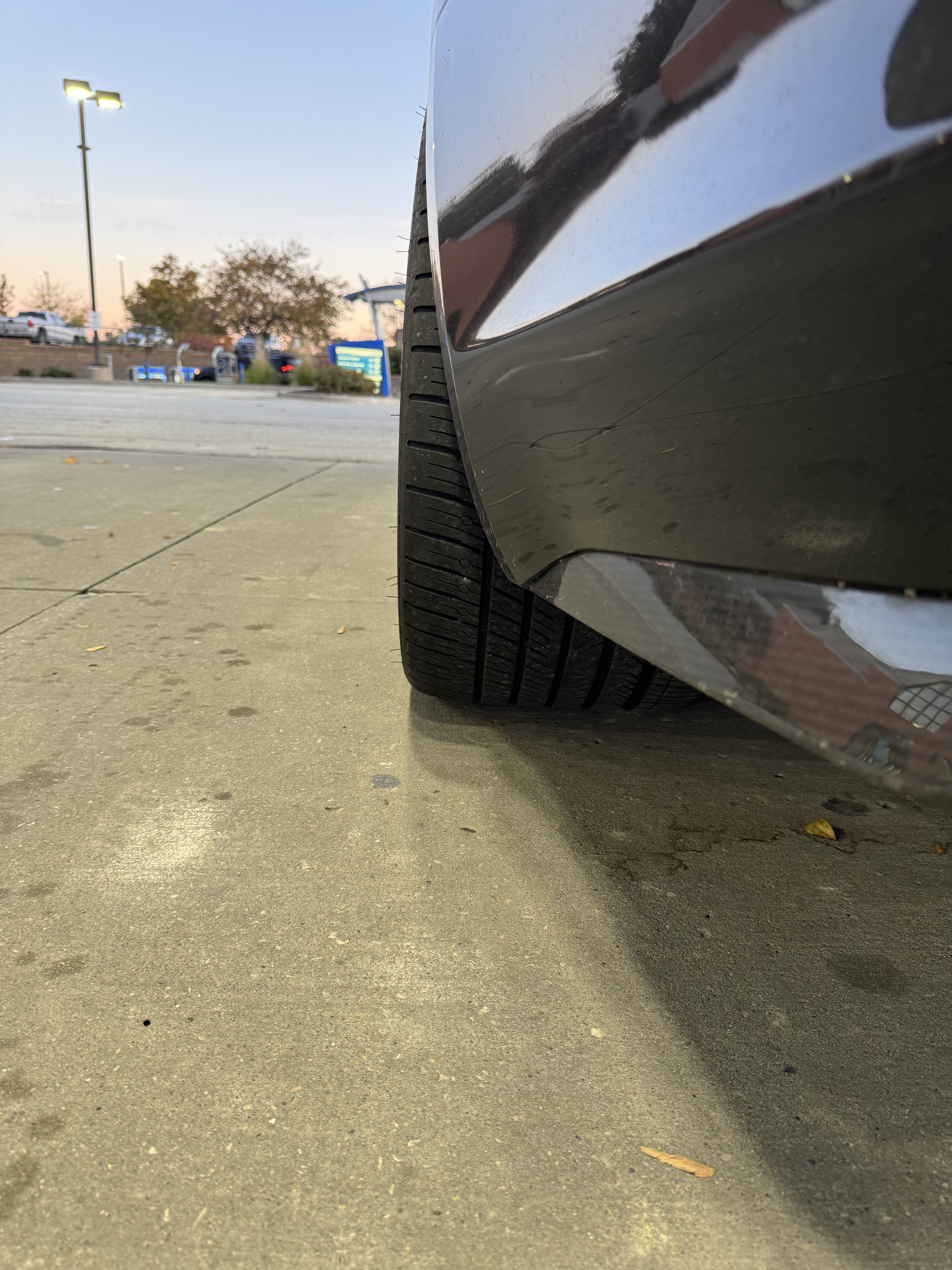

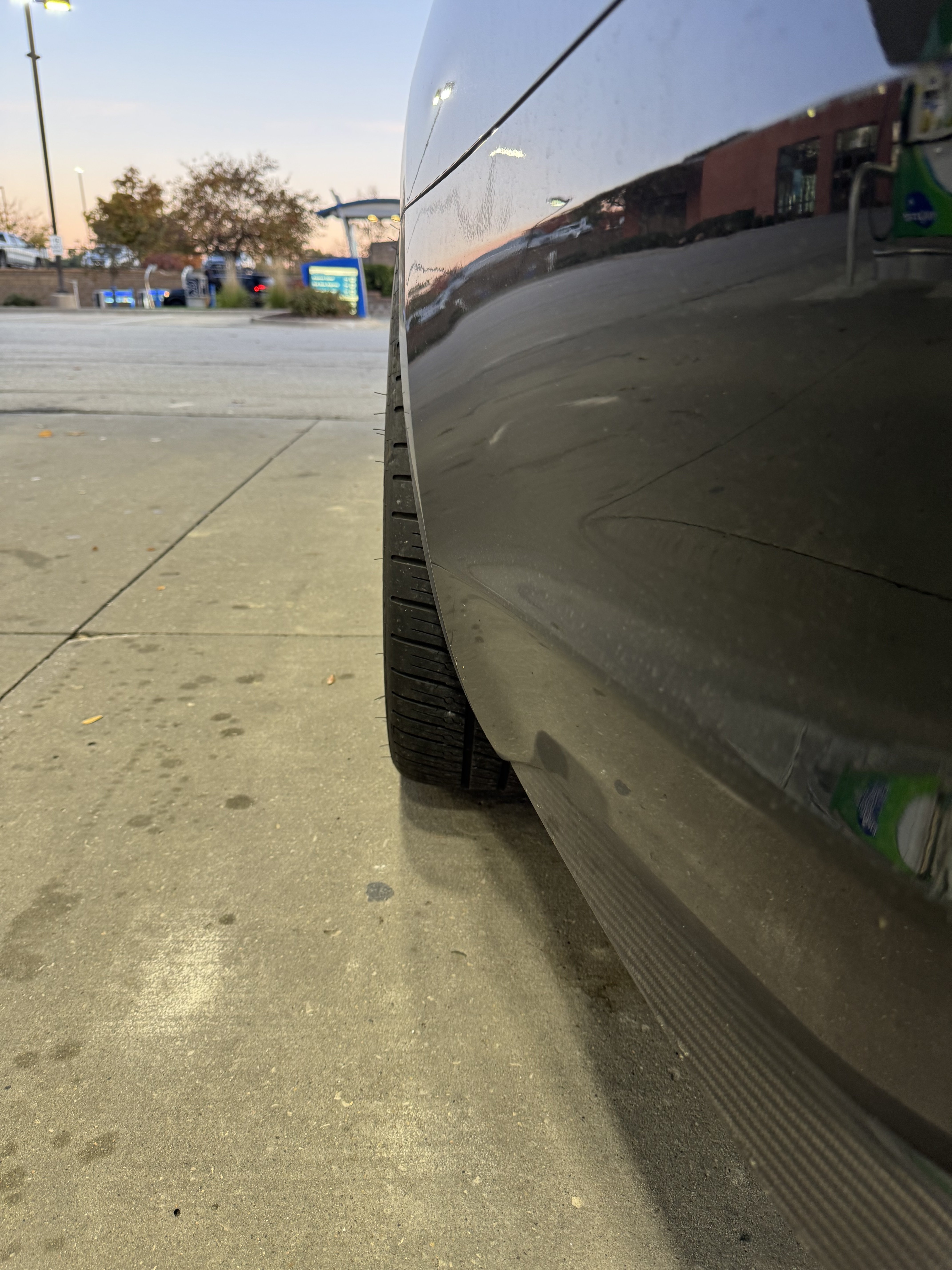

Thanks. If you happen to have/get any more pics from the side (showing how far they stick out or fill the tub) or rear (from down low), I'd really appreciate it. Thanks again.
Here’s some pictures. Sorry for the delay but had to wait to get the winter setup back on the car. Left some positive camber this year compared to neutral setup last year and still no rubbing.

Apex wheels
285/35/19
325/30/19

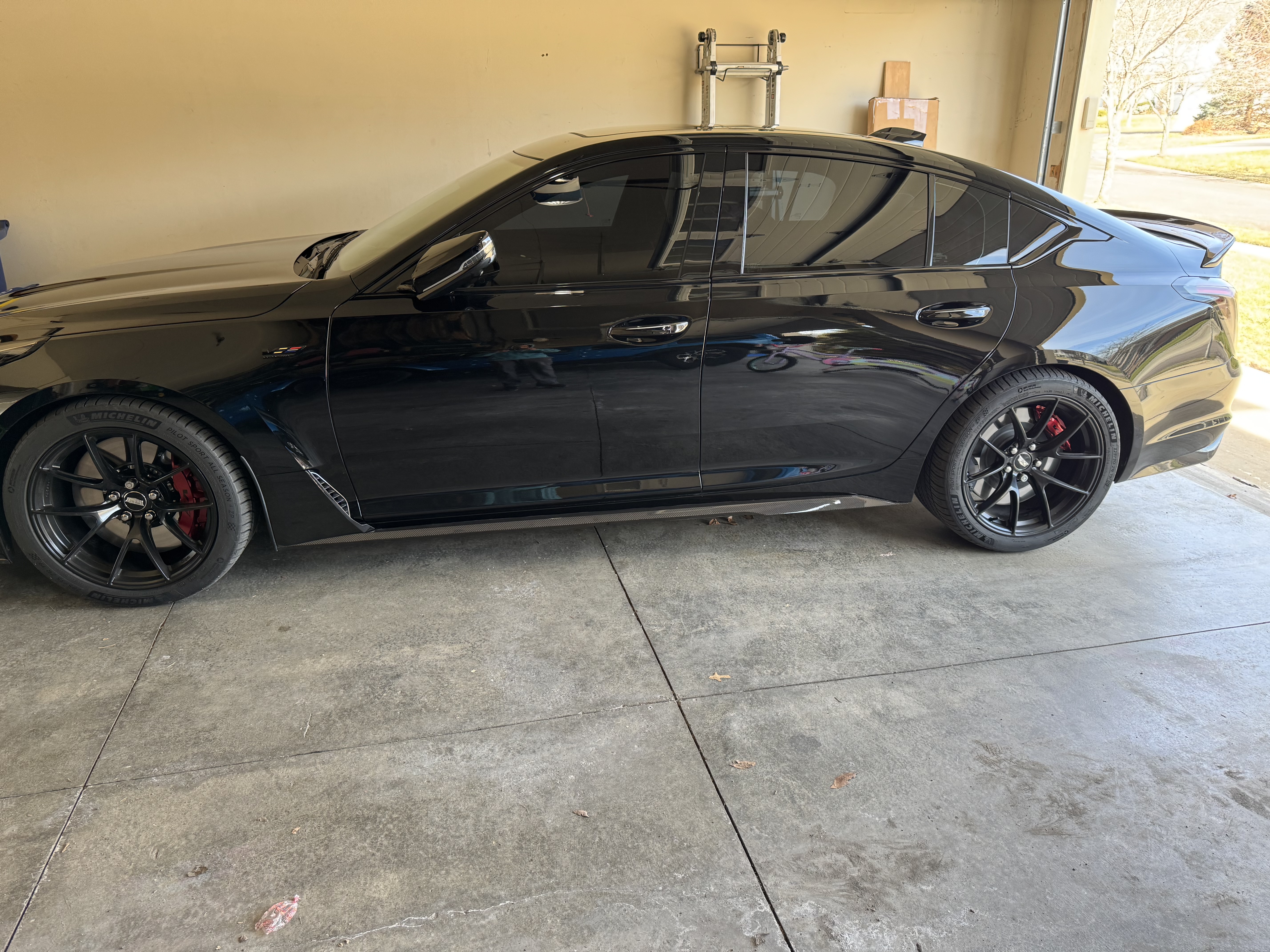

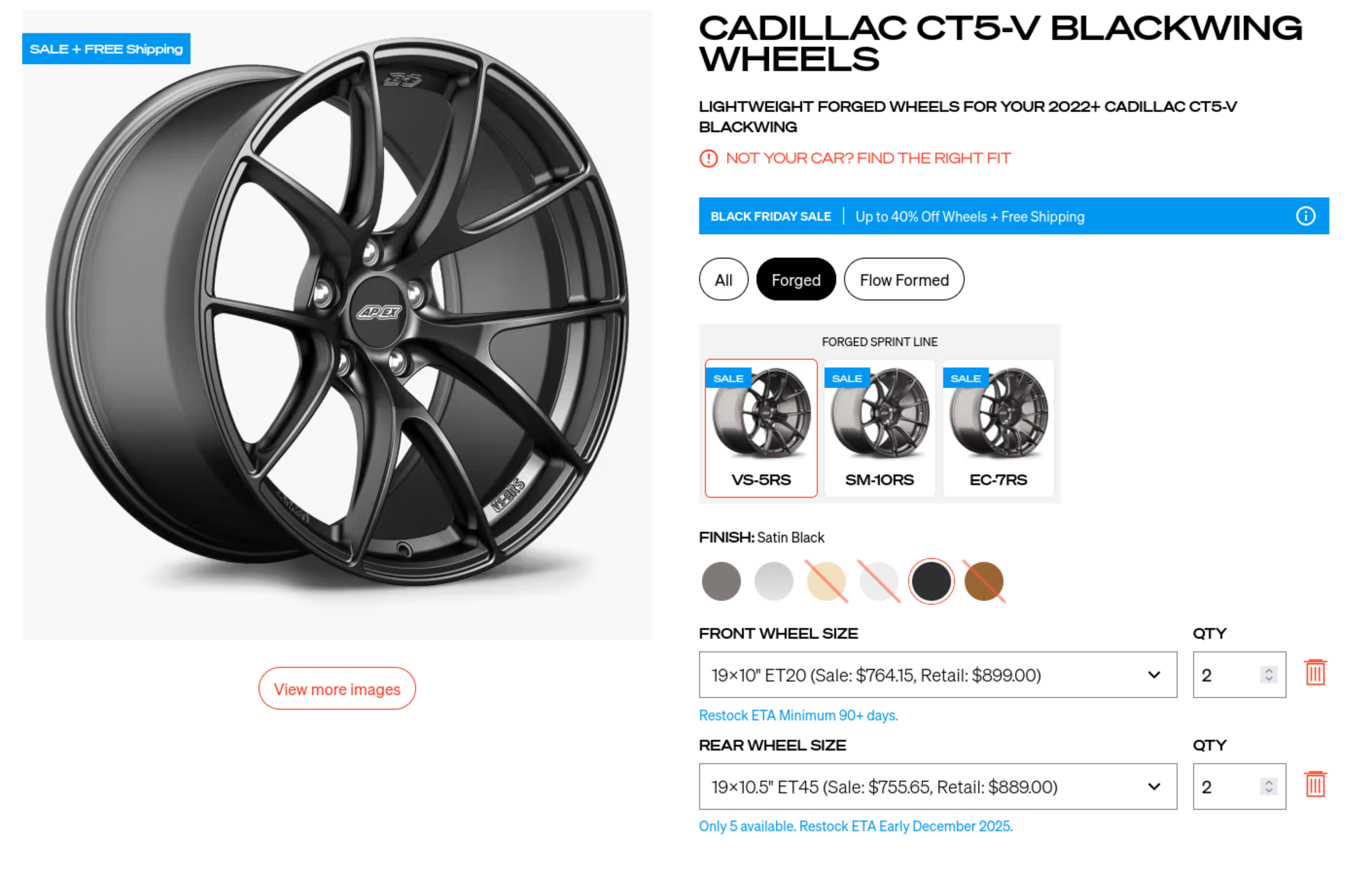

Pulled the trigger on my winter tire setup (Apex Black Friday sale ftw):
Apex wheels
VS-5RS 19x11” ET44 5x120/67.1mm (previously spec'd the 19x10.5 and Apex had a mistake on their fitment guide - IF you have Ceramic brakes the 10.5 in the rear requires a 16mm spacer for clearance so the rears got traded for 19x11 fitment which requires no spacers even with Ceramic brakes)

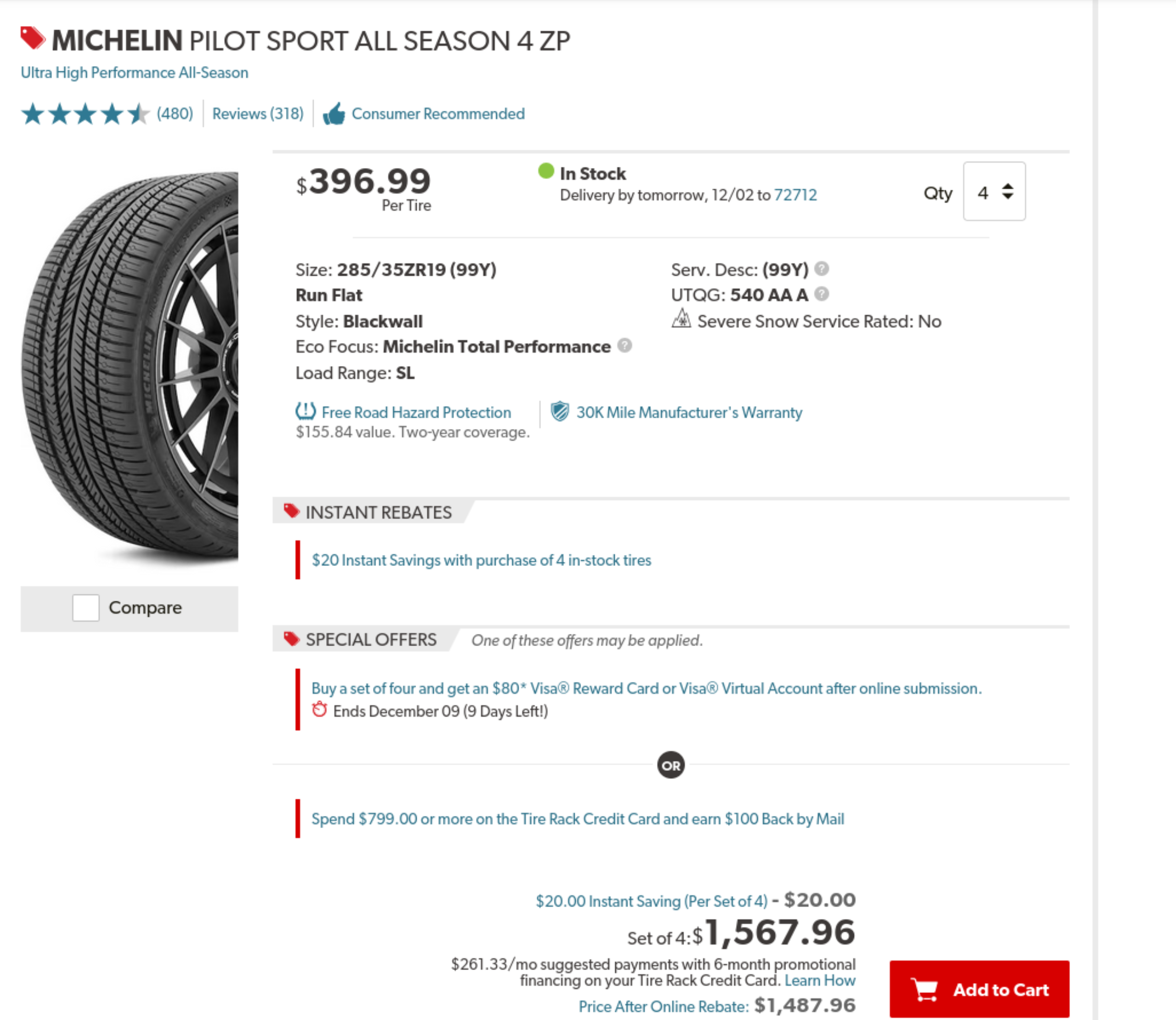

Square setup of 275/35/19 front and back so I only have one size of tire to deal with (and narrower tire in snow/ice seems like a good idea). Will report back once I get them and have them mounted/balanced.
