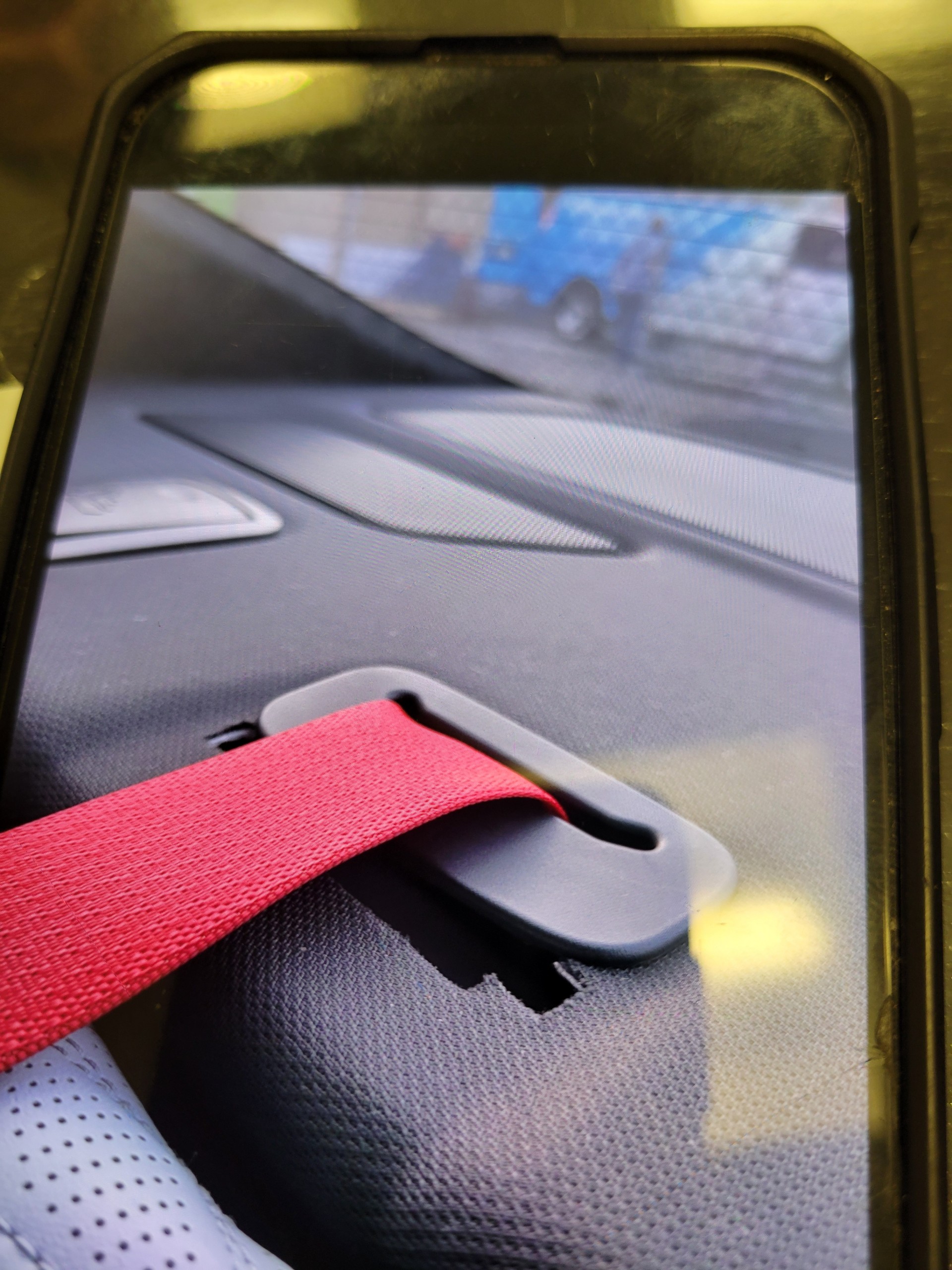

I’m having the dealership install these belts thanks to your leg work and helping them get the right part numbers. They told me they don’t have the right covers for the rear middle seat on top of the shelf, above the seats…is there a different part then the cover for the black belts? This is the photo they sent me…

But the cover on the package tray is incorrect as previously stated - have not installed yet but plan to slit the cover at the back from the black belt and use with the red belt. Has anyone else done this or other thoughts ?
This is what I did. Take your time and you can work the piece off the black belt.

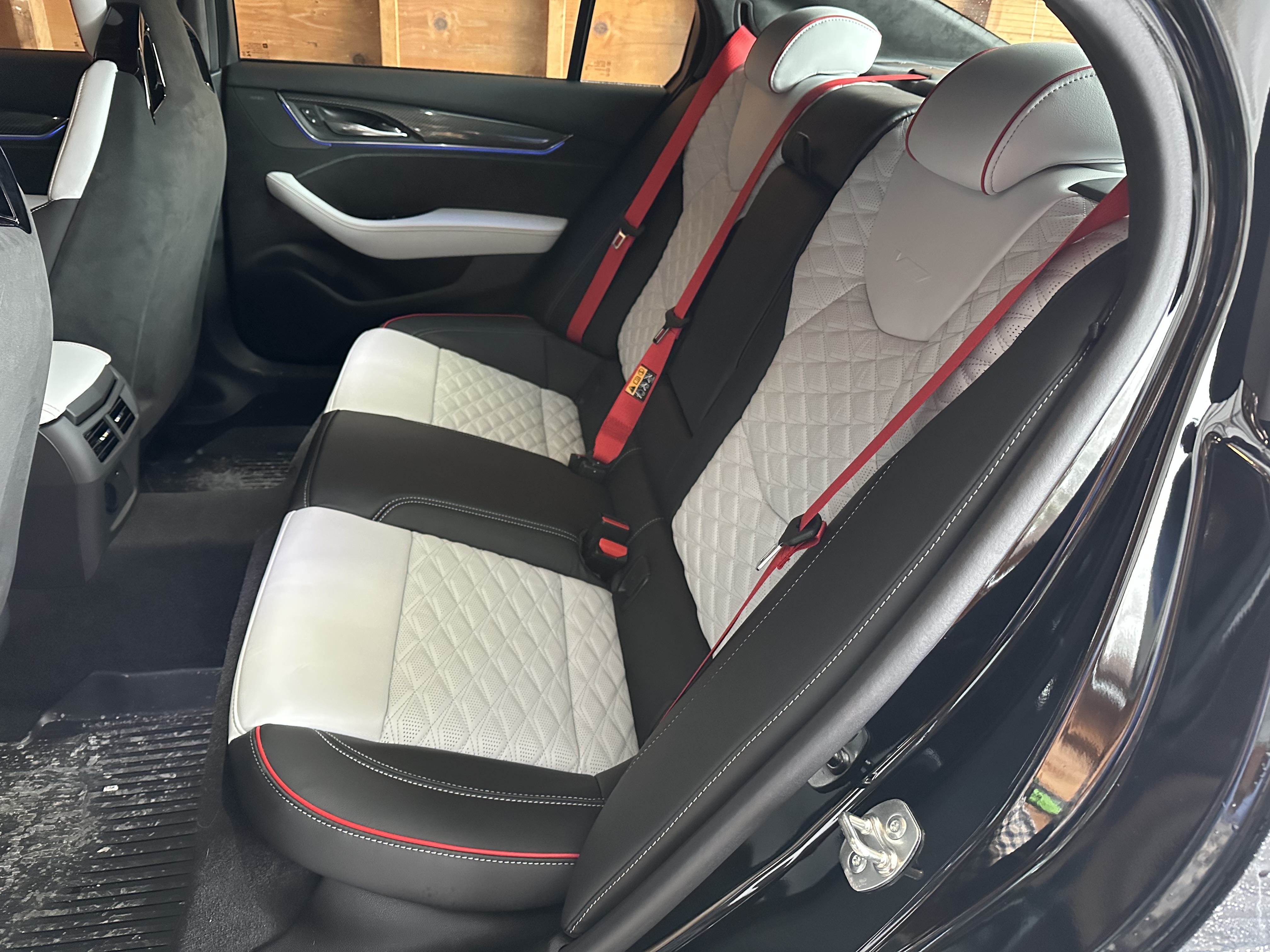

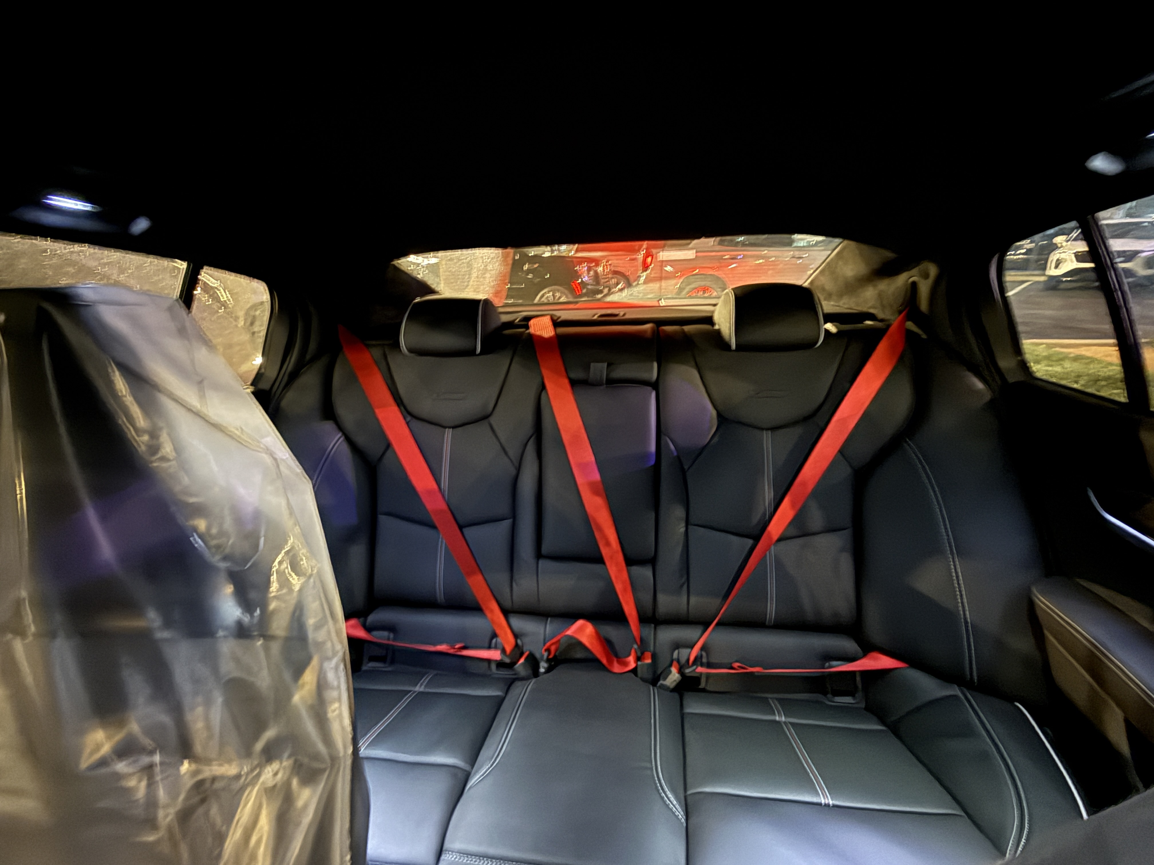

FYI - my 2025 'normal' Blackwing came from the factory with red center belt. Not sure if it's a glitch in the matrix or they responded to customer feedback. 🤷
Same here, mine are all red on my 25 5 BW. Guessing it was a mistake in the factory or they were running low on red belts and stuck black ones in the middle.
