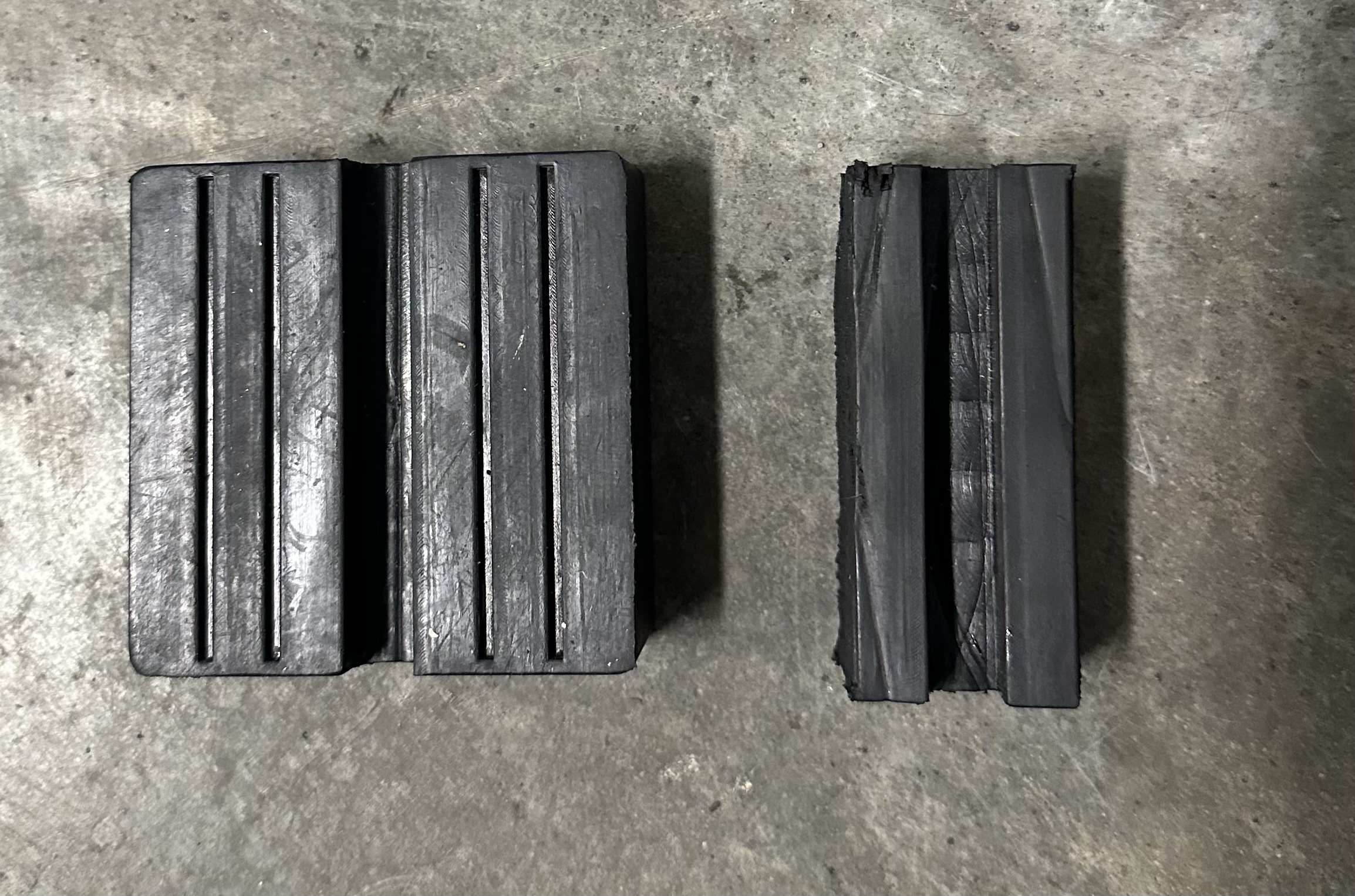

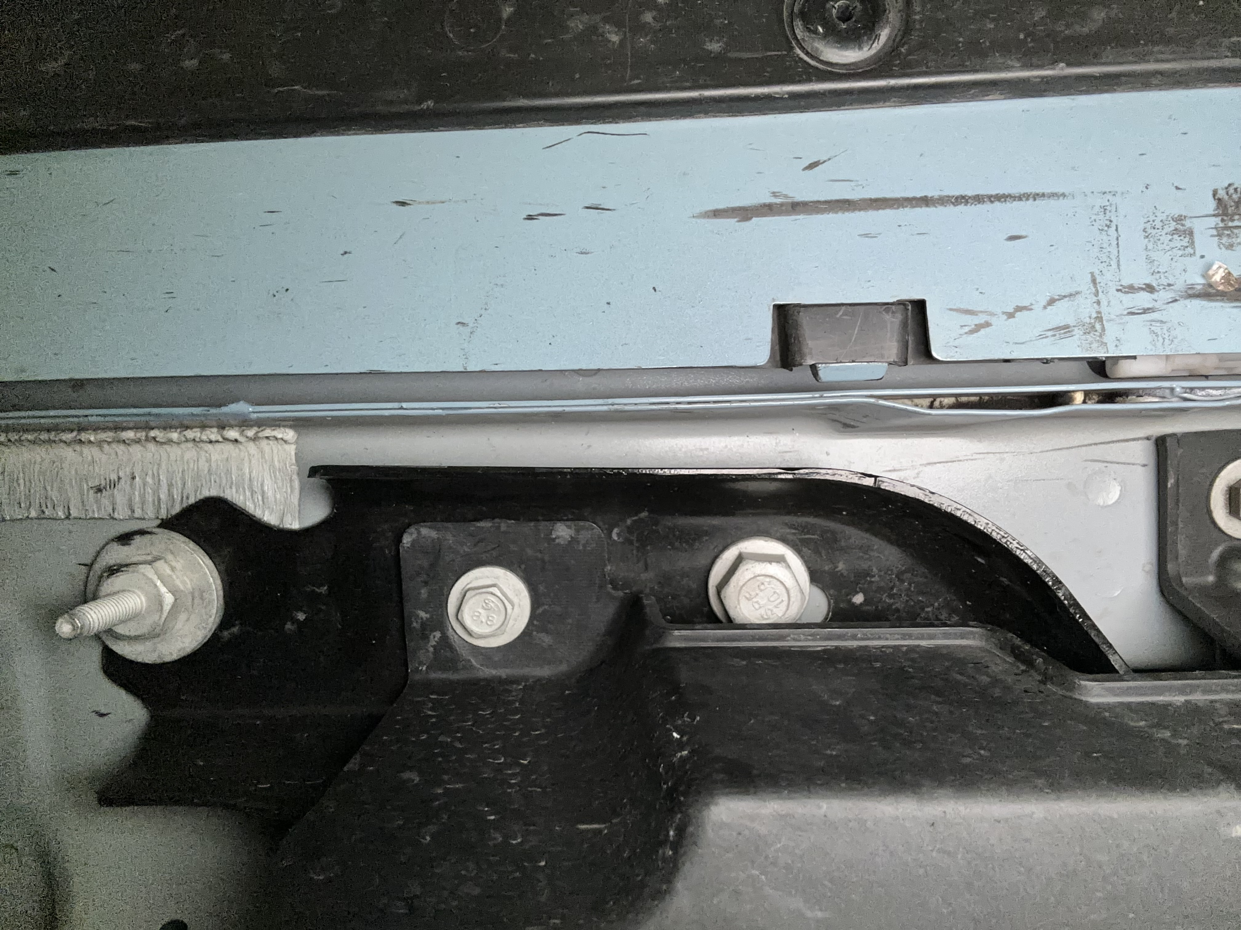

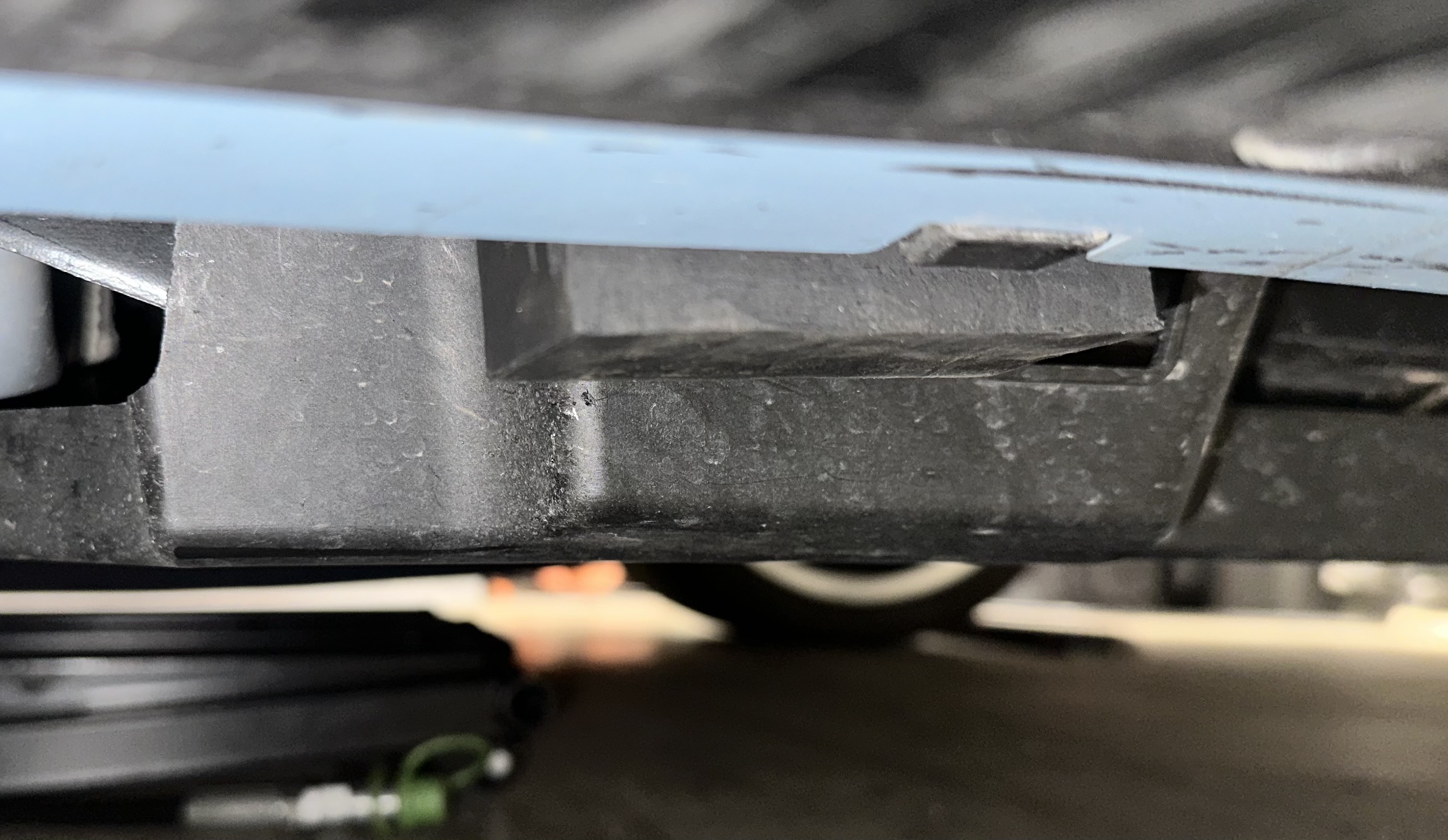

What lift point are you using for the rear? Just curious as an alternative.
I cut down a large square puck (see right side of first pic). That was necessary as the space I am using for the lift location is tight (see second and third pics). Last pic shows how it looks from the side. You will need to use the large QJ lift block and turn it 90 degrees so it will not contact the plastic pieces of the underbody. I will take a pick with the car jacked up next time I have it on the QJ.

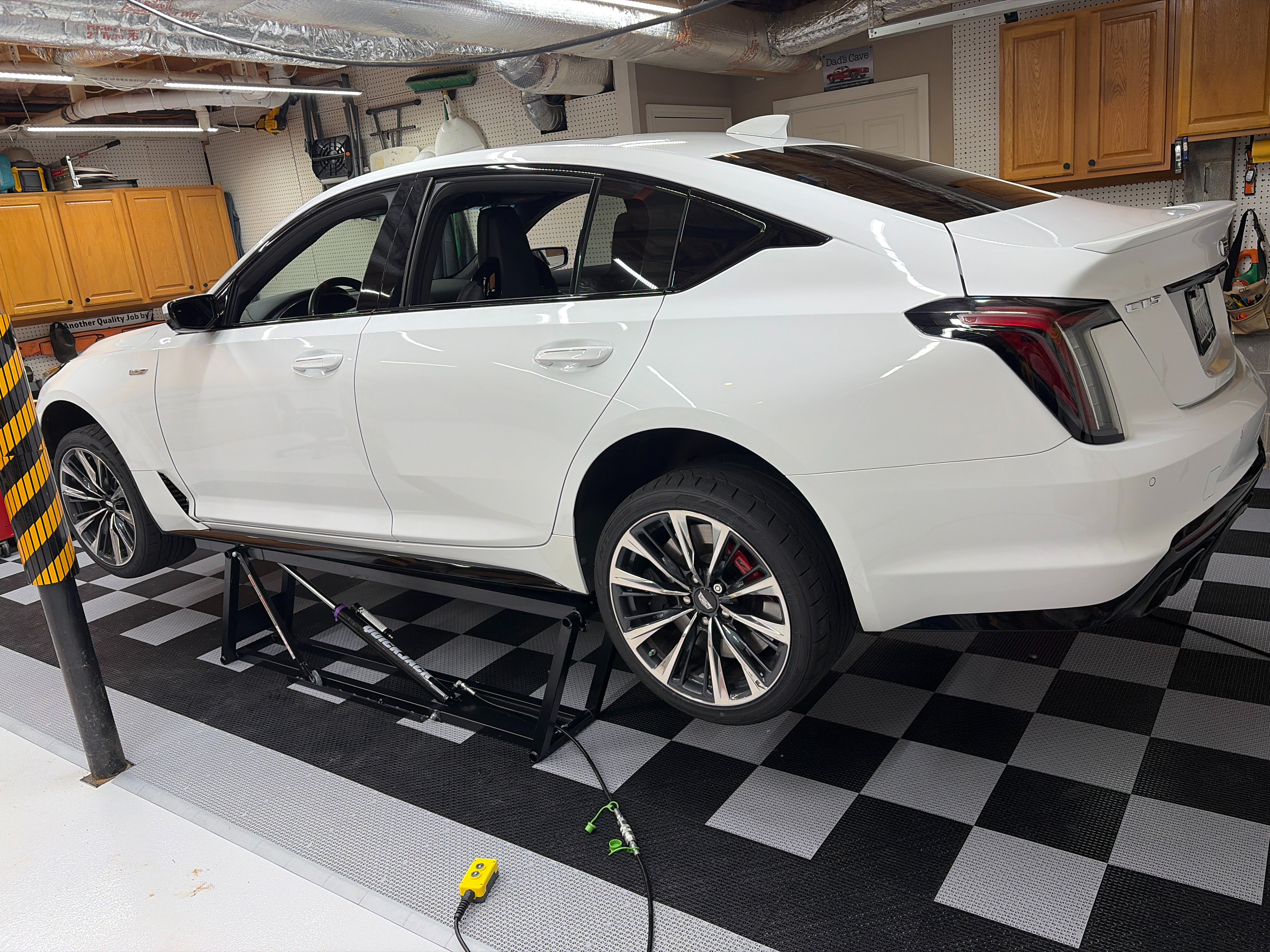

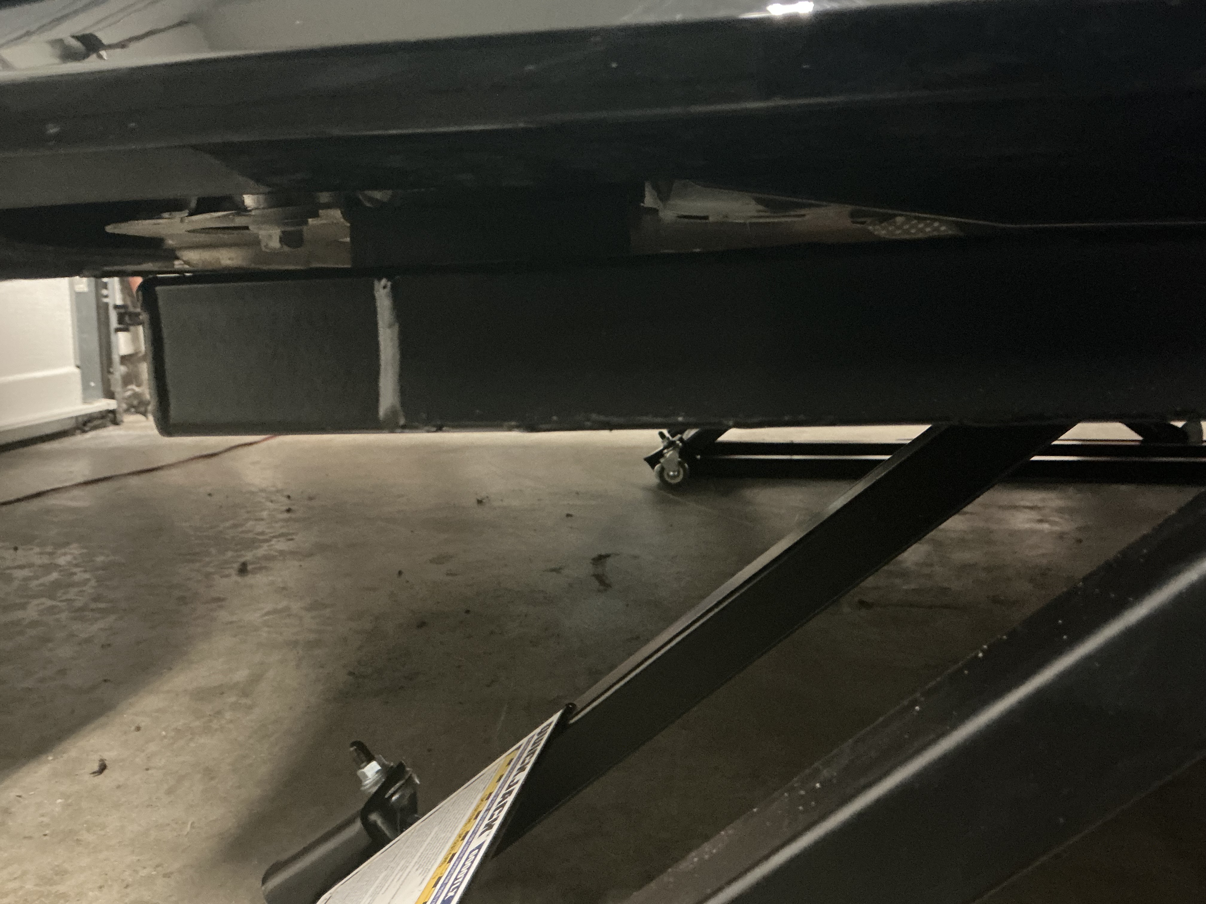

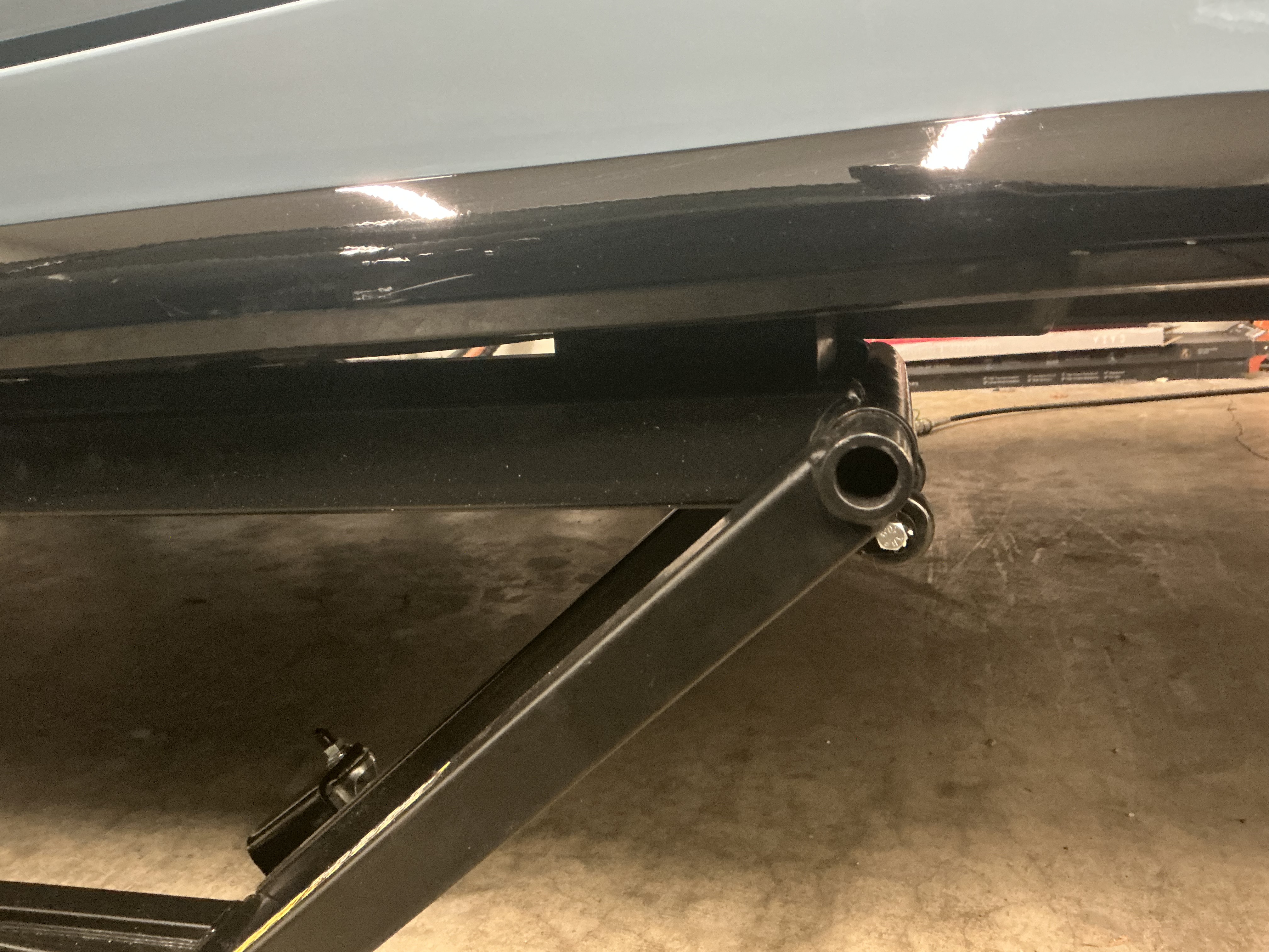

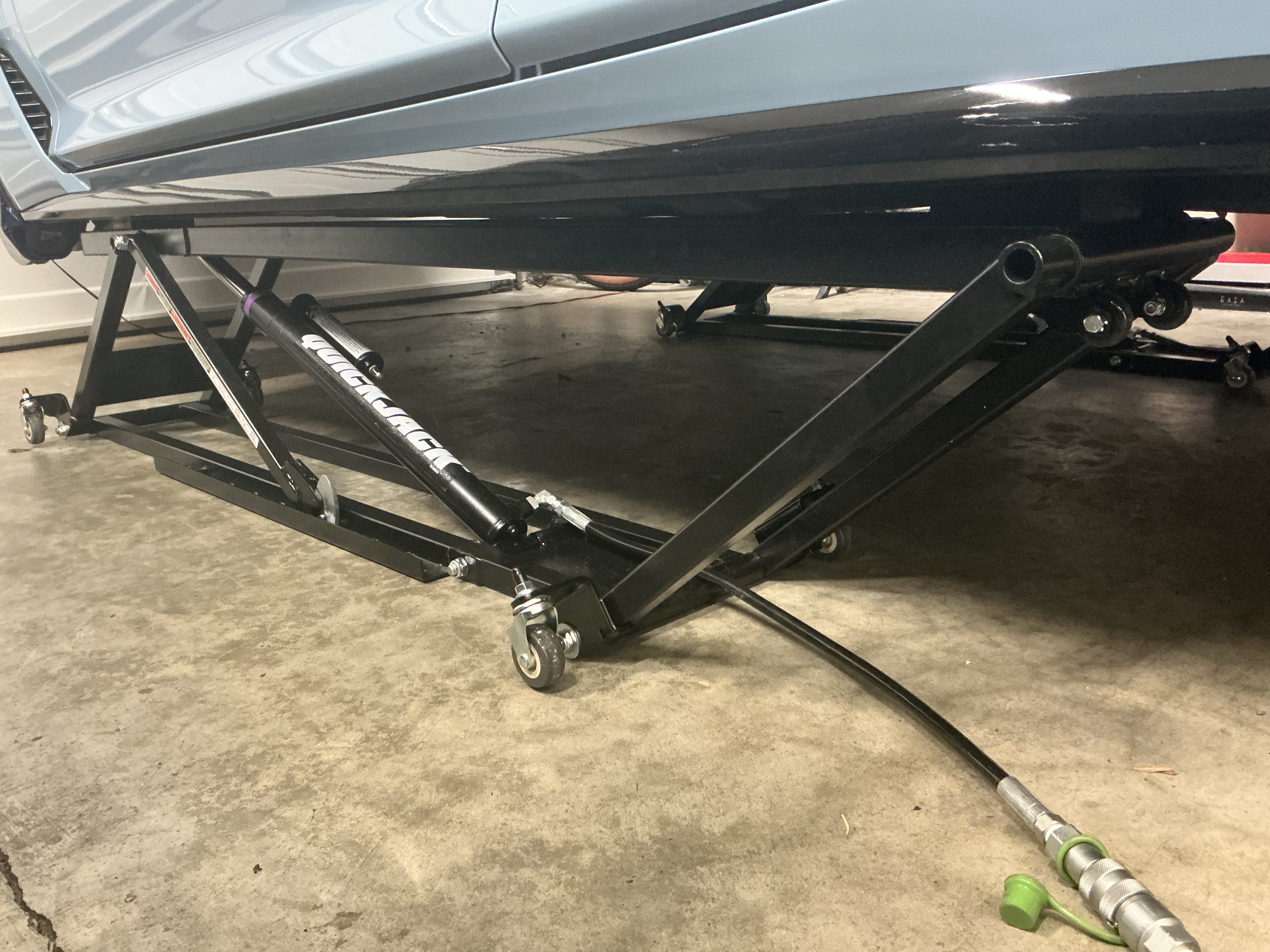

Glad I found your post as I have a similar situation. Do you have any pictures of your BW on h lift you can share?
I have the overkill system now from QJ. I got an 8000TL and now also have the extenders. I can lift my entire fleet — Mazda3, 4BW, Nissan Rogue, Chevy Colorado, and a suburban. All with the same lift. I keep them on the floor — I think the wall hangers is a ridiculous concept for something that weighs nearly 100 lbs each. Yes, put the ball bearing/roller thingies on them — makes moving them easier and can’t believe they don’t come that way to begin with.
You caught me at the exact right time time. I have the car up on the lift for oil change and brake pad and fluid service. Pic of the car on the lift and also close ups of front and rear jacking points.
